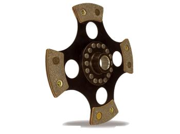

Wanna know how awsome this one is to drive around town?? lol. Rated at 512ft/lbs I think. However the syncros do love it. Shifts are much faster and more smooth into each gear!
How bad is it? I have a Fidanza lightweight flywheel, It wasn't an issue on the 225mm KA24 clutch but I'm sure it would be really difficult to get used to on the 512 WTQ ACT N013 and 6 Puck....
Don't get any clutch plate that does not have a sprung center if its a street driven car. Spoils the driving pleasure, fine for an all track car though.
Mine is street driven....
Debateable, just like a lighten flywheel. Plus every clutch that has failed before its time was the center springs "keepers" going and the springs going for freedom! (except one)

The main reason for the sprung center of the disk is transmission wear. Without dampening, metal slapping on metal wears quickly. Even if it's hardened.
