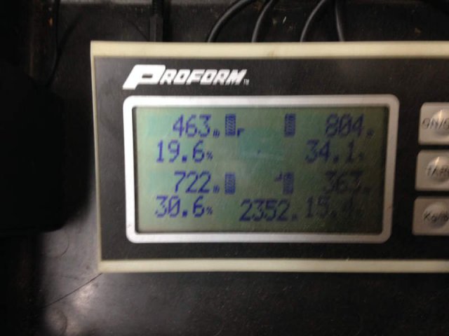

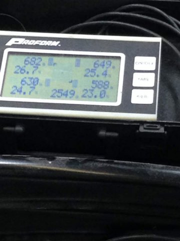

JMortensen Posted June 13, 2019 Author Share Posted June 13, 2019 There are SO MANY other things that could affect it, that I think your results (and mine) aren't really meaningful for other people. The thing about the Miatas is that they have a tendency to lock up the LF tire under braking. Not sure that I've heard anyone say that about their Z. FWIW I learned a new trick the other day: when corner weighting, set the front weights equal, rather than setting the diagonals even. This is supposed to load the front tires more evenly under braking. Between setting the fronts equal and making the lines equal length, you MIGHT be able to tell the difference. Probably not... To me these are things that you do when you're building because it's theoretically better. The actual difference it makes is probably pretty minute. Quote Link to comment Share on other sites More sharing options...

JMortensen Posted June 14, 2019 Author Share Posted June 14, 2019 11 hours ago, 260DET said: Have never bothered with corner weighting, something about it did not make sense in a vague sort of way. But what you have posted does make definite sense, same with the rear too even when accelerating. Say if when accelerating the L tyre has less grip due to track conditions and that side just happens to have an effective higher spring rate due to corner weighting. I think you're missing out here, regardless of whether you do it diagonally or setting fronts even. Mine was really far out. I'd be shocked if fixing this didn't help. Quote Link to comment Share on other sites More sharing options...
260DET Posted June 19, 2019 Share Posted June 19, 2019 On 6/15/2019 at 3:39 AM, JMortensen said: I think you're missing out here, regardless of whether you do it diagonally or setting fronts even. Mine was really far out. I'd be shocked if fixing this didn't help. Yeah, I've never noticed a problem that could be related to corner weighting but that could be me, getting the ride heights equal on each corner F to F and R to R is as far as I go Quote Link to comment Share on other sites More sharing options...

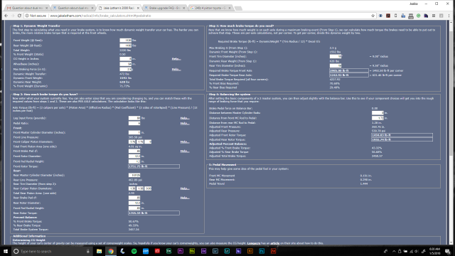

tube80z Posted July 4, 2019 Share Posted July 4, 2019 On 6/9/2019 at 6:55 AM, Jboogsthethug said: No worries, it makes sense in any other application that this wouldn't be a good idea to do. Interesting, you would think the pressure would be uniform throughout the plumbing regardless, but that is really good insight! I will probably have to run these lines for a bit and buy a new bit of brake line soon so I will keep a careful eye on that happening! Technically unequal lengths will cause the pressure on the calipers to be different for a short period of time. The amount of fluid that moves is very small. What mostly happens is a pressure wave that travels along the fluid. If you want to get all geeky it can be calculated but you need to know details of the fluid and temperature, etc. Think of it similar to how a sonic boom happens. I've had lines that started out not equal and it worked fine. I only ended up changing this so to equal length when I did work to make changing the engine/tranny easier. From previous posts it looks like you were asking about 50/50 on braking. If the question is how much braking should be on the front versus rear this needs to be more like 70% front and 30 percent rear. 50F/50R will cause premature rear lockup. Perhaps I'm not following along. One of the best ways to test I've found in Neil Robert's book Think Fast. He recommends finding a medium speed corner and setting the brake balance so that when you brake hard you stay on line. Too much front will cause you to understeer (car moves away from corner) and too much rear will cause you to oversteer (car tightens corner). You don't need to come to a stop when doing this and you only need medium effort on the pedal. A cloverleaf highway ramp would work if you can find one without a lot of traffic. I was fortunate in having a track with the perfect corner to do this. Keep in mind pedal feel is subjective. This can lead to liking smaller master cylinders if you prefer more travel or larger masters if you like a pedal that doesn't move as much. I'm in the latter camp and a number of people that drove my car said it was like standing on a 2x4 to make it stop. There's also a lot to keep in mind if you change the mounting of the calipers. They need to be parallel to the disk and you need to make sure the brake disks have minimal run out. I've seen some that have mounts flex and engage one side a fraction before the other. You really need to have someone stand on the pedal and inspect all four corners as well as the masters to make sure flex is minimal. If you can see movement it's probably too much. I'll try and find the pictures of my pedal box setup. It appears google deleted the images I had posted at the beginning of this thread. Hope that helps, Cary Quote Link to comment Share on other sites More sharing options...
Jboogsthethug Posted July 4, 2019 Share Posted July 4, 2019 @tube80z thanks for all that info! I decided on 1” front MC and 7/8” rear, I’ll decide how much I like it but I think it will feel nice! I actually just finished my setup today, I just need to attach the pedal to the MCs now! I’ll post pics of my setup, I’m happy with it so far and I’m hoping I got the clearances all correct Quote Link to comment Share on other sites More sharing options...
JMortensen Posted July 5, 2019 Author Share Posted July 5, 2019 Couple points: the smaller master usually goes on the front since a smaller master will give higher pressure, and you generally need that in the front where most of the braking is done. Might make sense if you have gigantic front brakes and tiny rear brakes though. The stock master is 7/8, so by going larger you're making it even harder than just getting rid of the power assist. About a month ago I ran across a guy on FB who was saying how dangerous manual brakes were, because his friend had installed larger than stock masters and then couldn't stop and rear-ended another car. Simple answer: he did it wrong by going with larger masters. Just be careful when you get it together and take that first drive, and be aware that there is a good likelihood you'll need to swap them around or go smaller. Quote Link to comment Share on other sites More sharing options...
