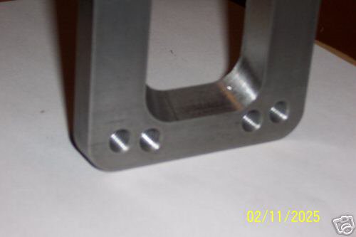

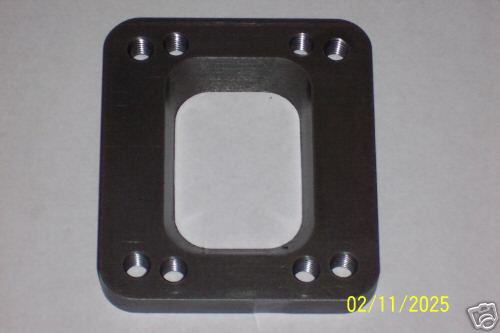

jgkurz Posted August 24, 2008 Share Posted August 24, 2008 wouldnt the t4 flange work for say a t3/t4 hybrid? No, a T3/4 hybrid uses a T4 compressor and a T3 turbine. A good compromise for the group buy header might be to use this flange that accommodates both a T4 and a T3 turbine. The only downside might be finding enough of these flanges and whether it would be a restriction for the larger T4 turbine. Click Here Quote Link to comment Share on other sites More sharing options...
jeffer949 Posted August 24, 2008 Share Posted August 24, 2008 With using that flange the guys that are running T4's could always just port them out to fit there turbine Quote Link to comment Share on other sites More sharing options...
Nigel Posted August 24, 2008 Share Posted August 24, 2008 With using that flange the guys that are running T4's could always just port them out to fit there turbine That's a pretty good idea actually. So long as they don't weld the T3 side to the manifold! Nigel '73 240ZT Quote Link to comment Share on other sites More sharing options...
