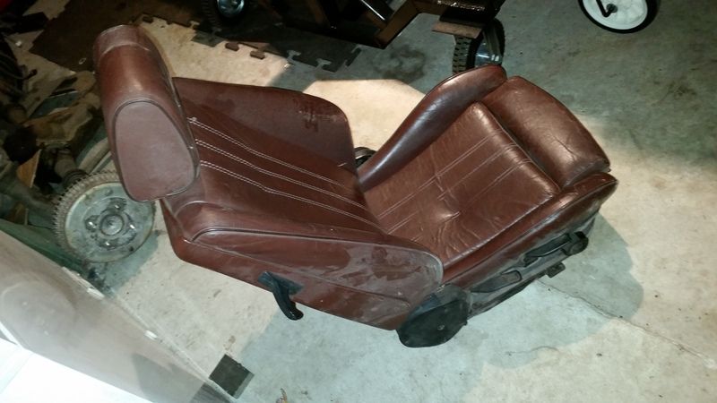

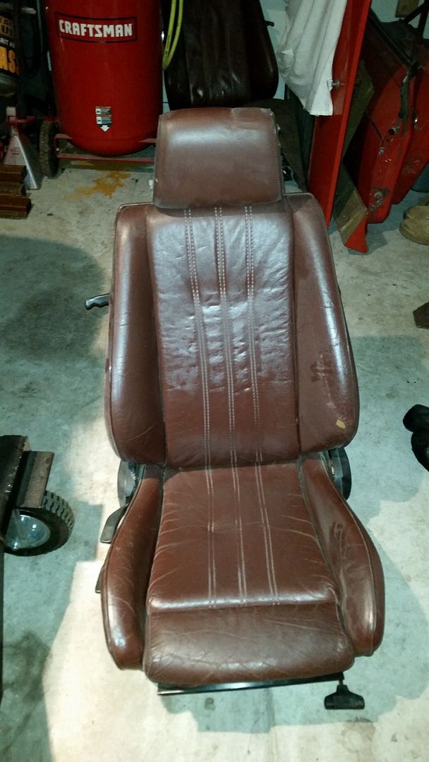

Jay Gadsby Posted May 8, 2015 Share Posted May 8, 2015 So, I finally figured out what seats came in my 240Z. Twas a long and difficult road since the parts numbers were as generic as generic can be. Anyhow, they are out of a late 80s, early 90s BMW 325i. Lots of adjustability, but require seat mount mods. The PO rigged them up with some plate and two part epoxy (lol) but as I am repairing my floors and frames, I will weld it up proper. Pics! Quote Link to comment Share on other sites More sharing options...
jhm Posted May 8, 2015 Share Posted May 8, 2015 Welding schmelding.....glue will hold your seats just fine! Nice looking seats there -- lots of adjustability for comfort and support. Thx for sharing! P.S. Just curious....what do they weigh? Quote Link to comment Share on other sites More sharing options...
Jay Gadsby Posted May 8, 2015 Share Posted May 8, 2015 (edited) They are no lightweights lol. They run in at about 43lbs. That is with rails, and about an ounce worth of dust lol. Both sides have the same adjustments and they have that fancy leg extension too. I just need to find a place to recover them when the time comes. Edited May 8, 2015 by Jay_Gadsby Quote Link to comment Share on other sites More sharing options...

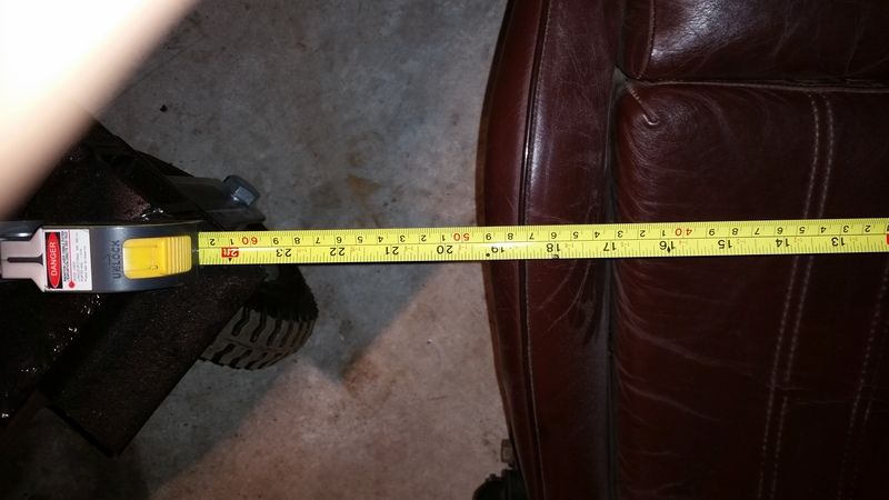

Evlevo Posted August 16, 2015 Share Posted August 16, 2015 (edited) Useful edit of my double post. I went outside and took some measurement and fitment pics. I had a stock seat, a leather S Chassis Seat (s14) and my wrx seats. Both will require custom mounting of course but dimension wise they both fit in the car. I also realized after i took the pictures i was jamming the passenger seats into the drivers side. I sat in the wrx seat while it was in my 240z (the higher of the 2) and there was still plenty of headroom. Im 5ft10. WRX Rail Width: 18 3/4 S14 Rail width: 18.5 All 3 for comparison Edited August 17, 2015 by Evlevo Quote Link to comment Share on other sites More sharing options...

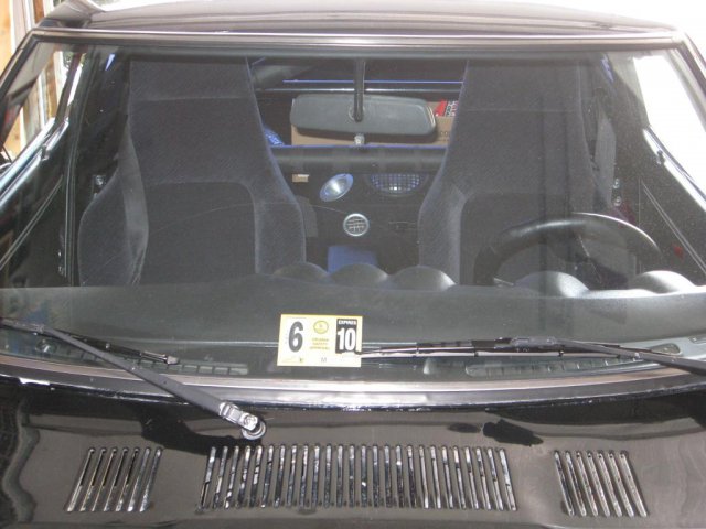

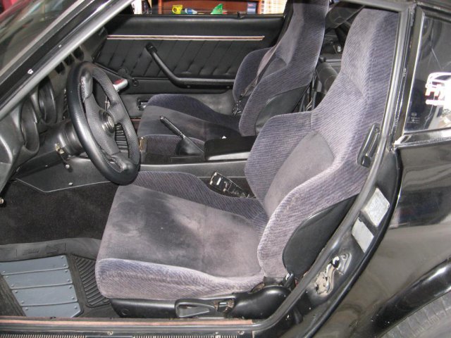

clocker Posted March 27, 2016 Share Posted March 27, 2016 (edited) 1992-1996 prelude seats needs to be off the list. just threw away some serious coin trusting that statement. driers seat is far too wide. These are '95 Prelude seats on our 280z and they fit fine. The cat hump required some reshaping (*ahem*) but the seat fits my 6'1" frame fine. We used the stock Datsun runners bolted into the original mount points and all the Honda plastic trim remains. They do sit taller than stock (my head doesn't touch though) which makes hanging your arm on the doorframe easier. Edited March 27, 2016 by clocker 1 Quote Link to comment Share on other sites More sharing options...

jhm Posted April 1, 2016 Share Posted April 1, 2016 Ditto what clocker said....I had those model Prelude seats in my late '74 260 (with the catalytic hump in the trans tunnel) for a couple years and really liked them. Lightweight, supportive and comfortable. Quote Link to comment Share on other sites More sharing options...

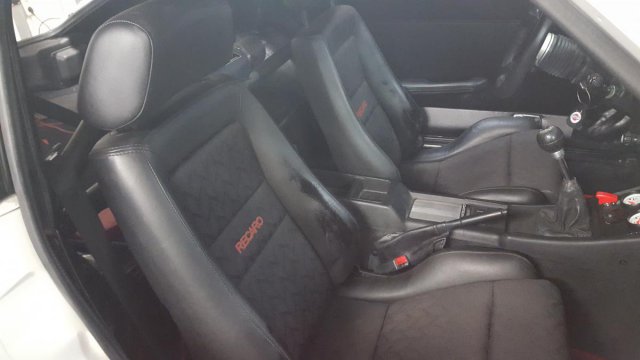

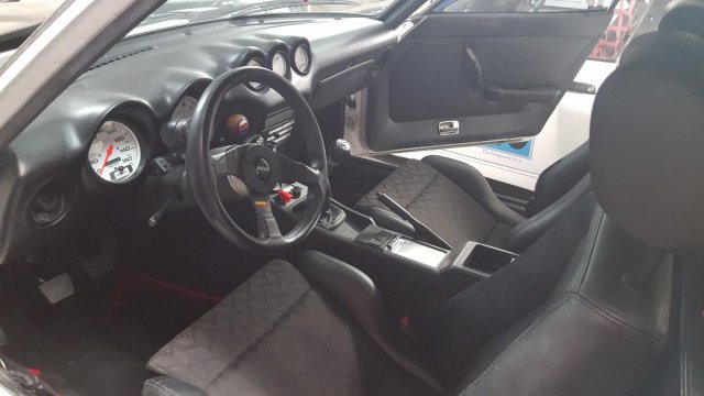

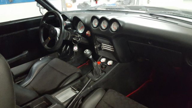

kroegarn Posted April 3, 2016 Share Posted April 3, 2016 This is my solution. Recaro seats from a mid/late 90-someting Rover (option from factory). It was a tight fit and you needed small hands to bolt the seats into the car. . Had Momo racing seats before... but getting old and wanted more comfort. Unfortunately dark and crappy pictures... 1 Quote Link to comment Share on other sites More sharing options...
