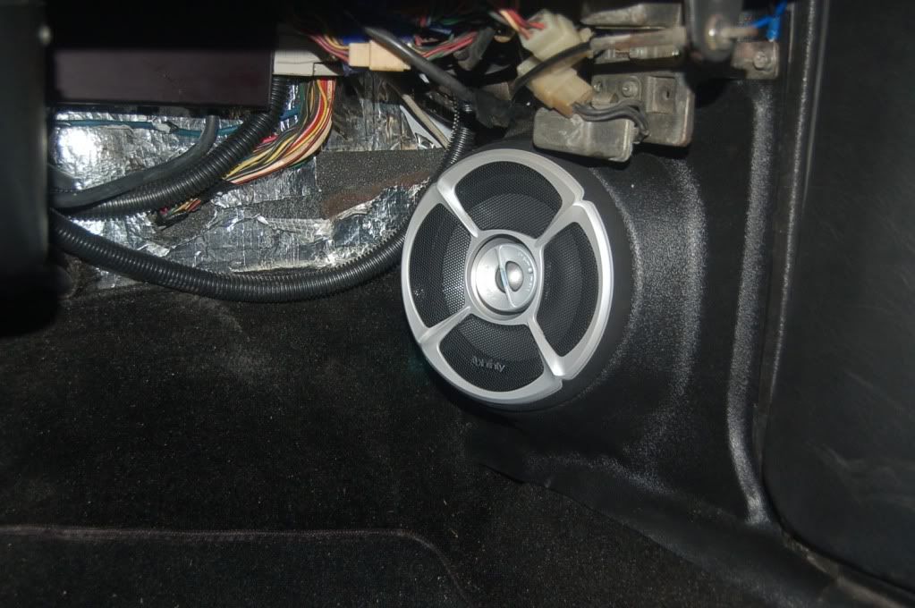

Well I got the drivers side done including mounting and wiring. I happy to announce that the dead pedal issue is very workable. Not perfect though. I'm 6' tall and have 350Z seats in the car. This forces me to drive with a little more leg bend than I normally would and also puts my foot higher on the pedal than I normally would have it. I can't switch between the clutch and dead pedals by just laying my foot to the left like I was before. Now the funny thing about the human species is that the same skill set that allows us to comprehend driving allows us to adjust to things like this pretty quickly. Five miles in traffic is all it took. I don't even notice it anymore. Basically I just have to reposition my heal slightly as I go to the pedal.
I also pulled the passenger side today and it looks like the first one is going to be a winner. I did a quick test fit at the end of the day and I'm pretty satisfied.

Well I got the passenger side mounted and wired. The carpet cover was a real PIA to get shaped correctly.
Man what a difference front speakers makes! Much better sound. I tested it out with the same song I've used since 1979 for testing out my sound systems....Comfortably Numb. You can guarantee that gets volume whenever it comes on!
Well I'm might happy I followed through with this. It really cleaned up my kick area as well.

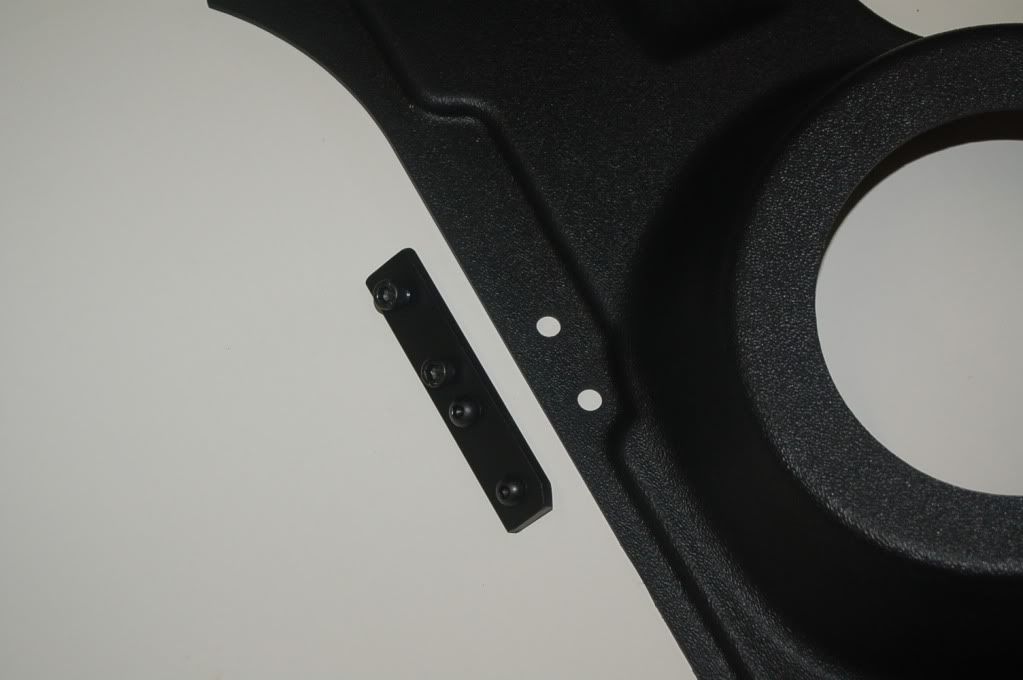

I pulled and cut out the four sets. The first set is ready to get shipped to my first victim .. I mean customer tomorrow. I have a second set going out Monday so hopefully we'll know shortly how it's going to work out. I cut them exactly like the stock panels so I don't foresee any problems but I just want to make sure before I offer them up.
Here's the finished product. I sprayed them with SEM trim black for Tyler but I don't know if I'll be spraying the production ones or not.
I'm including a bracket to move the hood release cable up and away from the speaker.
And as usual I've included the hardware.
