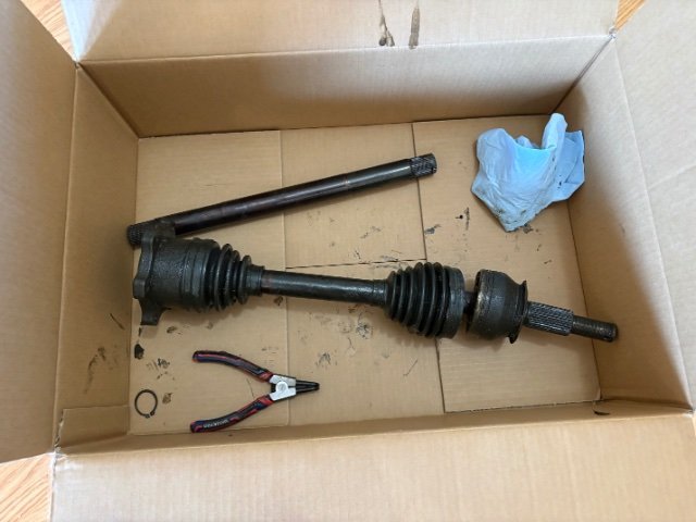

Might be a month or so before I get to it, but I’ll post updates. Figured I’m moving all the guts to the carbon fiber doors, why not see if the auto stuff will work. Played with one of the axles last night, fitment seemed good and went together really quick when they are manufactured correctly 😅. -

New axle shafts came in today, woohoo. Now that’s how the snap ring is supposed to sit. Hopefully I can put them together this weekend. Also got some other goodies, push to start electronic locks and window kit. -

Flatout got a set of control arms that were made too narrow and don't fit. Apex seems to have been sending things very slowly lately and then having a low rate of good parts when they do send them. -

Most of the Apex kit has been good, a few minor fitment issues on some parts and that front bracket to attach the subframe with the hidden carriage bolts was a PIA to get in. Getting these axles has been a mess. I ordered the rear kit 8 months ago and still waiting on parts. Luckily I’ve got lots of other things in my build to work on, but if I didn’t I’d be really upset. -

engine looks great. Really loosing confidence in APEX parts. -
Apex said that batch with the new vendor had the groove to short, they are sending some new ones. Glad it wasn’t me, was racking my brain trying to figure out what I was doing wrong. Go the rockers and intake on today, engine is getting close to done. -
