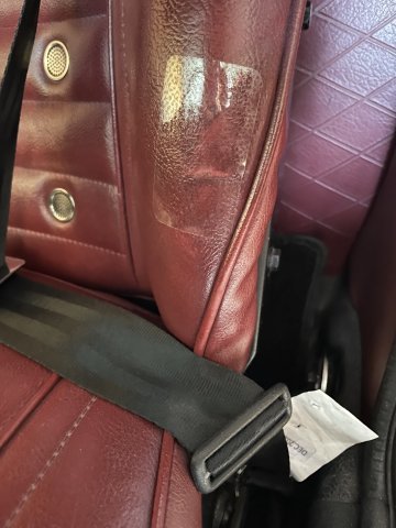

05-10-2025. I did a lot of odds and ends today.....little things put off.....I just went around and fixed as I saw them. I used the clear PPF film over the carbon fiber on the inner fender as it was getting real ratty looking on the edges. I also cut some pieces, and put it on the 2 spots the seats are showing wear from being a big guy getting in and out of the car. Will they work on Vinyl? Not sure, but I need something there. Seams showing some cracks due to my poor bodywork skills, this seals them so I can just forget about it and enjoy the car.t Tuch up painting all over the place, then vacuuming....I guess you could call it spring cleaning. I went back to a novel way of richening up the carb a little....washers under the choke know to add fuel everywhere and buy add a washer at a time I have been able to make a lot of progress on getting it right. The other way would be to buy a richer needle, but this is easy, cheap, I already have the parts, and it works. In short it was just a nice sunny day and I got stuff done. I did take A LOT of pics, so the pics I will put on here.....it's pics heavy. so you are forewarned. Cheers and God bless.~Joe - Yesterday

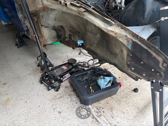

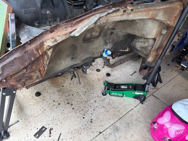

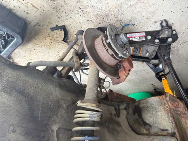

Got the front suspension and sway bar off today. Fought me a little bit, but impact helped a lot and had to take a sawzall to the toe arms, but it’s all out. -
