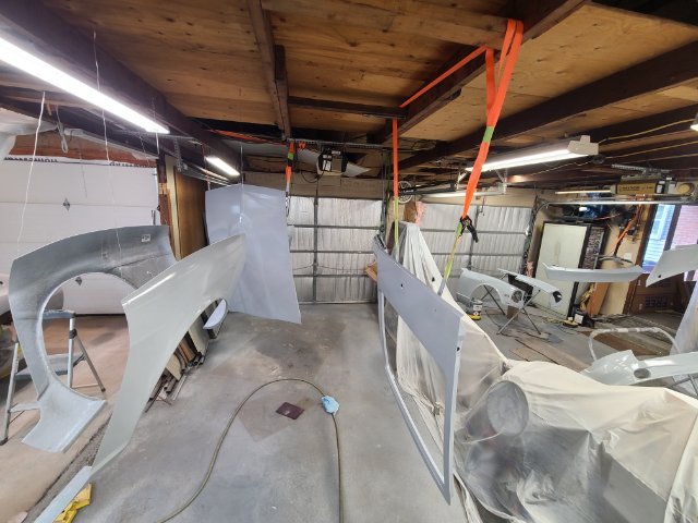

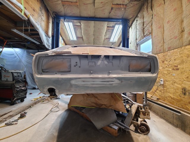

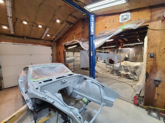

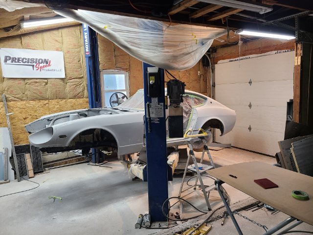

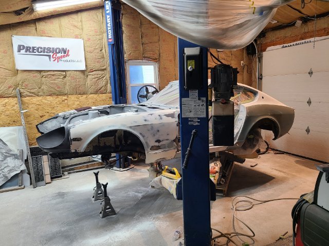

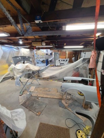

spend tons of time last week doing body work. I am TIRED of sanding. Saturday got the whole car in epoxy. Spent 13hr sunday, and 5 hours monday, block sanding and some final little body work touches. Weather got cold for some reason so taking the next couple days to dial in the last of the little details and hopefully later in the week get some color on this thing. I thought i had a good size garage until I need to hang 16 things from the ceiling for painting. A friend let me park my truck at his house. My 240 i just keep moving in and out of the garage. and have the dailies living outside in the driveway during this process. -
