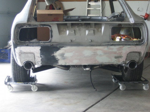

  10. I thought I was done but I changed my other mind. I decided that I wanted more room for different mufflers later on -if I need them-. Also the issue of the tips running thru the valence I thought might haunt me later -----soooo I changed things a little

    twice pipes

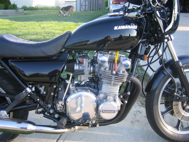

  12. I put single stage black on my bike and it was very easy to use. Any mistakes I sanded with 600 and then buffed. It was amazing how well it buffed out.
