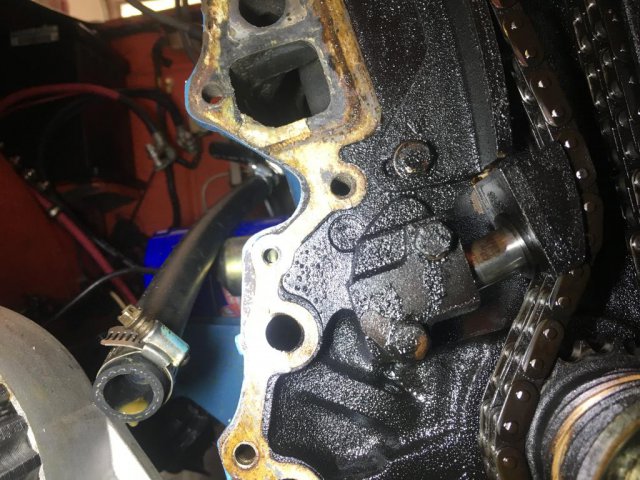

  6. It actually ran pretty decent with no noises . The chain was eating into the tensioner , plus it as stretching . Engine had less than 100k. Obvious lack of oil changes didn't help.

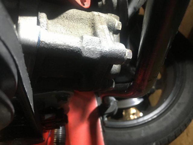

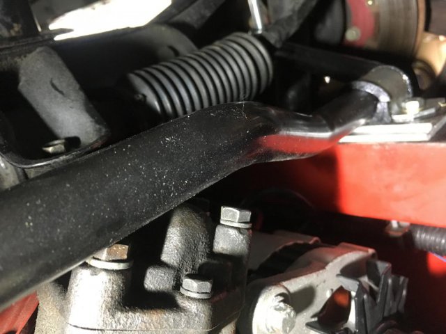

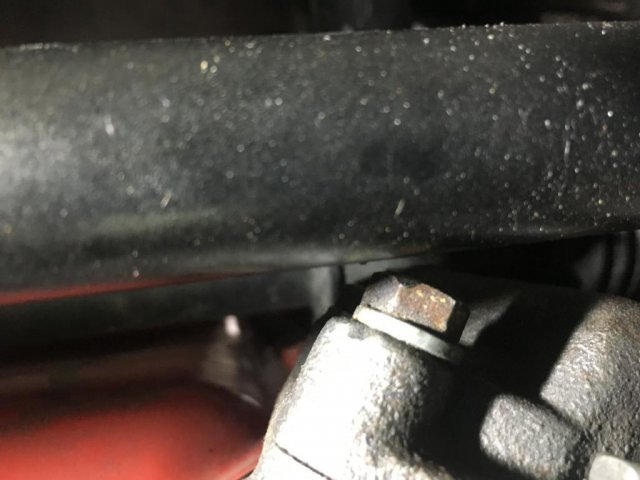

  8. Here some pics of the stock sway bar in relation to the pump. The car is off the ground. So does this look like stock position for your bar? If the stock bar doesn't sit right ,then the bigger one won't and I have other issues. The one bolt from the oil pump hangs over the back half of the bar diameter. Stock spring perches with ST lowering springs
  9. That's what I did- 1/2" . My point here is that it is advertised as a bolt on sway bar - NO MODS. So what if I had not noticed the bar laying on the oil pump at droop and when it was on the ground it cleared. I'm thinking I'm good until either I hear it banging or it takes out the oil pump . Don't want anyone falling into this mess if ST didn't put the kit together correctly. Or if I'm just doing something dumb, I want to know.
  10. Thanks for the feedback guys. Again I ask how the engine mounts could affect this other than failure . I measured thickness of mine compared to brand new Nissan mounts on a 72 I am redoing. if the end links were taller - yes that would help- but pretty tall already. My plan today- if I have time - is to pull the sway bar and lay it next to the stock bar. It seems to me that the bends are not at the right angles - especially for the end links. These sway bars are hand bent , so always room for error.
  11. For what? The mounts look solid and the front end isn't falling off. I could see how someone could miss this issue if they install this bar. Might not see the bar hitting the one bolt on the pump while its jacked up and then when on the ground the bar twists and clears the bar

  14. New ST kit and the 1 1/8" front bar under full droop ( jacked off ground) hits the oil pump bolt pretty hard . It took about 7/16" worth of spacers to clear the bolt by 1/8" . Seems wrong to me. I know full droop would be basically airborne , but worst case scenario it seems that the bar would smack the oil pump pretty dam hard . Feedback please . Let me add that weight on the wheels and clearance grows to 1/2"
