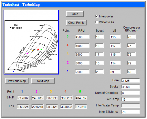

	I'm having trouble at low rpm and high boost. Lots of shuddering. Pretty nasty feeling. Feels like it's misfiring. Double checked and redid my flow calculations and I should not be surging, or even close to surging. Not sure what's going on. Spark blowout? Bedded and tried out the new pads. Seems to bite a lot better. Painted the VG33 block. Need pistons.
	Ok, I'm not entirely sure what I'm experiencing. The problem I'm having is that at low RPMs, 2500-3500, and high load (boost), the car violently shudders. Pretty sure it's misfiring, as my datalogs are showing errant RPM readings. This only happens in 4th and especially in 5th gear, at 100% throttle, below 3500 RPM. Full throttle at higher RPMs results in normal ass hauling. I'm seeing 2psi at 2500 RPM, 15psi at 3000, and 18psi at 4000. I think it's spark blowout. I've encountered spark blowout before on VG30s, but only at high RPM and gapping my plugs down to .030" or so fixed it. I've tried as low as .025" in this case, and while it seems to improve the symptoms, it doesn't go away. My next theory was that my worn out, inefficient engine was surging. Mapping out 5th gear pull datalogs over my compressor map, that doesn't seem likely (I'm using VE values from Megasquirt, which might be off, but are eons better than guessing). So what gives?

	Reviewed datalogs and smoothed out area at and around 220kPa @ 3000 RPMs (17psi). Turns out in 4th and 5th gear I get full boost (17psi) at 3000 RPMs. Nice. Getting close to the surge limit of the compressor (according to my spread sheet calculations), but some cams and head work should increase the margin a bit. Oh, and switching to the 3.3L will definitely help as well, which I can hopefully have done by next season. Got new Hawk pads on. Will bed them in this weekend and give them a try.
