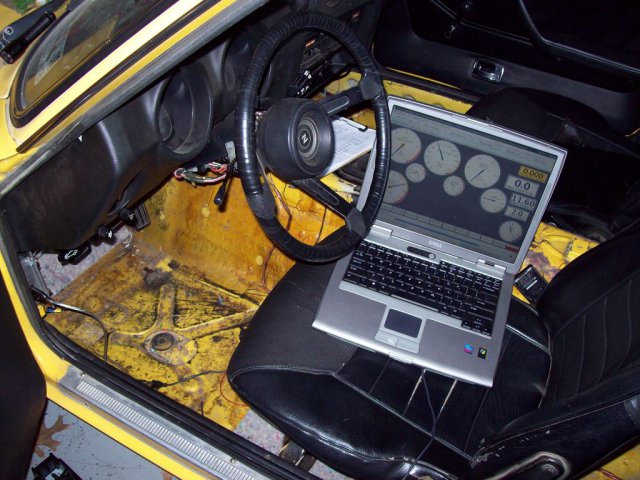

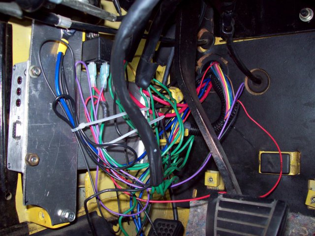

I got started on the wiring this weekend. It's nice to be able to get stuff done on the car without getting covered in oil. A nice change of pace. I got quite a bit done: Megasquirt is powered and grounded and working. I have the CTS hooked up (using the CHTS on the VG30E, as in the Z31 it came out of), CAS, and TPS. A mess: A somewhat tidier mess: The relay above is for the fuel pump. I am using the stock S30 relay for megasquirt and sensor power, but the fuel pump relay wire coming out of megasquirt is to ground the connection. The stock relay, as convoluted as it is, doesn't really have a way to connect the ground just for the fuel pump circuit. So, I have that relay to switch +12v to the stock relay's fuel pump circuit when grounded. So it's a relay to turn on a relay. It was either that or forego MS's fuel pump wire and have the fuel pump be on whenever the ignition is on. Since most (all?) of the Nissan harness connectors were broken, I replaced them with weatherpaks. I have a Bluepoint weatherpak crimper, and it really just barely does the job. I can't see myself spending 80 dollars on a new one, so this will have to do, you just have to be careful when crimping the connections. I have a feeling I cut the harness too short. Not a huge deal, I can add length to any sensors that need it (TPS, most likely). Measure zero times, solder twice. I have some 550cc precision injectors, I just realized the Z31 connectors don't fit, but I found some cheap new ones off ebay that should be in soon. They are low impedance, and rather than try out my MS2's flyback circuit, I will just use the L28's dropping resistors. The stock wiring is really dumb in some places. The power for the injectors and ECU isn't on a fuse (this appears to be a PO's modification), and the injector power wires go from the battery, to the driver's side firewall hole, to the main relay, out the firewall to the dropping resistors, back inside the passenger compartment only to loop around, and then out to the injectors. Another couple feet and they could have skipped the dropping resistors as the resistance of all the copper it had to go through just to get to the injectors would be equivalent. Inbetween wiring spurts, I welded up the intercooler I had chopped up earlier. The 1/8" thick cast end tanks were near the maximum my little TIG could muster, and I had too small filler as well. Good thing no one will be able to see it easily. This fan, although a little small in diameter, fits easily between the intercooler and radiator. Flipping the blades over converted it from a puller (as it was on my Z31), to a pusher. Less efficient this way but I don't see cooling being an issue. I also drilled holes and properly mounted the radiator. Closing shot of TunerStudio working:

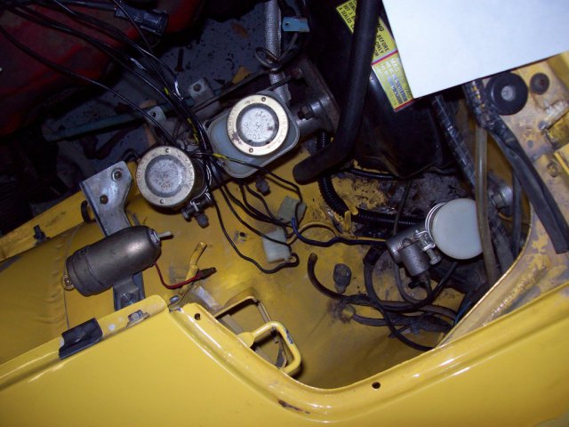

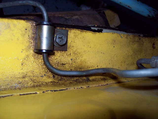

Well, I have some midterms coming up so no real time to work on it. However, I did get some 1-1/4" SCH10 straight pipe, and with a little cleaning and slight grinding, it will fit right in the flanges I have. This is good so I can weld on the inside which is preferable, and only do partial welding on the outside. So, next week I will order some 1-1/4" pipe fittings and eventually start from scratch with the manifolds. I have enough straight pipe to start on a pair of 3-1 merge collectors though. In other news, I removed the A/C components a couple days ago. Apparently I disturbed something because today I found a large pool of brake fluid sitting on the frame rail. The paint there is ruined. My MC has apparently been leaking in to the booster. And the booster gave way. Luckily I never completely flushed the fluid when I got the car and it had already absorbed water. So, the paint is bubbling but not coming off as easily as it would with fresh paint. For whatever that's worth. When I remove this VG30 for the VG33 I will have to repaint it there. I've been trying to get a hold of a VG33 long block with no luck so far.
