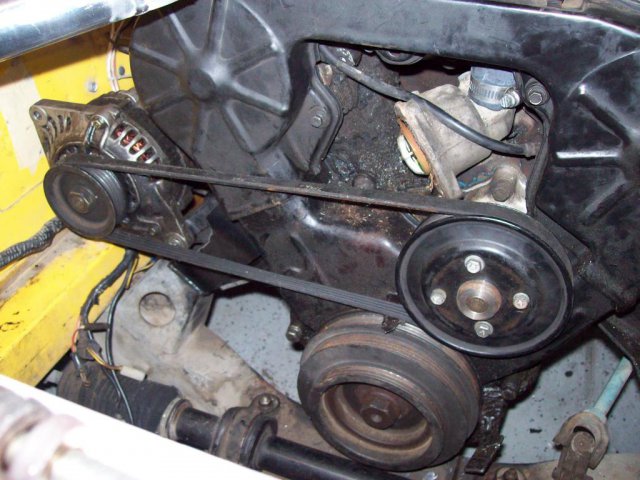

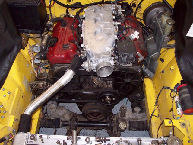

  7. Thanks. I just hope my flywheel never explodes. A small update. Getting crowded. In an attempt to change one of the outlets on the radiator, I managed to fubar the whole thing, and I've ordered another one. Well, actually it wasn't really fubar'd, but it wasn't worth reselling. I just got an aluminium eBay one. It's a stock replacement one, downflow now and it should be able to fit both of the fans I currently have since the core is larger. I wish it would fit them as pushers since that would save me some room behind the radiator, but I'll figure it out later. I'm going to stop posting so often here and use our local club's forums to post instead: http://www.cowtownzclub.com/forum/viewtopic.php?f=7&p=47

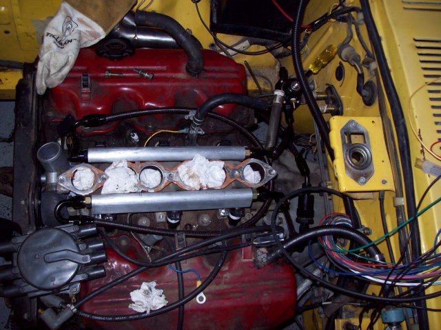

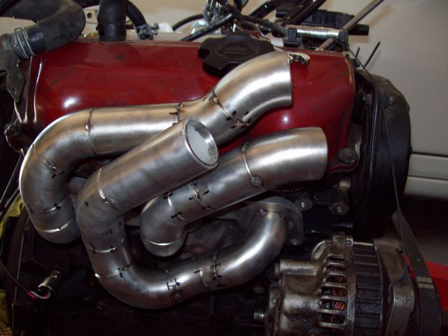

  12. Gave up on that alternator mount since it was fugly and a lot more work than necessary. Went back to my original (the OEM) mount: Started on the passenger side manifold: Made a crappy collector using a chop saw. Not really motivated to make another. My chop saw reeaaally didn't like cutting at that angle. Did some cleanup, and fab'd a coolant pipe up. Alternator/motor mounts are okay for now. Fuel lines have been completed and pressure tested. Intake needs some more grinding to fit around the fuel rails.

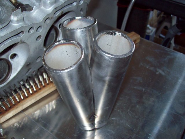

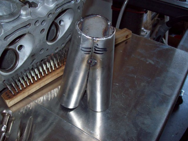

  13. I spent an entire weekend measuring, chopping, grinding, fitting, tacking, and it looks like ****. I figure this is one part where it's worth it for someone else to make. I've seen all kinds of 3-1's for sale online, but not out of 1-1/4" pipe. Basically, I need a 1-1/4" SCH10 3-1 splayed merge collector. 9 degree merge angle, 6" long primaries. Will eventually go to 2" SCH10 pipe. Just needs to be tacked enough to ship to me. See pics below. Let me know your fee and shipping to 76016.
