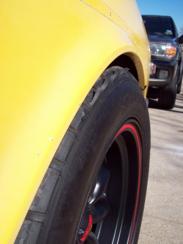

Yeah, couple things. Tokico lowering springs and new shocks on all corners. Looks great now, but the rear tires really rub now on bumps, and the front's rub a bit on full-lock. I foresee a 215/55/16 purchase in the future. I'm trying to keep it close to the stock diameter. Not rolling any fenders.
