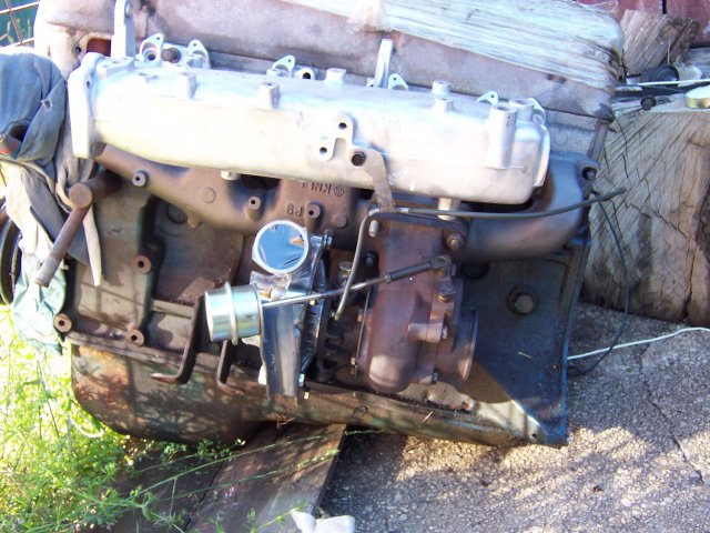

Maybe it to help with oil drainage with sumps with the pan at the front, ie early Skyline, I think I may have issues with drainage with my US spec turbo manifold and front sump on my car. see pic

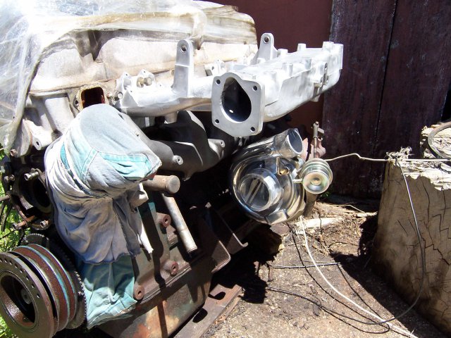

Thanks for that, If you look at these pictures, the turbo sits out a little further (1/2 inch spacer used), and I didn't want to try to bend the metal line to sharply (It was all bent by hand, no tool used except for the leg on the trampoline) also if you are wondering about the sump, it for my 240K, not 'Z', see pic. Nigel

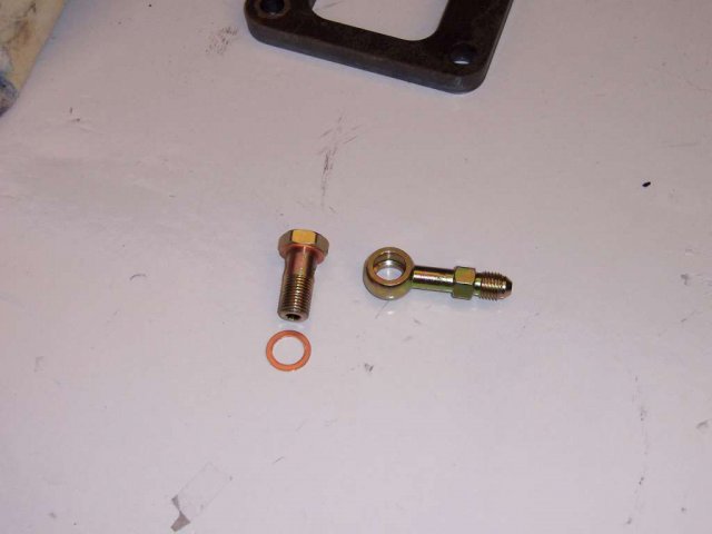

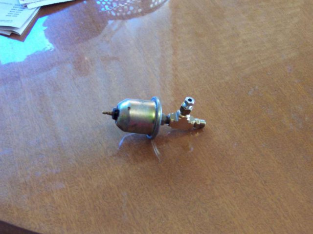

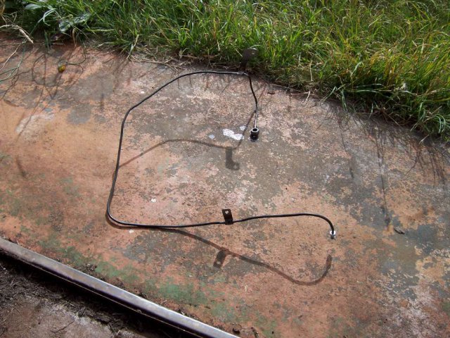

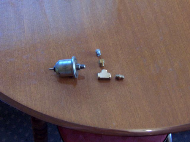

Thank you all, I have the banjo bolt and fitting, I'm planing to use some brake line to make this (from my wrecked MR30), one end has the flare , the other end will be silvered soldered onto the banjo fitting. I got my Tee now, went to the local hose fitting place, they had all the bits in stock to make it Nigel
