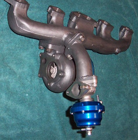

It's a matter of space and compromise. The people who want a header to build an all out "max effort" engine will certainly want an equal length pulse tuned header. In my opinion the header should be built to accommodate both the "max effort" crowd as well as the daily driver folks with A/C. We will be better off by compromising a just a bit so we can make the group buy more attractive for more people. I think we all win of we can agree on a design that accomplishes this. In the end some people will be disappointed because the design won't be engineered to perfection. I don't think that can be avoided. If some one wants to spend the time to mock up an equal length pulse tuned header that accommodates A/C and doesn't come too close to my frame rails then I'm all for it. However, I think this would be an unrealistic and enormous undertaking to make sure it fit both the S130 and S30 cars. BTW, I think 1000 rpm spool improvement with a pulse tuned split header is a bit optimistic. Please school me if you have info to the contrary.
I couldn't agree more!!! The perfect turbo header would have equal length primaries and would have the tubes pulse tuned to take advantage of a divided turbine but this is not practical for the masses. Here's my vote for options: 1) I'd prefer a T3 flange but the option for either T3 or T4 would be desirable. T3 would probably be the majority of the orders. 2) Primaries should be about 1 5/8 and made of thick gauge tubing. The header should NOT be a log style but should accommodate A/C and should have all primaries merge together just before the turbo flange. 3) Wastegate location will need careful mock-up. The entry point should be next to the turbo flange so the wastegate port see's all cylinder pulses. The wastegate flange should be in a location that allows the WG can be tucked between the header and the the block. Something like this: or this: 4) For the wastegate flange I'd prefer the larger 40mm flange but the 38mm will be more common. Some people may even want the 44mm or larger. The option for either would be desirable. See here: http://www.tialsport.com/prod_wg_fl.htm 5) The cylinder head flange is also a concern. Will the same shop be creating a flange or do we need to supply separately? 6) I'm not concerned about a downpipe since I want to custom build my own so it's fits my car properly. 7) Will we have the option for a high-temp coating?

I believe the below header designs would satisfy the majority of everyone's requirements. Notice the beautiful welds and how the tubes transition from round to rectangular in the first design. Although not equal length, they are not a log style and should accommodate A/C. The multifit T4/T3 flange would work for T3 folks but the T4 folks would sacrifice because the ID of the flange would still be T3. At least it looks that way to me. Also, I definitely do not want stainless. I think they are much more prone to cracking. Example Header #1 Example Header #2

I'm in but I can't lead the Group Buy. I have an S30 but the header shouldn't be much if any different for a ZX version. Price is less of a concern than product quality. I would prefer not to use stainless steel but rather a thicker mild steel for reliability. This is probably a given but it must have a wastegate port. I use a 40/41mm but if it came with the more typical 38mm then I could change it myself. I also would like a T3 flange rather than a T4. I would prefer it look like these: Or maybe this one if I had to compromise: But not like these:
