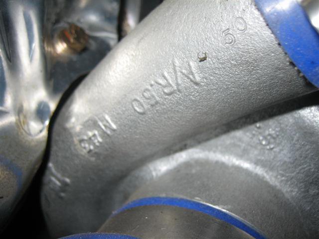

Clifton, Max flow of the E50 wheel according the the map is 47lb/min which is achieved at a pressure ratio of roughly 2.6 or about 24psi. 35psi is possible but at 47lb/min he would be WAY out of the efficiency islands. The charge air would be so hot from over-revving the turbo that peak HP would likely be less than it would be at 24psi. I agree that 450RWHP is optimistic especially without a bigger turbine wheel. Hugh, A .60 A/R compressor housing is supposedly more efficient than a smaller housing. In other words in should be able to move more air volume at the same boost level or the same volume at a lower boost level. This is all theoretical but that is my understanding. A .70 housing may be too large so there are diminishing returns. It's all a balancing act between the compressor's and turbine's ability. So yes, there is an advantage to a .60 housing. If you can make it fit I would use it. If not try and locate a .50 A/R housing. As for the cermachrome coating I think you are right. The black coating should have been used. The cermachrome usually is not rated high enough for turbine housings. Worst case it that it will get dull. Some people say it will flake off if it gets too hot but I've never seen that happen. -

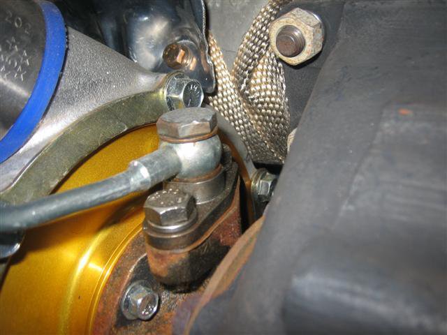

Hugh, My compressor housing is .50 A/R so it's very small. I think it's from a T04E but it might be a T04B. I've never really been sure. It fits the OEM exhaust manifold without any modification or spacer. It was originally sourced from Jim Wolf as a Sport 400 turbo. The larger .60 A/R housing would be better than mine if you can get it to fit. Personally I've never had to try and fit a larger housing. FWIW the GT35R typically uses a .70 A/R compressor..... If you are going to build a custom DP you might try a spacer or you could try and find a .50 A/R housing. There's a good chance you could just swap the .60 housing for the .50 assuming you find one. If the compressor housing is machined specially for your wheel (like mine) you would have to have a turbo shop install the different housing. I hope all this makes sense. -

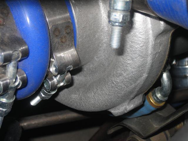

Sweet looking setup. In case you don't have a copy here's the compressor map for your turbo. Looks like max flow is around 24psi give or take a few. Can you remind me where you got the V-Band outlet? Also, do you have a spare exhaust manifold to make sure the compressor isn't going to hit? -
