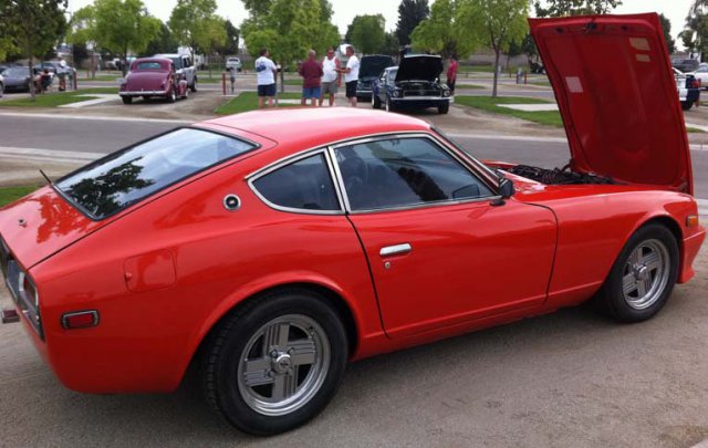

From a recent hot rod meeting. A friend of mine invited to bring my classic, didn't specifically ask for a 67 Camaro. I brought my 76 import
