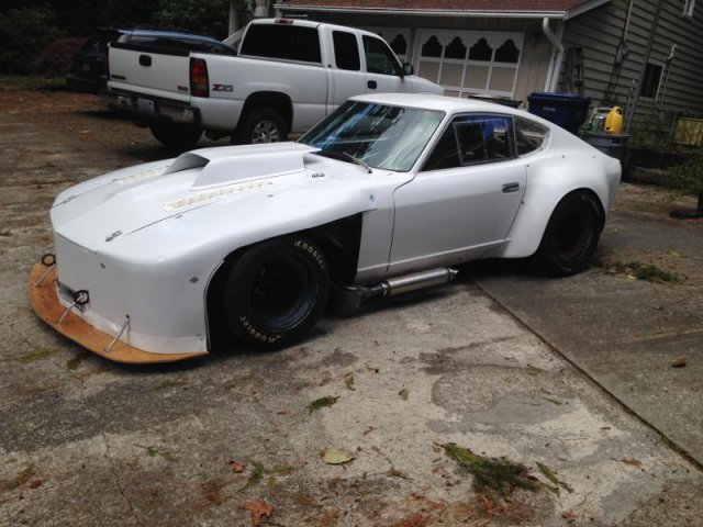

Did corner weights over the weekend. Drivetrain offset 1.5" right. Fuel cell is offset right as far as possible. Rad slightly off to right. Driver's seat 1" right. This is with me in the car and the hood on.
Look at zredbaron's "no shortcuts" thread. I went with him to dyno the motor. The 45s made another 27 hp if I remember correctly, with very little lost on the bottom end.
'70 240, L33 5.3L AL block, carb with (heavy) aluminum intake manifold, flexplate and button clutch, T56, R200, probably too much cage, plywood splitter, super wide body, 15x14 wheels, stripped interior, no pass seat, 2370 lbs.
