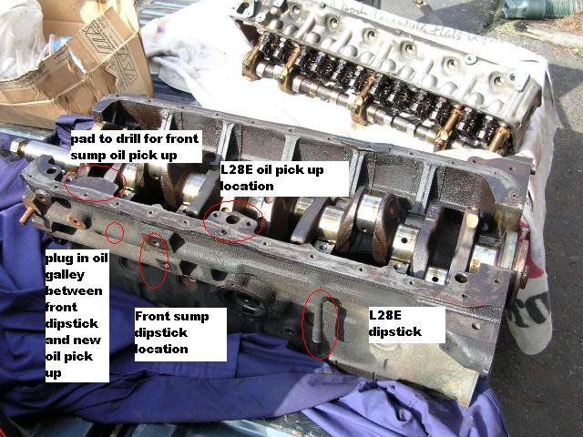

I may need to post picture to explain, but the location where the oil pickup mounts to the block is different on the L28E and the L20ET. This is the pad you will need to have drilled. If you just drill the L28E block for the front dipstick mount you will drill into the main oil galley between the pick up and the pump. The proper thing to do, is to drill the front oil pickup location on the L28E, install a plug between the original L28E pick up location and the new one you had drilled. The drill the front dipstick mount on the L28E. As I indicated, I took a different route as I didn't have access to a machine shop. I will post a pic in a little while, but there are plenty of pics showing the oil pump pickup locations already on this sight.
I just swapped a L28ET into my GC110 Skyline. It was easier for me to modify the oil pick up tube to work with the front sump and not drill the pad on the L28ET block. I plugged the rear dipstick hole on the L28 and drilled a new hole one into the side of the block to work with the front sump. I used an aftermarket universal style dipstick. Incase you didn't know the l28et and l28e blocks are functionally the same.

You might just want to make a new oil pick-up tube for the L28. It is consideraly less work than boring a block. I have an L28ET in my Skyline that I coverted to front sump. We now return you to the L20 thread you were reading.
