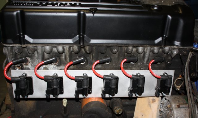

You might want to look into an '82 or '83 turbo dizzy. Then you can just slap in whatever wheel you want - easy peasy. IIRC MS2 will support wasted COP/CNP. I'm running MS3 and MS3X for full distributorless and/or sequential injection.... soon.... hopefully.... -
Talk to me bro - where in Canada are you? You said you picked the car up in Seattle so I'm guessing the Lower Mainland? If so I'm just over in Victoria. I've got my MS3 up and running and I've tested my setup for distributorless ignition for spark control - just waiting on my diyautotune optical encoder wheel to actually run it.

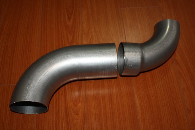

Right I understand that but the outlet of a stock T3 is 2 1/8" so you would have a sharp edge from 2 1/8" to 2 7/8" or whatever your 3" inside diameter is. As far as I know a sharp step like that will cause significant turbulence which isn't good for getting rid of the exhaust at the exit of the turbo. Also the stock T3 doesn't use a V-Band flange. Also for the stock flange there is barely room to bolt it on to a 2 1/2" downpipe. I suppose if you were using a stock flange you could bump a 3" in where the bolts come out to allow it to be bolted on. Did your T3/T4 come with the v-band or did you need to modify it as well? Thanks for the pictures. Those are great! Do you have any pics of the downpipe back for the rest of your 3" exhaust?
Perfect. Don't under estimate the stock heat shields though. They do provide a significant thermal barrier. You can get a 3" but it's a challenge on a 280ZX.... here's an idea though....
Instead of making it look good while you've got it off make it work better. The stock runners are a major restriction - almost half of the area of the intake valve. Port them out and at least get rid of the casting ridges. A 1" 60 grit flapper wheel on a die grinder works well - even better if you have an extension. I recomend using some heat barrier on the heat shield if you have all that off. DEI makes a nice heat barrier blanket with mylar on one side to help reflect the heat back that you can put on the heat shield. A 3" downpipe isn't going to mate up to the stock turbo - the outlet is less than 2.5" - you'll have to taper/flare/grind, etc to get up to 3" smoothly
