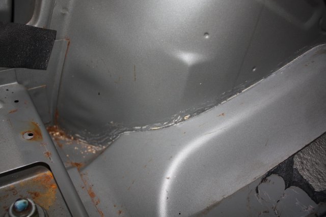

Thankfully I had read about the dry ice trick before I started. The trick is to wait long enough for the tar to get really cold. -

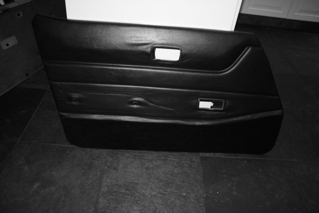

Playing around with modifying the door panel carpets. Before: After: Ok not quite before and after - just mirrored the picture of the other side for comparison.... you get the idea -

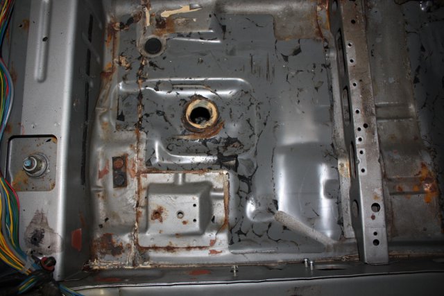

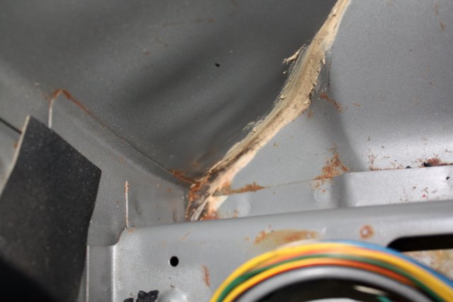

If you don't know about the seam sealer on the S130 then it's something you need to do if you are planing on keeping your car. As you may or may not know the seam sealer is poreous and absorbs water. It esentially does exactly the opposite of what you want it to do which is seal the seam and keep the water out. It's fine until the seam flexes and the factory paint cracks allowing water into the seam sealer. Once the water gets in it stays there and follows the seam bringing rusty destruction along with it. -

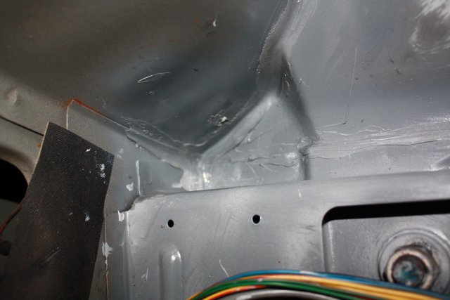

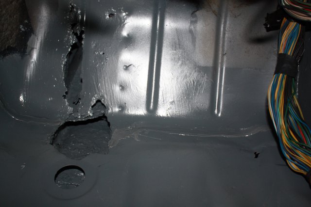

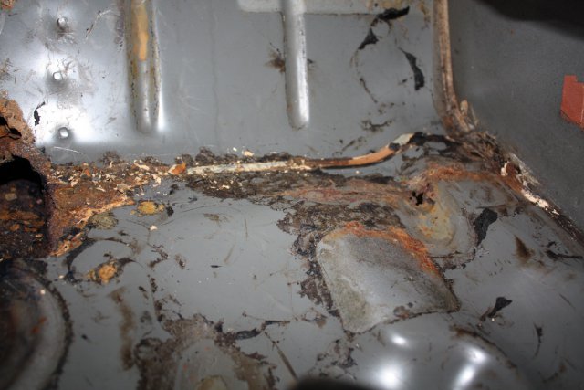

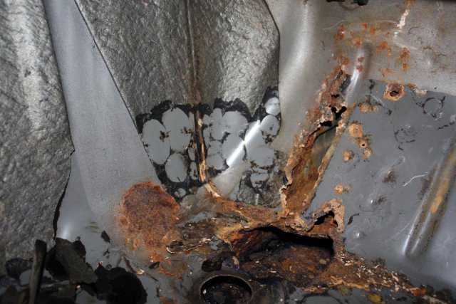

The worst of the rust. The frame rail was dented and instead of rusting the actual rail it ended up steaming the floor and rusting a small hole through. Conquest, Rust Killer primer, enamel paint and temporary patch. Mostly surface rust and the odd bubble. Also I cleaned everything with vinegar to kill any mold so any bare metal would turn to rust almost instantly. The biggest killer on the S130 was the seam sealer ironically enough. It's poreous and absorbs water once the paint cracks. Water follows the seams and they rot out. Simple fix is to remove the seam sealer BEFORE it all rots away and put in a modern urethane based seam sealer. -

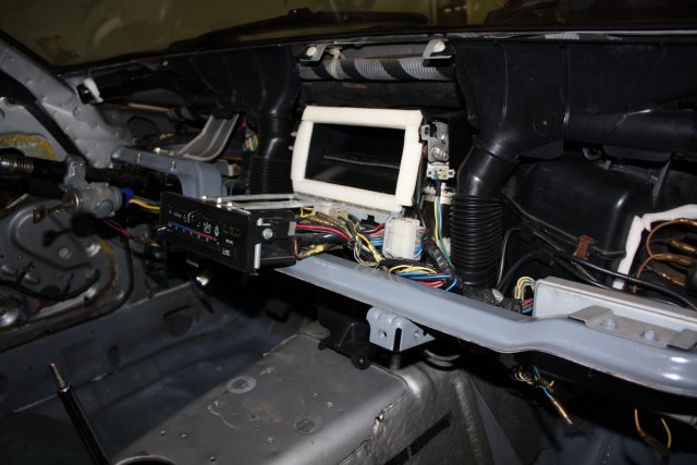

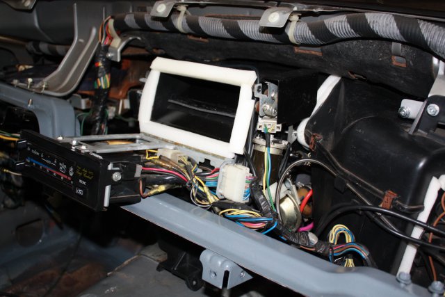

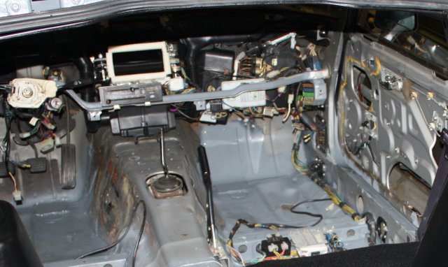

The defrost wasn't working properly though so I ended up pulling the dash and spent about eight hours completely rebuilding the climate control unit. Reuel gave me a spare one when I was down in Portland so I used that as my guinea pig. Its hard to see but the vaccum lines are colour coded depending on what "circuit" they are on (sorry electronics guy's view of a pneumatic system). There is a "schematic" in the FSM that shows you how the whole thing works. I figured a quick little trick is to cut about 1/4 inch of the end of the vacuum line where it gets all hard and push it back onto the fitting for a nice tight fit and no more leaks. I used a lot of open cell foam to get a better seal between units and piping now it blows like a hurricane! I was showing my brother how all the vacuum relays work with the dash still off and he was standing a few feet from the back bumper with the hatch opened and the wind was still quite strong all the way back there. I cleaned the evaporator up inside the car and vacuumed the pine needles, etc out. Took a while to get the greasy fuzz out as well but she blows good. Not sure about the other side of the AC yet though. I think the belt is missing IIRC... We'll take a look once the interior is done and we get 'er up on the hoist. -

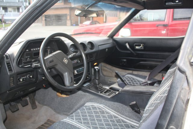

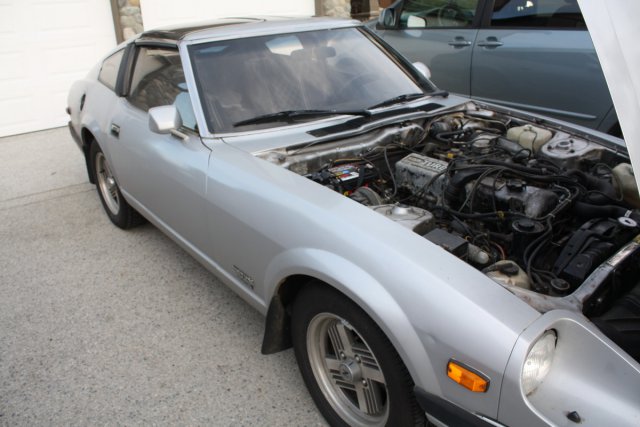

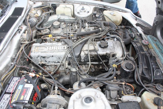

A little crusty in the engine bay. Now she has new plugs (rust free!), wires, cap, rotor, PVC valve, MSD coil, refurbished J-Pipe with DMS BOV until I get the intercooler setup installed. The "security" starter switch which was wired to the solenoid on the starter is a safety issue so that needed to be fixed (you can see the wires going from the battery through the firewall to a switch below the steering column). Turns out they were trying to bypass the broken ignition switch. New ignition switch installed. The reverse lights weren't working but the NC portion of the tranny switch was working so I hooked a relay up so the reverse lights work for the safety inspection. -

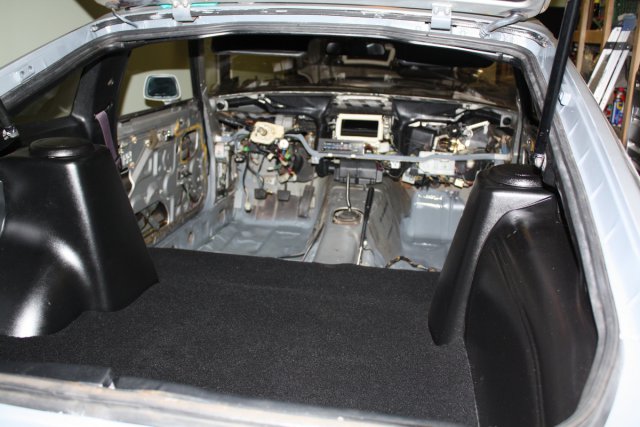

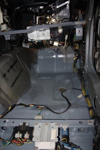

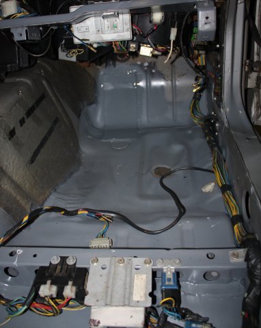

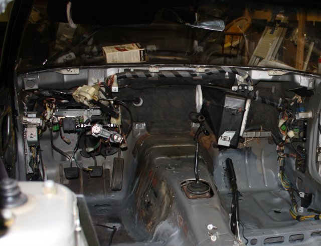

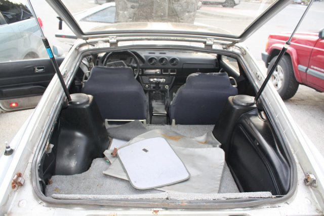

I was just going to rip the carpets out of the 280ZXT since the interior was in shambles. Unfortunatley I didn't get a lot of great pictures before I ripped everything out. You can't really see the grey household carpet they used inside the car or the grey household carpet glued to the back panels, etc. The seats were grotesque under the covers. It was pretty musty too and there was a lot of green stuff growing on the outside of the car. I think she sat for a while. Anyhow ripping the carpets out lead to taking the underlay out. Then the sound dampening material. Then all the body panels.... then the well I guess I should post some pictures so you can see how I got a little side tracked with the interior.... -

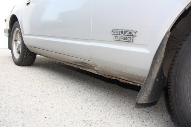

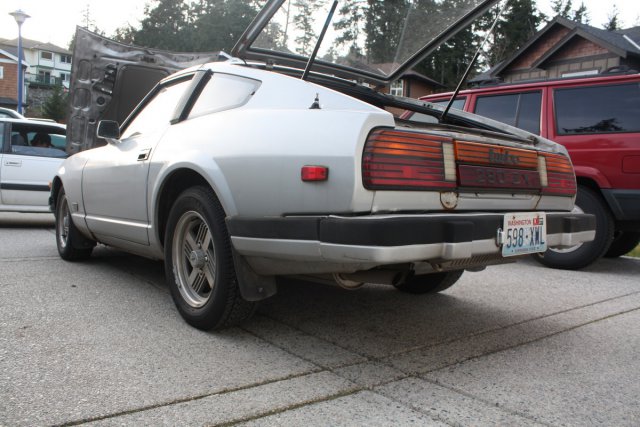

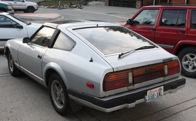

Finally found a 280ZXT 5 speed. I've wanted one for about 18 years now. She's a little rough but not too bad. I was going to use her as a test mule for my NA to Turbo swap on my NA S130 and that's still the plan but I got a little carried away on not fixing her up. Here she is when I first picked her up. Rusty in the strangest spots - below the rear tail lights but solid in the spare tire well. The bottom of the hatch is really rusty but not a big deal - hatches are easy to find and a simple replacement.
