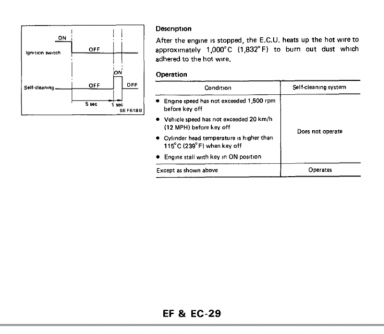

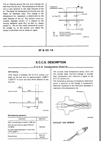

This is interesting. Nissan rewrote the chart for 1987 MAFS self-cleaning operation. Don't know if the chart was wrong or they changed the operation parameters. I'm guessing that the 1984 chart was wrong and/or confusing. You didn't say which Z31 you had so you'll have to draw your own conclusions. Looks like the basic design is that it cleans the wire as long as three conditions are met - engine speed went above 1500 RPM, vehicle speed went above 12 mph, engine not overheating, and engine shut off normally. As soon as the engine is turned off, it waits 5 seconds and cleans for one second. So it looks like you need the speed sensor if you want the self-cleaning to work. -

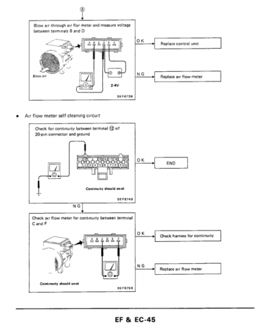

I think that the diagram and test description imply that the ECCS sends 1 second of power through Pin 12 of the 20 pin connector which then passes through pins C and F of the MAFS, to ground. But it may not be full battery voltage so a switch may not work. Best to let the ECCS do it for you. Basically, Pin 12 needs to be connected to either pin C or Pin F of the MAFS. That wire 33 is probably connected to one of those. But it's unclear from the chart if all three conditions need to be met or just one. Looks like all three but who knows. So your question about if you need the speed sensor is still open. -
