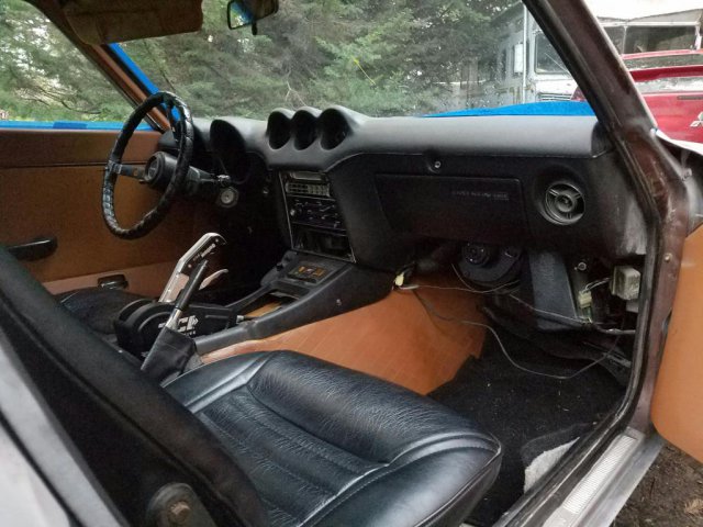

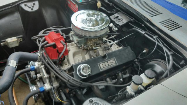

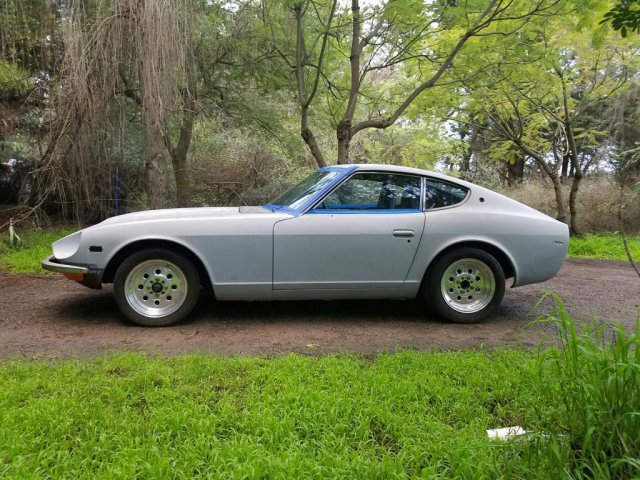

Hey all, I’m a Datsun newbie! Always wanted a 240z/510 project and finally made it happen over the weekend. I picked up the 73 Datsun 250 miles away from home with the “guaranteed to make the drive” from the owner – which it did not but we’ll get to that later. 1973 Datsun with a SBF 306 engine with GT40p heads, single plane intake, 750 Holley HP carb, speedway headers, 3” exhaust, manual valve-body c-4 transmission with SFI bell housing and 9” stall converter, TCI shifter, R200 posi rear end, Meziere water pump. I realize the 750 carb is probably too big, I think its what the PO had around and tuned it work. Motor seems to run strong, starts up pretty easily from a cold start and sounds like a beast. I however am a complete V8 newbie. Here are some pics of the car/engine. I ended up having to tow the car after 40 miles of driving as smoke started to fill the cab, when I pulled over it seemed like transmission fluid was dripping onto the exhaust. Upon examination we found the speedometer (speedometer and tach not hooked up) cable opening was closed with a rubber bushing and a wingnut. I tightened up the wingnut and have taken it for some short trips and it has not leaked yet. So that seems to have fixed the problem. I am not a huge auto guy and would prefer a 5-speed. I don’t even know where to start with wrapping my head around what that would entail. I have 2 large questions at the moment. The first is the transmission which has no transmission cooler – and it not hooked up to the radiator for cooling – is this a problem? The second is the flywheel – it looks like casing was trimmed back for some reason and the flywheel is exposed – is this a problem? Thanks for any help.
