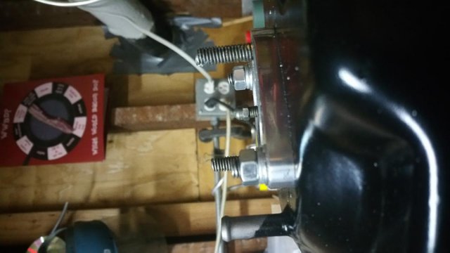

bawfuls Posted August 28, 2018 Share Posted August 28, 2018 (edited) I submit an alternative option for a 1" brake master cylinder upgrade on the S30. The late 90's Toyota Tacoma brake booster has the same bolt pattern as the S30 on the firewall side. With some minor filing/grinding, and chopping about an inch off the brake booster input push rod that connects to the pedal, this booster can be installed in an S30. I do not know the exact range of years, but I used one for a 1997 Tacoma, 2WD smaller engine. This is the smaller booster of the era, at 8.7" diameter (still larger than the stock S30 booster, but it fits in the space fine). Oreilly and Autozone generally have this booster in stock, as a remanufacture (~$200). Then you can get a new 1" brake master cylinder (~$75) meant to mate to the Tacoma booster. Again this was in stock at my local Autozone. The new MC will require fresh brake hard lines for the short run from the cylinder to the distribution junction, since the orientation is different. All in all, slightly more expensive than the upgrade in the OP, but parts are newer and should be more reliable. Also by moving to a slightly bigger booster it helps alleviate some of the increased pedal pressure the 1" MC requires. Edited August 28, 2018 by bawfuls Quote Link to comment Share on other sites More sharing options...

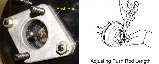

Blobber Posted May 30, 2019 Share Posted May 30, 2019 Does anyone have the original post photos available? I would need the push rod measurement instructions and photos without the tool. Quote Link to comment Share on other sites More sharing options...
