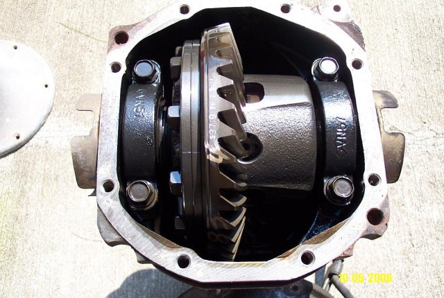

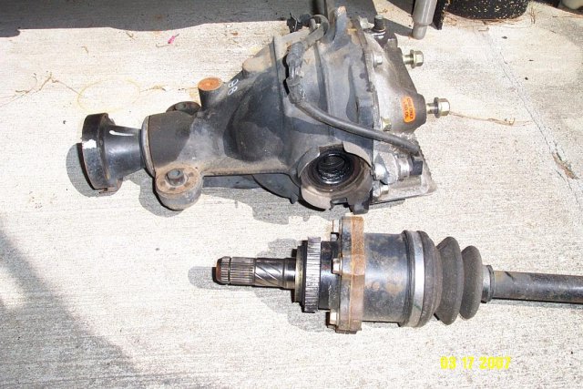

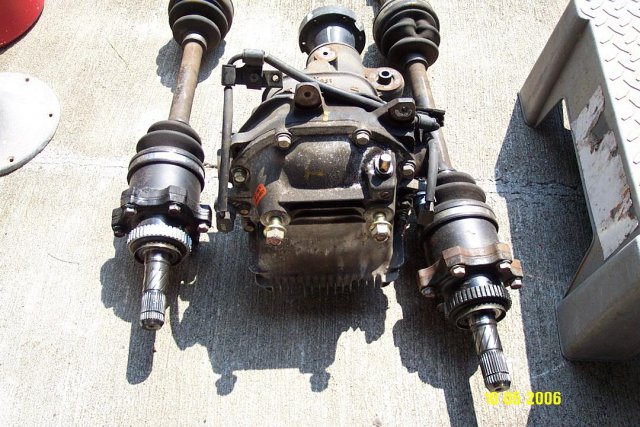

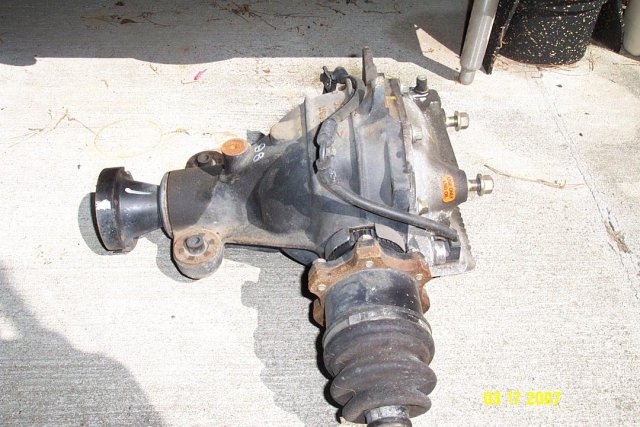

RB26powered74zcar Posted February 2, 2013 Share Posted February 2, 2013 4:11 R200 GT-R clsd short nose (6 bolt axle) diff for me. That paired up with the RB25det 5 spd trans gives me excellent pull. Quote Link to comment Share on other sites More sharing options...

RB26powered74zcar Posted February 3, 2013 Share Posted February 3, 2013 ^^ Did you swap that whole thing in the long nose ? What custom axels did you end up using ? I used it like you see it (just put a different larger oil capacity rear cover on it). MM R230 front diff brace, and their 1/2 shaft center bars. I have a few pics in my sig link below... Quote Link to comment Share on other sites More sharing options...
