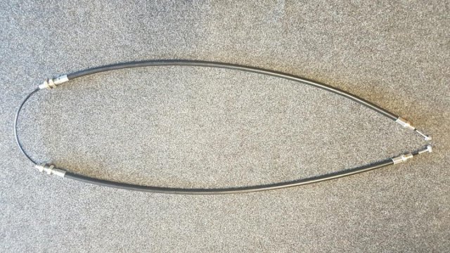

The brand new cable arrived finally....the manufacturer has been difficult to work with, but I was excited when it finally arrived.

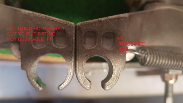

Turns out....The Cable guy decided in his wisdom, to ignore the dimensions I specified on my drawing for the fitting that fits in the Caliper Arm Boss.....he used a standard fitting that is very similar, and just decided that this was good enough ! (Didnt even bother asking me). Needless to say, it didn't fit as the diameter was 2mm too large !. So...in the interest of making some progress and being able to test the system out, I decided to drill out the Hole in the Caliper Arm Boss to suit the new fitting. As you can see from the attached photo, once drilled out, there is very little thickness left, (and therefore strength), and no doubt in time will break off.

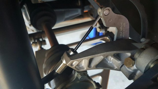

I've attached a few pics.... one showing the modification i had to do (one side modified, the other unmodified...see the difference !), another showing the new cable in its entirety, and another showing how the cable looks when connected to the caliper on the car !
