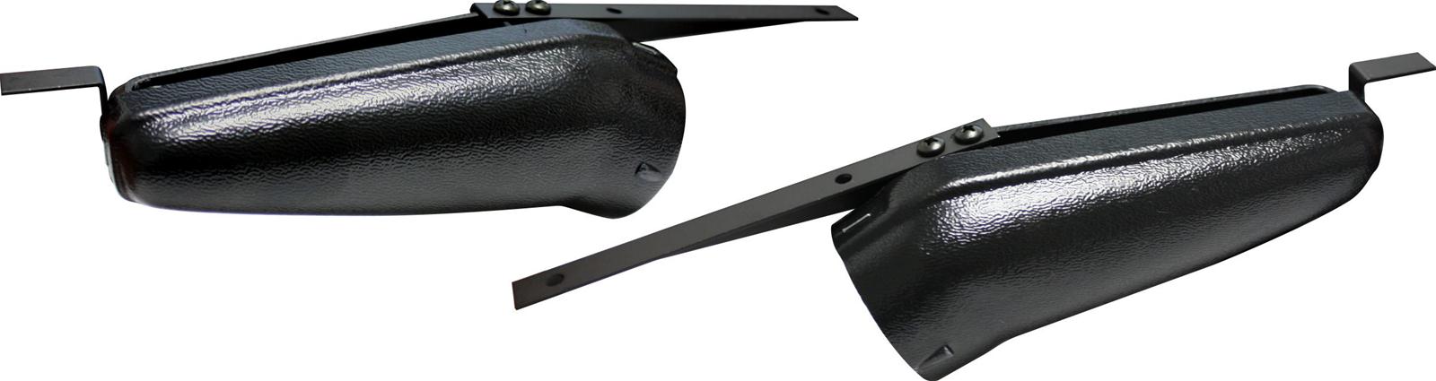

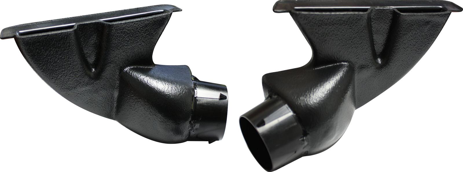

As far as defrost ducts, I'm debating between these two right now.Top  don't seem to have any sort of brackets. I think if I used the bottom ones with the closed side towards the cowl and just modified the brackets slightly I'd get them to line up right where the original holes are in the finish panel.
