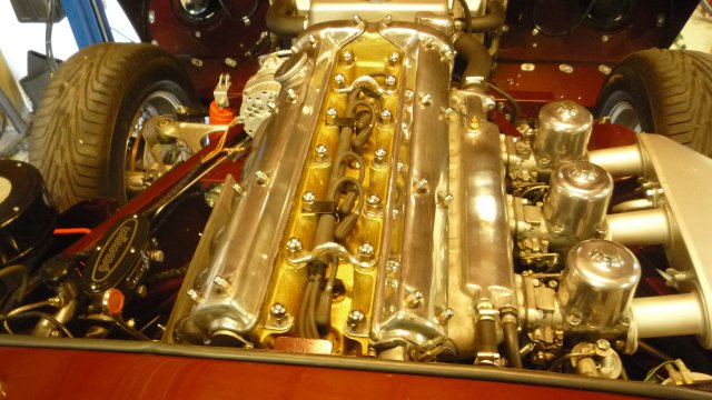

twosigsty Posted January 2, 2019 Share Posted January 2, 2019 On 10/1/2018 at 5:20 PM, tioga said: Seems like the channel in the valve cover is asking for the plug wires to be reversed and the bundle come out the back and over the starter. Then we could better see your valve block and hard lines. that's how I did my Jag 4.2 with EDIS it look much better than over the top of the cam cover. Quote Link to comment Share on other sites More sharing options...
Derek Posted January 2, 2019 Author Share Posted January 2, 2019 Wow that looks great. Are you running one of Ray Livingston's EDIS kits? Quote Link to comment Share on other sites More sharing options...

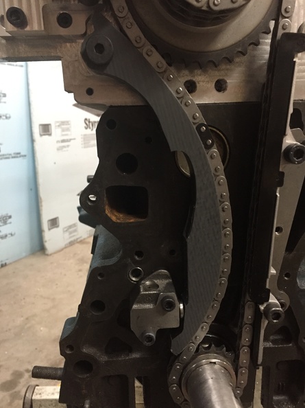

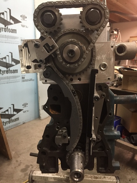

Derek Posted February 20, 2019 Author Share Posted February 20, 2019 There isn't a ton going on since things are starting to settle in as far as design and fab. One thing that has been hanging around is what to do for the lower chain and guide arrangement for the standard height blocks. Although the different setups I tested on the prototype all worked I was never super happy with them. I was trying to use the stock pivoting guide from the KA24 and the 92 link chain but it just wasn't happening. I ended up accepting that I would need to shorten the chain and make a custom guide. I'm no longer intimidated by breaking and relinking a roller chain. It's really pretty straight forward. Making a custom shaped guide allowed me to get the chain fairly tight with the tensioner all the way in. It also allowed me to get the lead in angle I wanted. The guide is made from molly impregnated nylon 6-6. This is the material I used on a fixed guide on the prototype as well as whats on my car currently. Nylon 6-6 has been used as guide material for a while so it's a proven commodity. Here is the final version. Th notch in the back side of the guide provides clearance for the water pump area on the timing cover. Trying to adapt a KA24 guide always required removing a section of that area and welding up a patch. I was never crazy about that and that was what sealed the deal for me as far as producing a guide. This will be my "off the shelf" solution for anyone who doesn't want to engineer their own. As of now 007 and 008 are sold. One is going to New Zealand and the other to Australia. Pretty excited about that for sure. I'll be gearing up for another run soon. Derek Quote Link to comment Share on other sites More sharing options...
