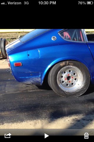

150 0 Posted February 18, 2015 Share Posted February 18, 2015 As you have probably guessed by now, this is another wheel fitment question. Since my Z is completely torn apart, it is really difficult to take measurements. I am going to run TTT coilovers with TTT front and rear brake kit. I don't want to roll my fenders or add flares or any other modifications to the sheet metal. I'm not going to run any crazy negative camber as I've seen on some cars lately (I don't even want to use camber plates). I've seen some cool looking 8x15 -12et wheels which I plan to run on 205/50. It's the -12 that I'm worried about, i've read that it gets really tight against the fenders, especially on the front. I just want to make sure everything is ok before paying. It would suck buying rims, having them shipped all the way here only to have them shipped back (on my expense ) Any help would be great! Quote Link to post Share on other sites

seattlejester 32 Posted February 26, 2015 Share Posted February 26, 2015 15x7 +0 225/50/15. Terrible picture Rubs on the rolled lip on big dips fully loaded, running 1-2 degrees of camber The magic inner number is 8.25 + 4 has a quarter of clearance to the inside if memory serves so you are fine on the inside with the 8 -12. On the outside you might be hanging outside the body a bit, but with the stretch and lower profile you could get by. Quote Link to post Share on other sites
150 0 Posted February 26, 2015 Author Share Posted February 26, 2015 I have 15x8 -14 in the rear, stock body. Had 225/50 but that rubbed a lot, switched to 205/55, much better, but still rubs under heavy compression. Fenders are rolled. Here is a thread with some fitment pics. http://forums.hybridz.org/topic/112524-need-tire-size-help-for-15x8-14-wheels/?fromsearch=1 Nice rims! 15x7 +0 225/50/15. Terrible picture Rubs on the rolled lip on big dips fully loaded, running 1-2 degrees of camber The magic inner number is 8.25 + 4 has a quarter of clearance to the inside if memory serves so you are fine on the inside with the 8 -12. On the outside you might be hanging outside the body a bit, but with the stretch and lower profile you could get by. Thanks for the photo, it's a little hard to tell what they look like from this angle and quality. Isnt 225 on 7" too large? Quote Link to post Share on other sites
