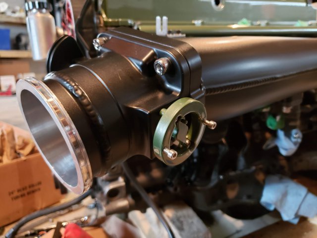

Exposed Posted June 27, 2019 Author Share Posted June 27, 2019 im everywhere with this project really need to focus on one thing. Back from the powder coater, heres a little teaser! Quote Link to comment Share on other sites More sharing options...

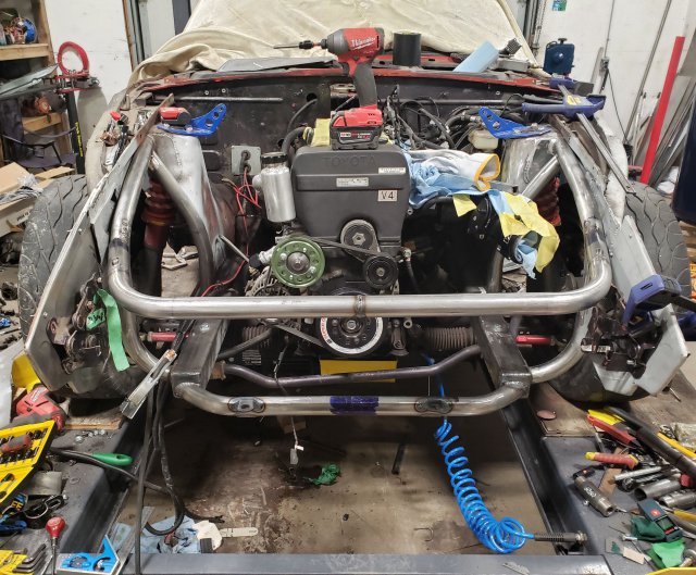

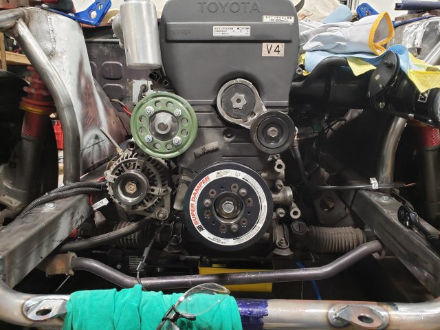

softopz Posted July 2, 2019 Share Posted July 2, 2019 (edited) Does that intake clear inner fender? Specifically throttle body/tps. Mine is hitting needs to be either clocked 90 put cable from top of manifold, cut out/bang fender/shock tower, or change angle of the flange at intake side. Thats for me with 2jz, cx mounts(altered them to have motor in the middle though. Dont know about if you fitted before or not. Edited July 2, 2019 by softopz Quote Link to comment Share on other sites More sharing options...

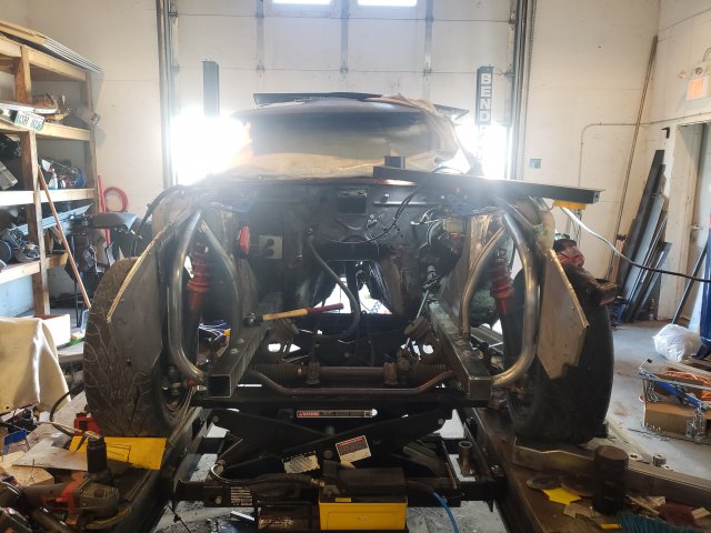

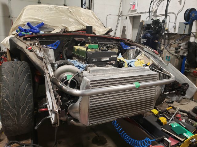

Exposed Posted July 3, 2019 Author Share Posted July 3, 2019 (edited) @softopz havent tried to put it in the engine bay yet, going to test it this weekend hopefully. Fingers crossed I dont have clearance issues, im not running CX mounts. he's a pic of how the car sits as of monday. Worst case I cut the car apart again and sell it to the scrap yard..... Edited July 3, 2019 by Exposed Quote Link to comment Share on other sites More sharing options...
seattlejester Posted July 3, 2019 Share Posted July 3, 2019 That is a point, with my motor placement I think I had 9 inches and the first runner was like 11 inches out. Hence the tubular FFIM on my car. Quote Link to comment Share on other sites More sharing options...

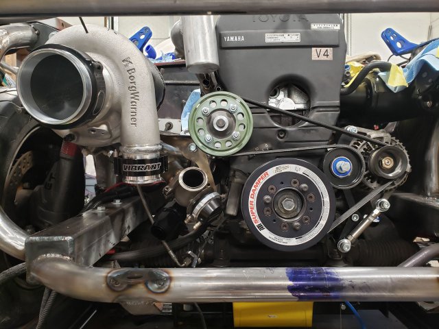

Exposed Posted July 19, 2019 Author Share Posted July 19, 2019 I ended up putting the engine in today. Good news is it clears it by half an inch! Quote Link to comment Share on other sites More sharing options...

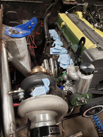

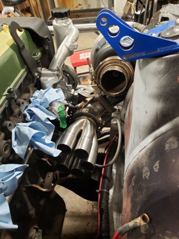

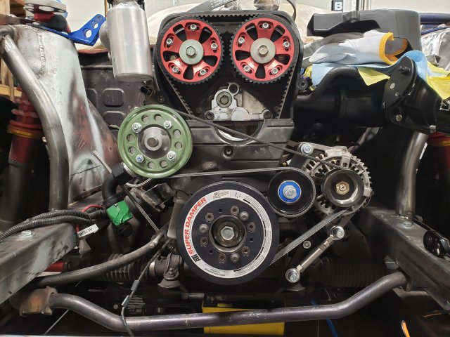

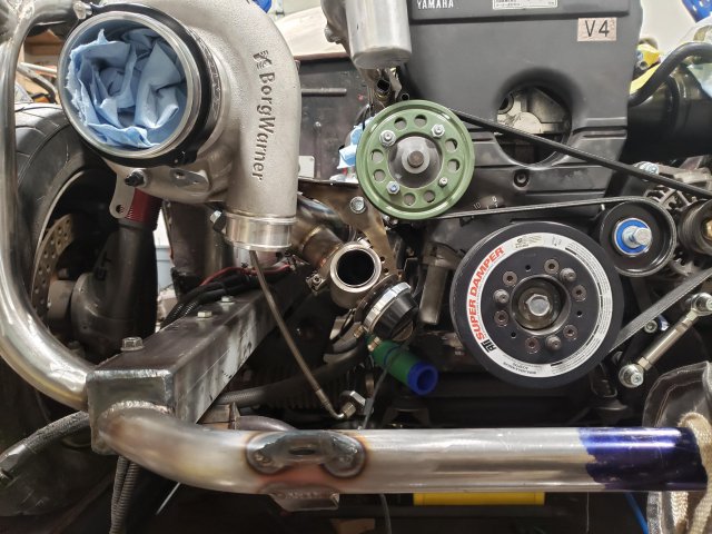

Exposed Posted August 24, 2019 Author Share Posted August 24, 2019 Haven't had to much time to plug away with work being as busy as it is and wrapping up home renovations. On the fence about mounting the turbo and snipping the hood or mounting the turbo lower and leaving the hood as is. I ended up moving the alternator over just incase I want to bring the turbo lower. Next step, modify the lower waterneck outlet and bring it as close to the block as possible. For the guys who upgraded to a single turbo has anyone braced the turbo back to the block or frame of the car? Quote Link to comment Share on other sites More sharing options...
seattlejester Posted September 4, 2019 Share Posted September 4, 2019 I've heard mixed about bracing, like since the pipes are expanding bracing can cause fractures from the tension caused by fixing the turbo flange in place in respects to the expanding pipes. Not that continually expanding and shrinking pipes with a weight on it would fare much better. Part of why I went with the heavy SS cast manifold. Quote Link to comment Share on other sites More sharing options...

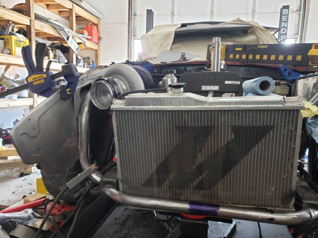

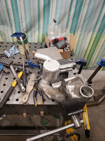

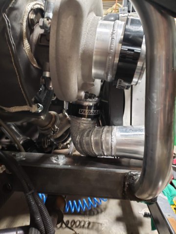

Exposed Posted September 7, 2019 Author Share Posted September 7, 2019 Ended up making a brace to the block that's able to support the weight of the turbo, fingers crossed it doesn't crack on me. Will also be modifying the water neck outlet to pass below the waste gate. Quote Link to comment Share on other sites More sharing options...

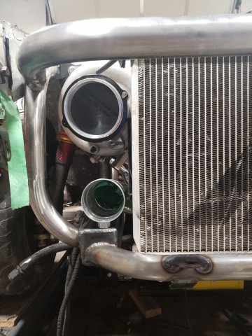

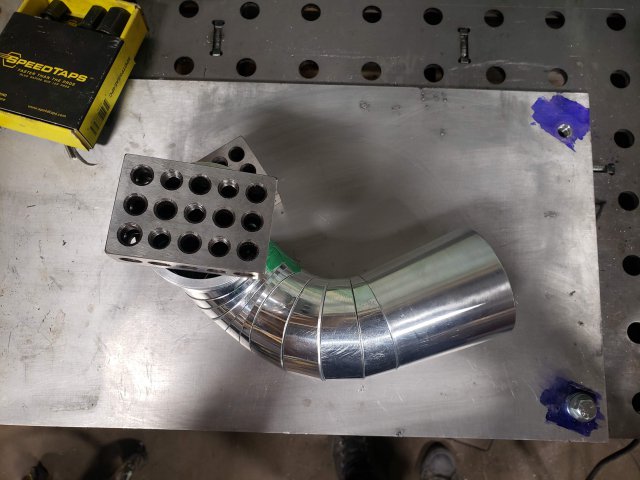

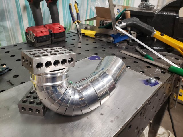

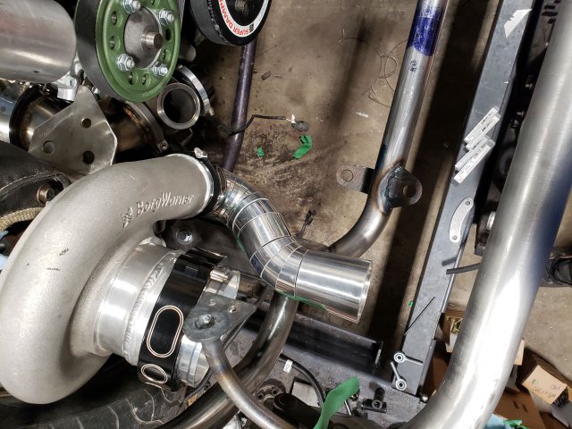

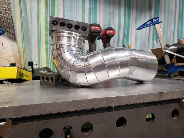

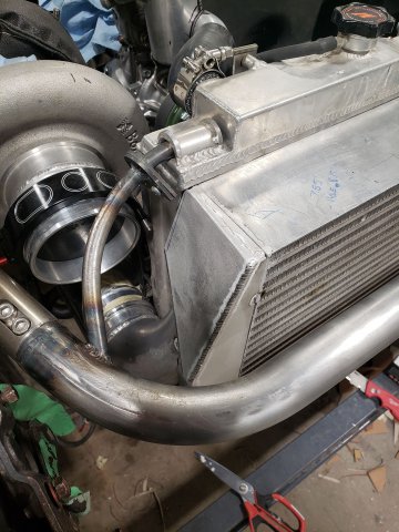

Exposed Posted September 20, 2019 Author Share Posted September 20, 2019 (edited) one side of the plumbing is almost done. Edited September 21, 2019 by Exposed Quote Link to comment Share on other sites More sharing options...
seattlejester Posted September 24, 2019 Share Posted September 24, 2019 Goodness gracious, please time that and tell us how long that takes! Quote Link to comment Share on other sites More sharing options...

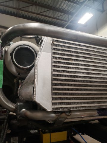

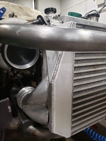

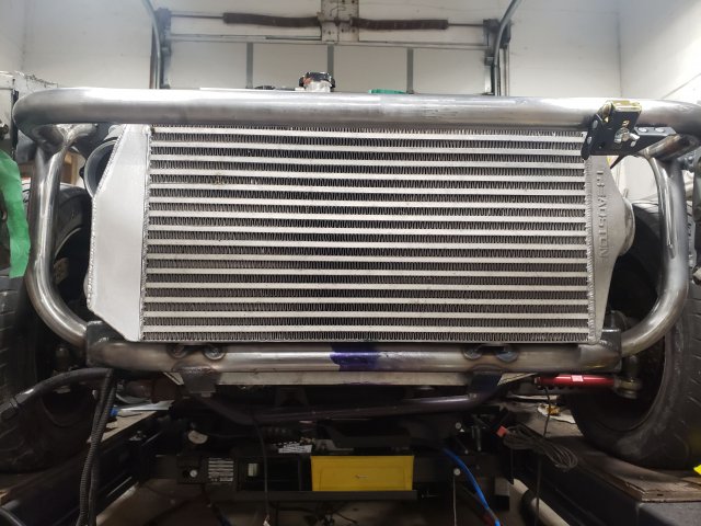

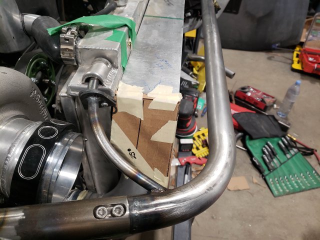

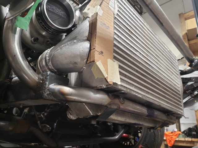

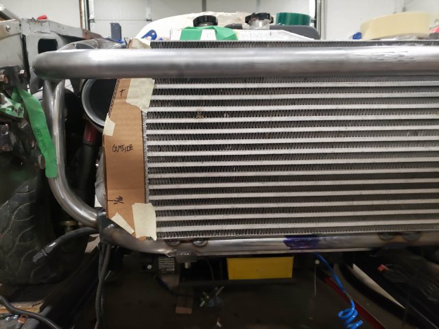

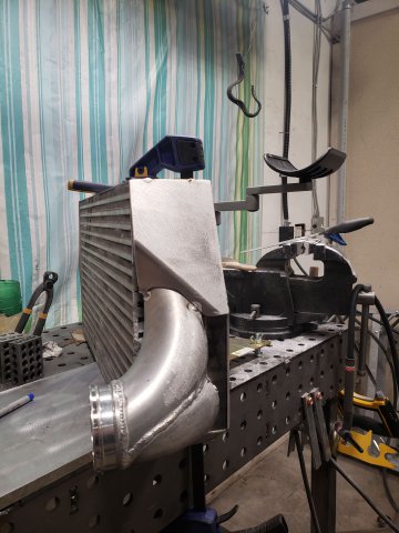

Exposed Posted September 24, 2019 Author Share Posted September 24, 2019 lol I think it took me 4 hours, that includes farting around on some other stuff. Ended up cutting off the end tanks on the intercooler and started my cardboard template. Quote Link to comment Share on other sites More sharing options...
1969honda Posted September 26, 2019 Share Posted September 26, 2019 That looks miserable, nice twists and turns though! Quote Link to comment Share on other sites More sharing options...
HuD 91gt Posted September 27, 2019 Share Posted September 27, 2019 4 hours? All that welding would have taken me 2 days! Lol Quote Link to comment Share on other sites More sharing options...
Exposed Posted September 27, 2019 Author Share Posted September 27, 2019 @HuD 91gt it felt like a life time. Hoping to find some time this weekend to plug away on the end tanks. Quote Link to comment Share on other sites More sharing options...

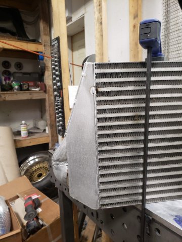

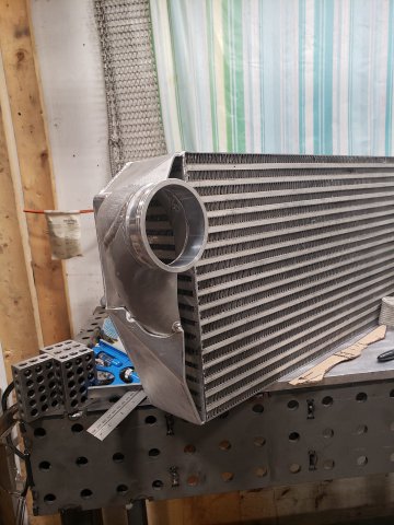

Exposed Posted November 10, 2019 Author Share Posted November 10, 2019 finally found some time to begin working on one of the intercooler end tanks, mocked it up in CAD before starting, then got to work. Quote Link to comment Share on other sites More sharing options...
Exposed Posted November 10, 2019 Author Share Posted November 10, 2019 (edited) picture overload . Edited November 10, 2019 by Exposed duplicated a picture Quote Link to comment Share on other sites More sharing options...

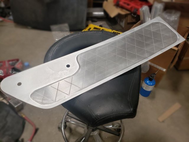

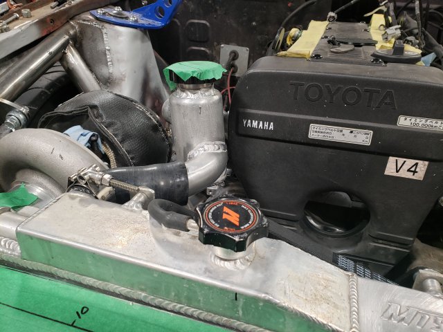

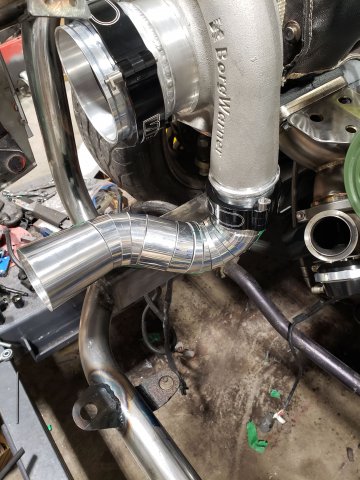

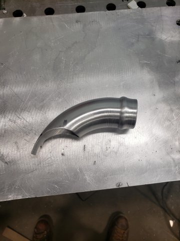

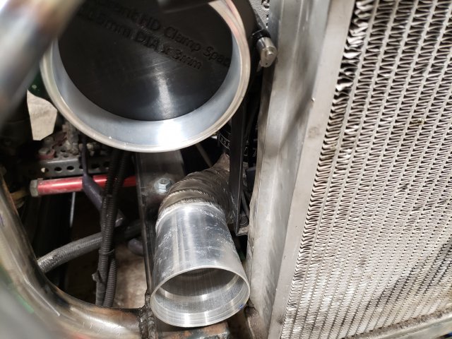

Exposed Posted December 5, 2019 Author Share Posted December 5, 2019 finished up the passenger side end tank and also finished the upper radiator hose connection. I 3d printed a couple dies for my bead roller and put a bead on a piece of 1.5" dia. tube, tube was cut from 90. Quote Link to comment Share on other sites More sharing options...

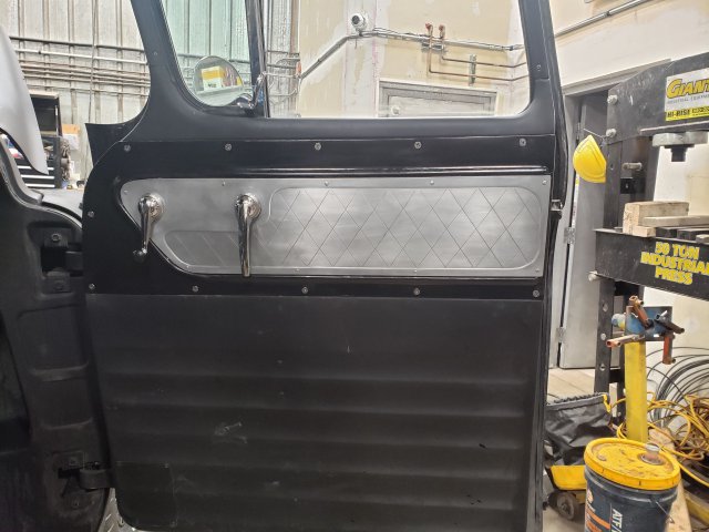

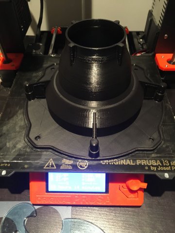

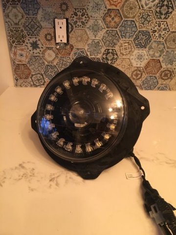

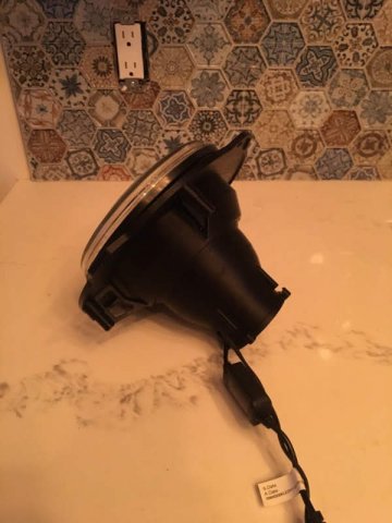

Exposed Posted December 5, 2019 Author Share Posted December 5, 2019 Had a bit of time on my hands two weeks ago, had been waiting on the old ladies water to break. I have a headlight bucket that has seen better days, decided to try something different out, I couldn't source anything newer. Current prototype print is PLA settings are 210 at the nozzle and 60 at the bed. 20191125_235035.mp4 also got a bit more practice laying some beads as well, this is for a 59 chevy. Quote Link to comment Share on other sites More sharing options...
