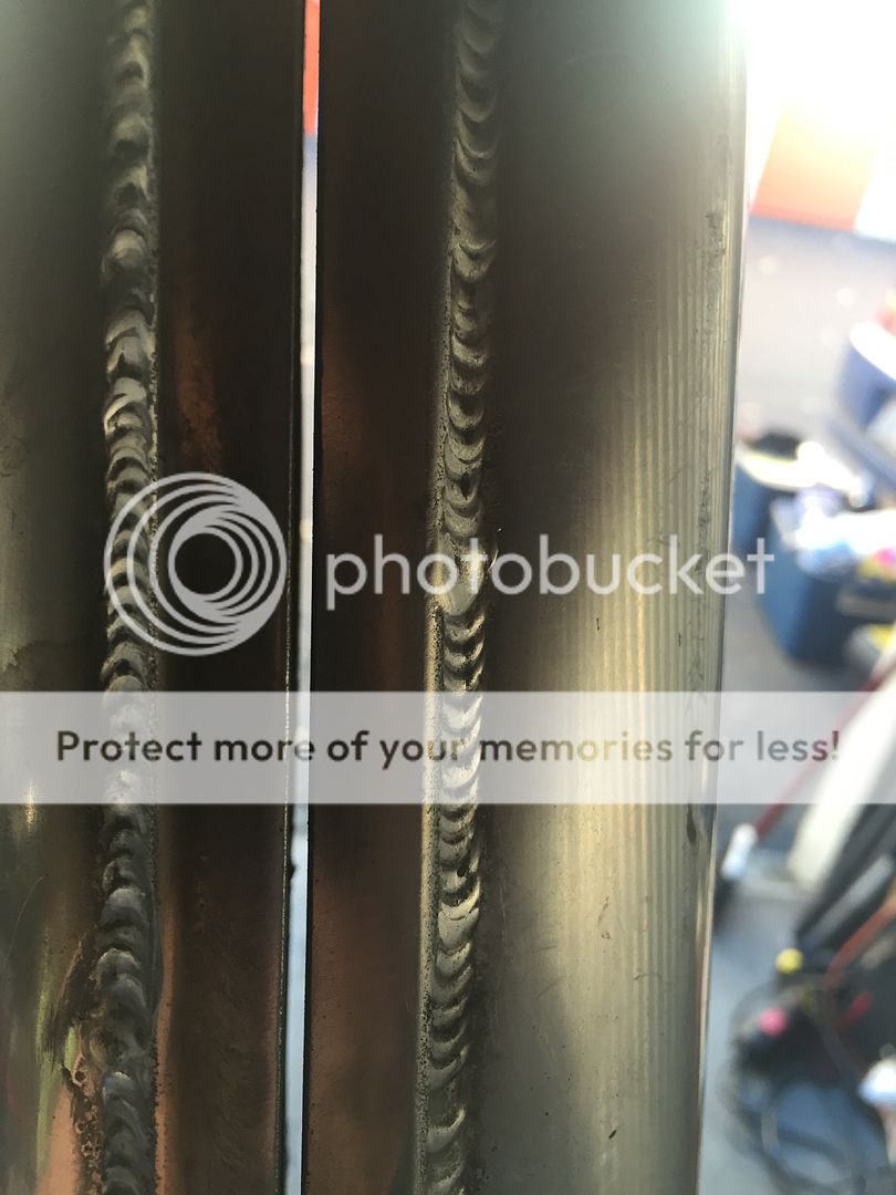

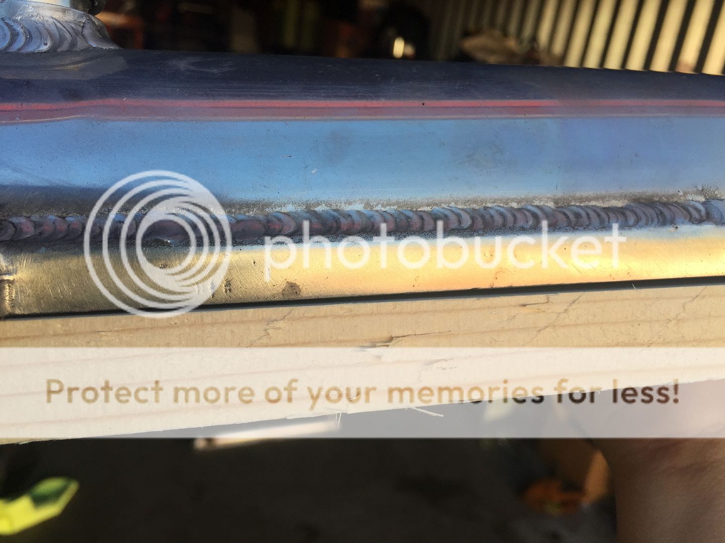

Not quite as bad as I recall.
12E0FE74-EC47-4713-9BF0-D225FDFCED7F_zps
99E9F33A-1991-4E58-A296-2EDD2B582D21_zps
Maybe a 1/16 on the edges coming to about 1/8 in the middle
Once again the caveat is that this is a valley style gasket, the gasket itself has a bit of protrusion. I think it really will seal, I was just hoping for some kind of input into maybe relaxing it a bit. The story is that it was bolted to a jig when it was made and then a coilpack mount was welded in after the fact to connect them. I'm guessing it warped when that was done.
I think I'll just go with newzed's solution. Maybe I can find a spare head to bolt it onto without the gasket to kind of gauge how far the center will go down.
Bought on craigslist, and I quite like these, they don't really make this kind of stuff for my engine, so I would like to make it work.
