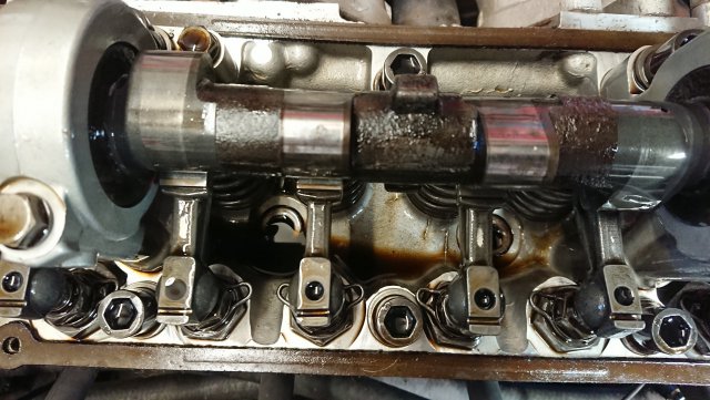

jonbill Posted July 20, 2019 Share Posted July 20, 2019 Hi, I've been running a. 585 lift 307/8 duration cam for 3 years now (8 or 9k miles). A couple of the lobes have just started to lose material from near the tips. And I'm looking for how to avoid when I fit a replacement copy of the cam. The cam is reground from an oiled 1981 f54 l28. I have Schneider 68025 springs with a seat pressure = 125 lb ( I think) Are the seat pressures too much? I could swap for 68022 springs at 110lb. Should I use a spray bar too? Was I just unlucky or used the wrong zddp additive this year? Thanks for any pointers. Jon Quote Link to comment Share on other sites More sharing options...

zbloke Posted July 21, 2019 Share Posted July 21, 2019 Do the couple of lobes that have lost material look like they've been overheated? if they do are the oil ways partially blocked or could the original hardening depth be thin where the cam was re-profiled? Quote Link to comment Share on other sites More sharing options...
jonbill Posted July 22, 2019 Author Share Posted July 22, 2019 9 hours ago, zbloke said: Do the couple of lobes that have lost material look like they've been overheated? if they do are the oil ways partially blocked or could the original hardening depth be thin where the cam was re-profiled? Thanks. There's no discolouration, just missing material, so assume not overheated. Oil holes are definitely clear. Could be thin hardened depth, I'm ignorant of any treatment applied to cams TBH. Quote Link to comment Share on other sites More sharing options...

jonbill Posted September 6, 2019 Author Share Posted September 6, 2019 Thanks. My engine I suppose got to about 6 or 7k miles before I discovered this wear. I've always used zddp additive with decent synthetic oil. I've had the cam repaired and discussed the springs with the cam grinder/repairer and others and consensus is that the schneider 68025 springs are a little too stiff for the L engine rocker arm setup; I probably have near 300 lb pressure at full lift with them. So I've bought some 68022 which are in the right range. I'll also be stripping the engine down and drill the block oil jet out to 3mm over the winter. I'm hoping those two changes should see it good for many more miles. Quote Link to comment Share on other sites More sharing options...
