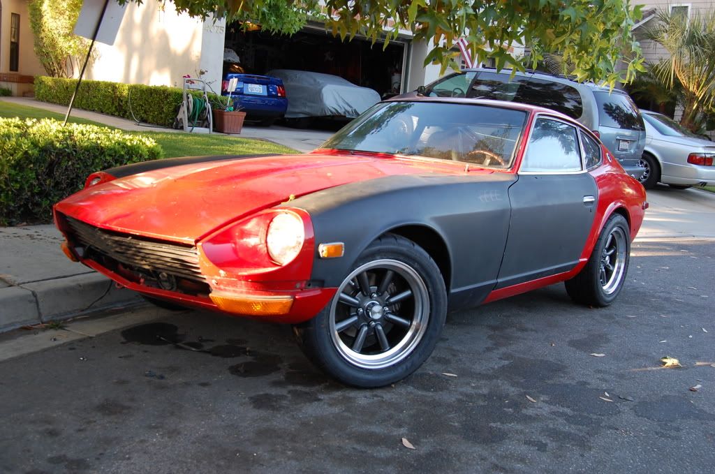

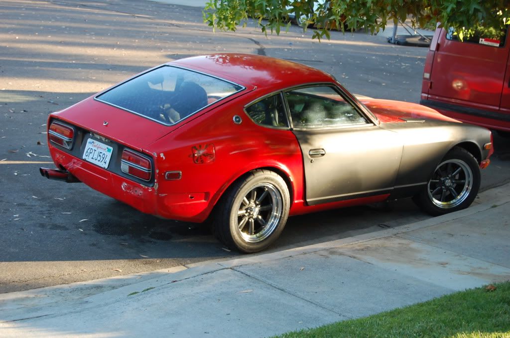

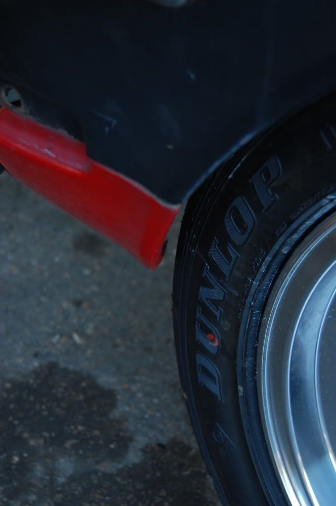

Fuzzydicerule Posted June 7, 2011 Share Posted June 7, 2011 16x7 0 offset Konig Rewinds with 225/50ZR16 Dunlop Direzza Z1 Starspecs. The tires are a bit tall, but i like the look, i just need to trim the front lower valence for clearance. Fronts have a 5 Millimeter spacer to clear the 4 piston brake upgrade Keep in mind, the car is an unfinished project. Rear shot, the door isnt fully closed, but yes, its misaligned. clearance between tire and valence, this is the drivers side, the passenger side actually touches... Quote Link to comment Share on other sites More sharing options...

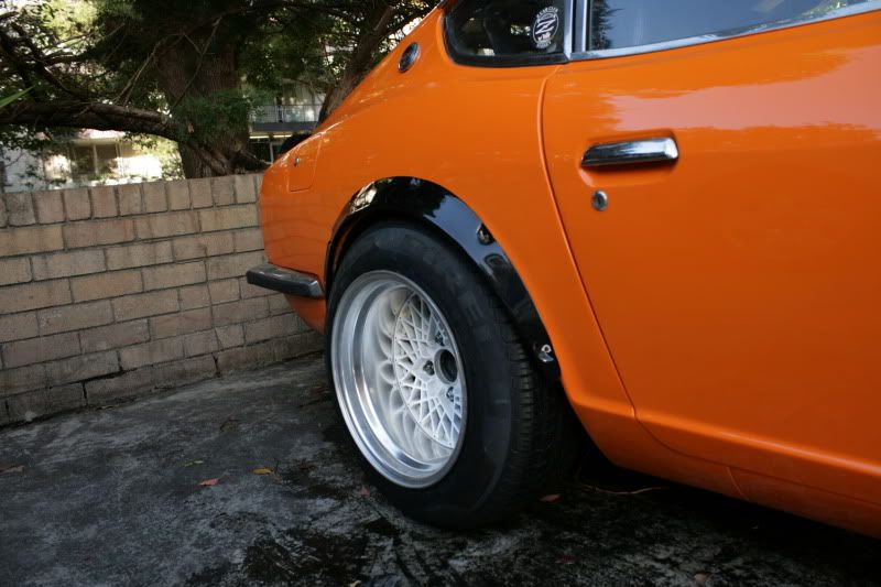

LoneStarS30Z Posted June 8, 2011 Share Posted June 8, 2011 (edited) 15x8 -26 15x10 -26 225/50/15 all around. No markings at all on the wheels, so not sure what brand, but look to be Enkei 92's? ZG flares aren't wide enough, got BAMF flares waiting for install one day. Edited June 8, 2011 by LoneStarS30Z Quote Link to comment Share on other sites More sharing options...
VenomousType Posted June 9, 2011 Share Posted June 9, 2011 do you have some down the side shots of your ride, lone? id like to see how far they go past the regular ZGs... Quote Link to comment Share on other sites More sharing options...
LoneStarS30Z Posted June 9, 2011 Share Posted June 9, 2011 Sorry this is the best I've got right now, I bet it would tuck a bit better if I had coilovers and the ability to add some camber, but the bamf flares should work just fine. If I remember I'll try to grab a better angle when I get the chance. Quote Link to comment Share on other sites More sharing options...
