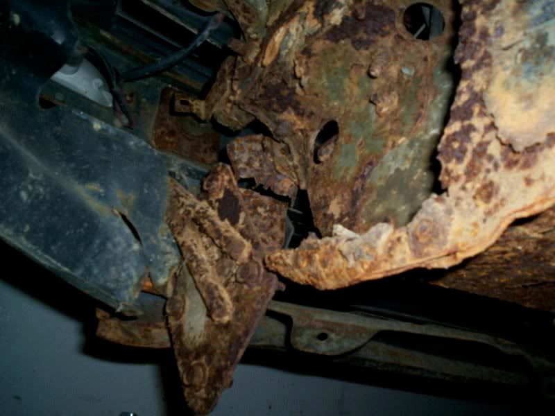

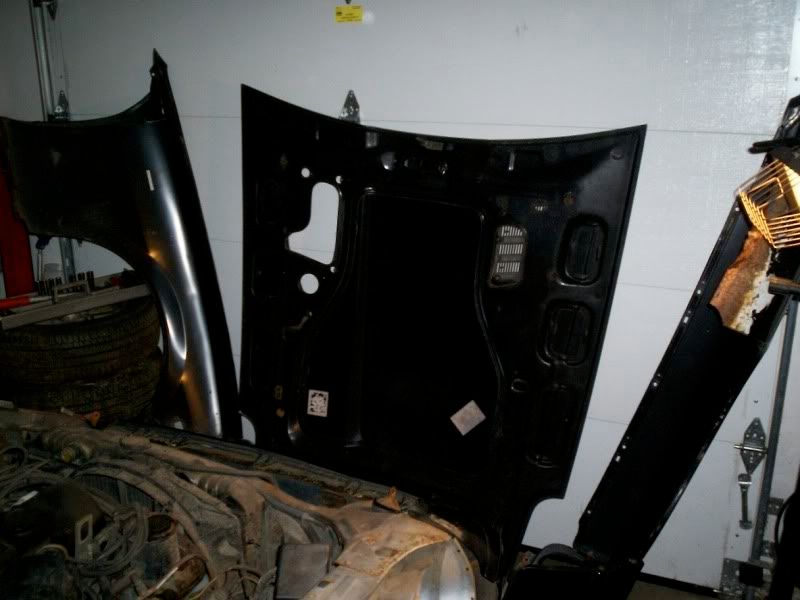

Sadly the rot on the floors and frame rails makes the car itself un-salvageable. I'm picking up the car this friday, moving my car outta the garage and the ZX in. I should have it completely parted out the same day and towed out the next day.

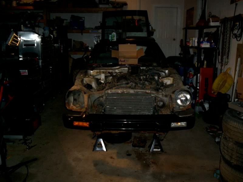

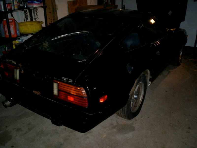

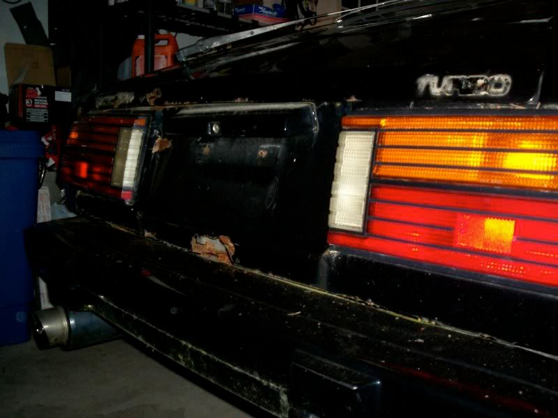

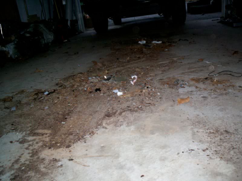

Took some pics of this week's mayhem. Wow this car was a rotbox! I definitely plan on thoroughly going through the engine now. Hopefully it won't need a full rebuild, just new gaskets and seals and a lot of cleaning. On to pics:
Had to grease the flatbed truck to shimmy the car off because 3 of the 4 calipers were seized. Removed them and pulled the car in the garage.

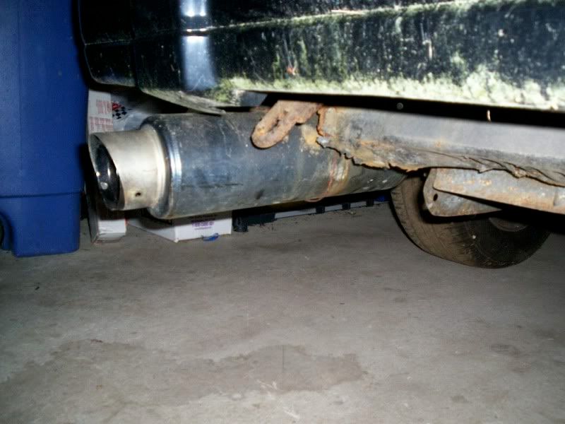

Tow hooks ripped clean off!
Shoved my hand right through the license plate section there, lol

At least it had a mad tyte JDM y0 exhaust!

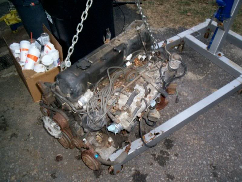

Got the engine up on the stand and started taking it apart. I also picked up an R200 CLSD out of a Z31 turbo with 100k on it for a good price. I'm piecing together the other necessary parts to install the differential. So far I've spent more money on drivetrain parts than anything else! Never knew just how expensive it would be...
