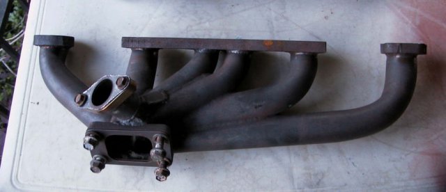

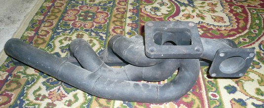

I believe the below header designs would satisfy the majority of everyone's requirements. Notice the beautiful welds and how the tubes transition from round to rectangular in the first design. Although not equal length, they are not a log style and should accommodate A/C. The multifit T4/T3 flange would work for T3 folks but the T4 folks would sacrifice because the ID of the flange would still be T3. At least it looks that way to me. Also, I definitely do not want stainless. I think they are much more prone to cracking.
Example Header #1
6669_thumb.attach
Example Header #2
