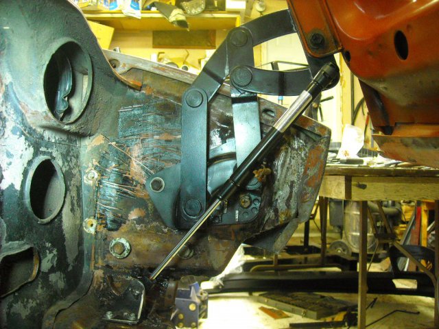

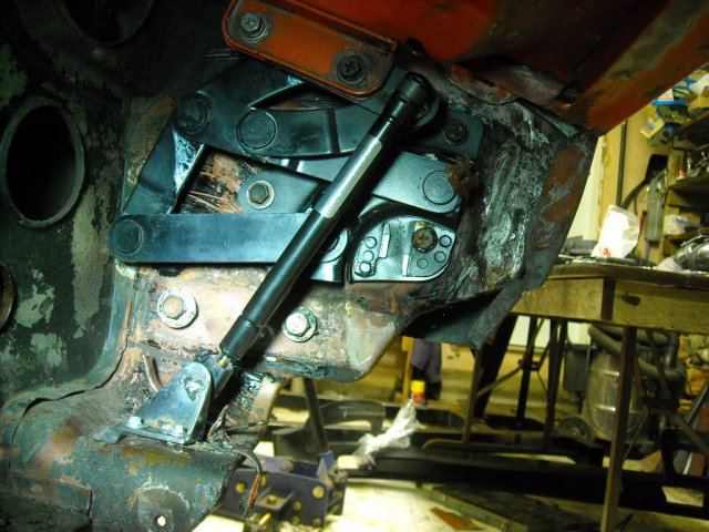

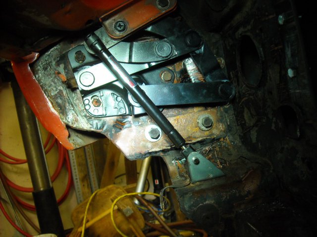

Awesome!  Love the battery box idea - I was thinking about something similar, but yours is a much cleaner design. Looks great.
Would you be willing to share what struts you went with for the hood?  Size & force?

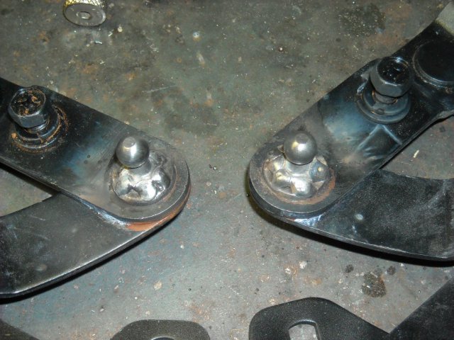

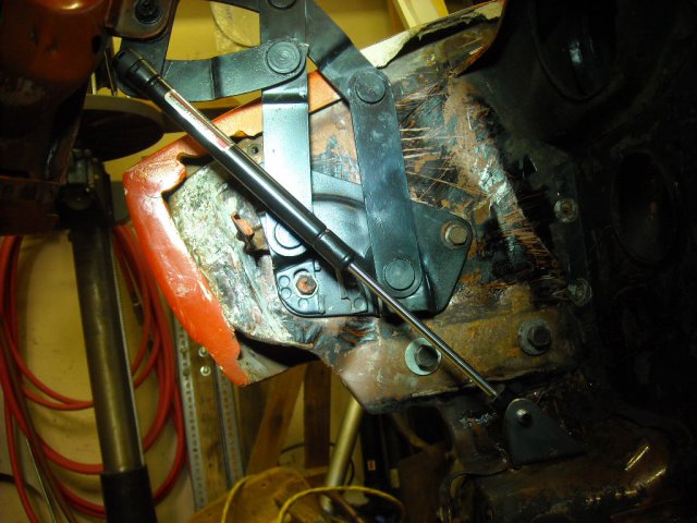

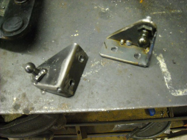

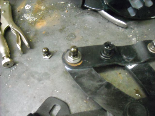

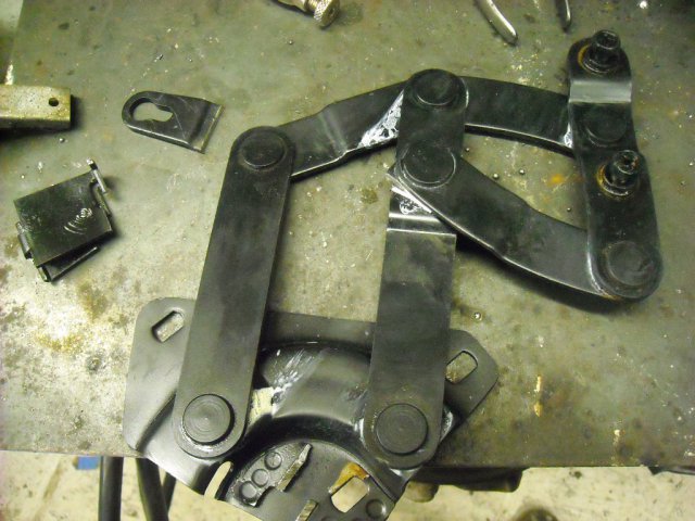

Strong Arm 4477N10 Gas Charged Lift Support 10176N10W
I ordered 2 of these from these guys, https://www.liftsupp...orts-10176n10w/ and a pak of 4 ball studs, the struts are 43lb and hold the hood any position 16" or higher, below that and the weight of the hood takes over and it closes. I'm pretty happy with it, here are a few more pics,

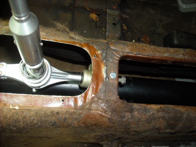

Posted 16 November 2016 - 02:50 PM

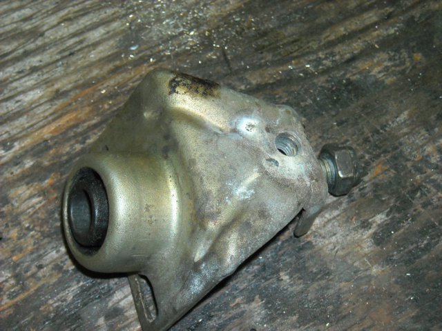

Someone was asking for pics of the shifter are bushing so I'll just add them here,
Attached File  DSCN0709.JPG   233.49KB   0 downloadsAttached File  DSCN0710.JPG   236.46KB   0 downloadsAttached File  DSCN0712.JPG   233.42KB   0 downloads

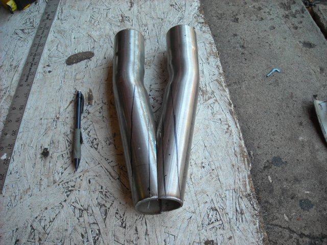

Posted 27 November 2016 - 03:59 PM

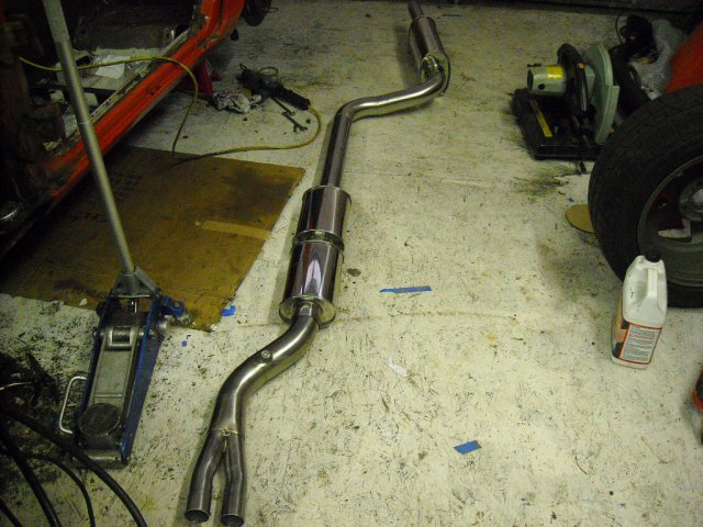

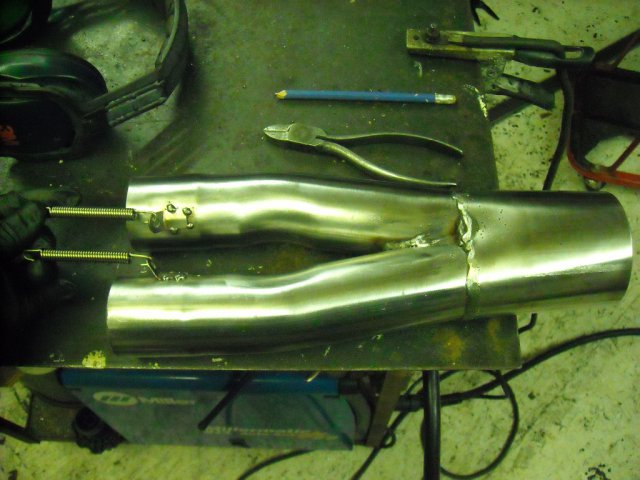

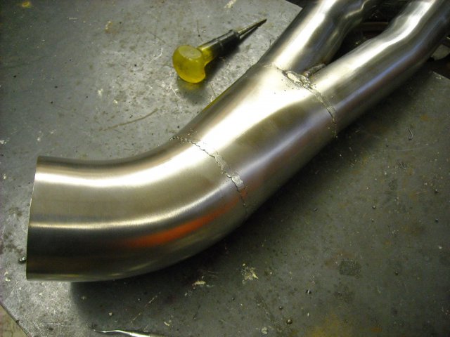

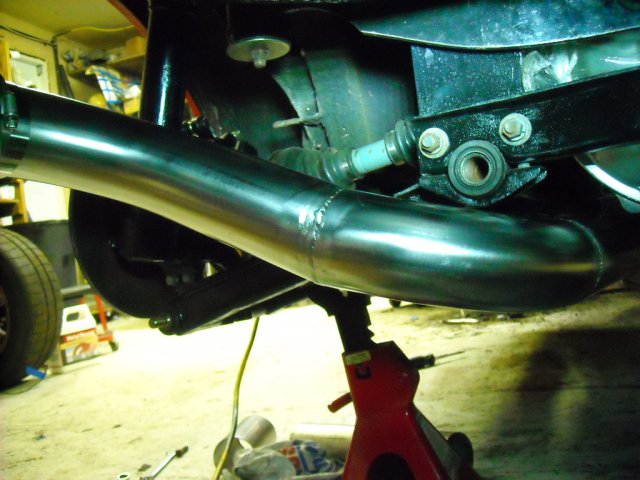

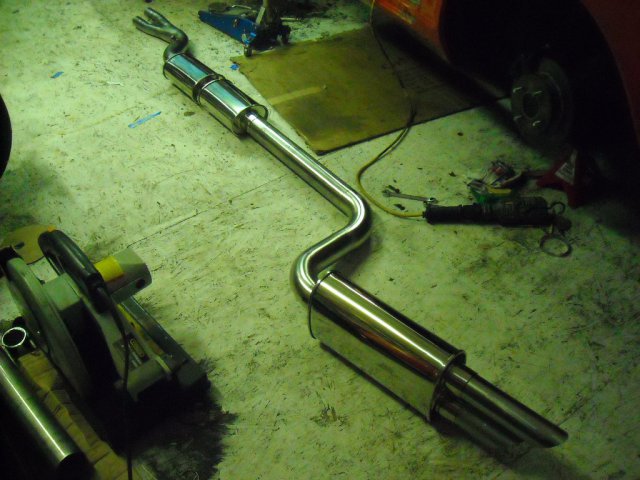

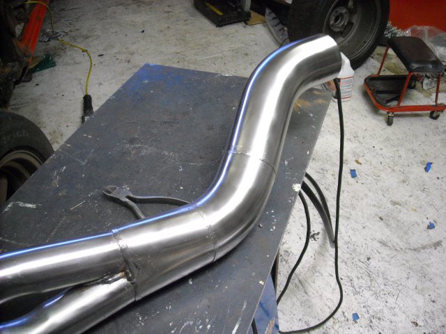

Got the exhaust system built, welded and hung last week, hopefully it won't be too loud but I really wanted to eliminate the back pressure that the stock exhaust had.
The whole system is from Vibrant, 2 Ultra quiet straight through resonators welded together, 1in 2out ultra quiet straight through muffler, 4 mandrel bent 3" pipes and the collector I made.
Attached File  DSCN0716.JPG   221.75KB   0 downloadsAttached File  DSCN0720.JPG   233.13KB   0 downloadsAttached File  DSCN0728.JPG   232.59KB   0 downloadsAttached File  DSCN0730.JPG   224.43KB   0 downloadsAttached File  DSCN0739.JPG   231.32KB   0 downloadsAttached File  DSCN0742.JPG   214.53KB   0 downloadsAttached File  DSCN0743.JPG   228.6KB   0 downloads

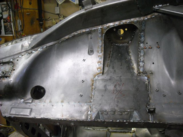

Posted 14 December 2016 - 04:28 AM

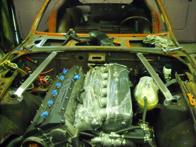

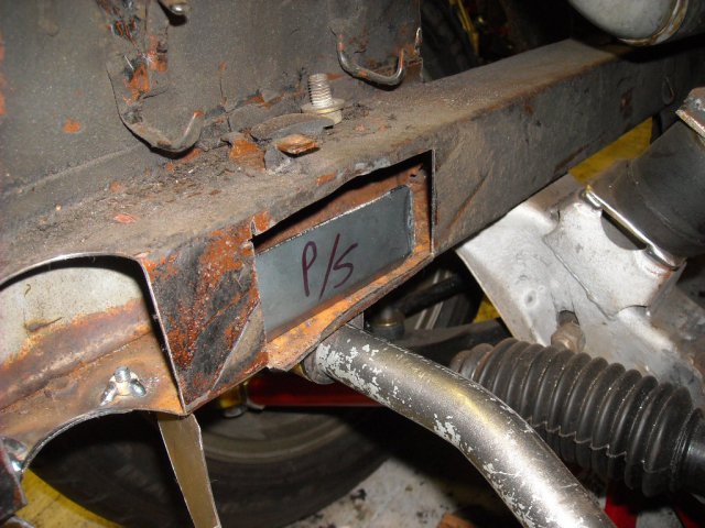

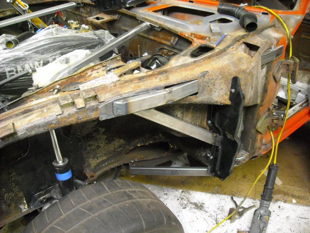

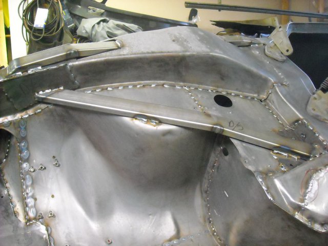

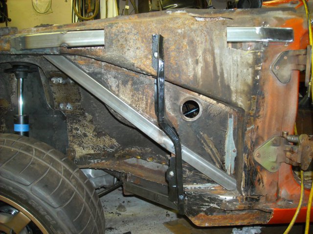

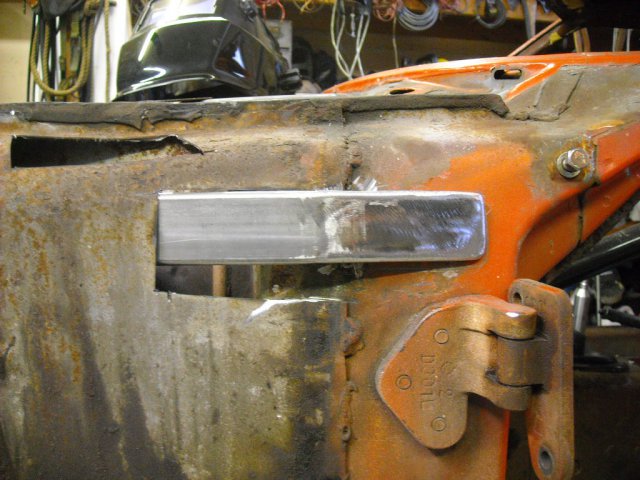

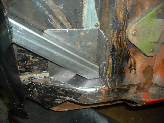

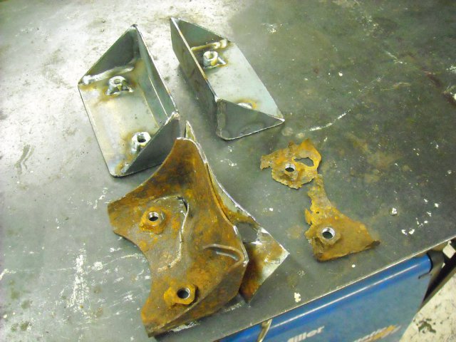

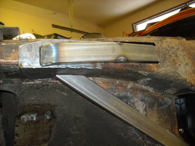

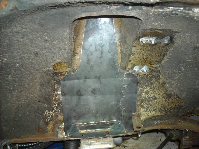

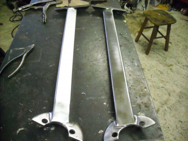

This is what I have been working on in the last couple weeks, because this engine is so tall I have no room to install a shock tower brace so will be adding some internal hidden bracing that should help stiffen things up. Nothing is welded in yet, just test fitting for when the car comes back from the acid dip.Attached File  DSCN0859.JPG   231.12KB   0 downloadsAttached File  DSCN0812.JPG   231.55KB   0 downloadsAttached File  DSCN0828.JPG   231.58KB   0 downloadsAttached File  DSCN0866.JPG   231.08KB   0 downloadsAttached File  DSCN0850.JPG   230.13KB   0 downloadsAttached File  DSCN0853.JPG   225.02KB   0 downloadsAttached File  DSCN0861.JPG   223.85KB   0 downloadsAttached File  DSCN0806.JPG   230.14KB   0 downloadsAttached File  DSCN0803.JPG   231.5KB   0 downloadsAttached File  DSCN0867.JPG   234.18KB   0 downloadsAttached File  DSCN0839.JPG   231.32KB   0 downloadsAttached File  DSCN0863.JPG   230.3KB   0 downloadsAttached File  DSCN0864.JPG   231.91KB   0 downloadsAttached File  DSCN0748.JPG   216.54KB   0 downloads
#52 1969honda
1969honda
    Always Here
  • Donating Members
  • PipPipPipPip
  • 358 posts
  • LocationNear: Logan, Utah, United States
Posted 14 December 2016 - 05:36 AM
Nice, I like that approach! I have yet to figure out the real height my engine will sit at, but I'm guessing with a supercharger and intercooler on top I'll be looking to do something similar. Keep up the good work and pictures, welds look really nice.

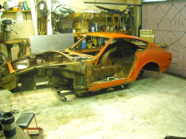

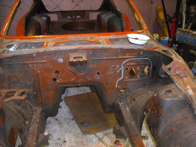

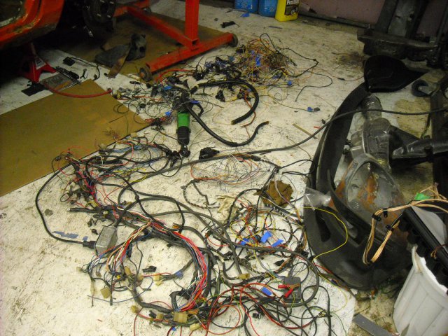

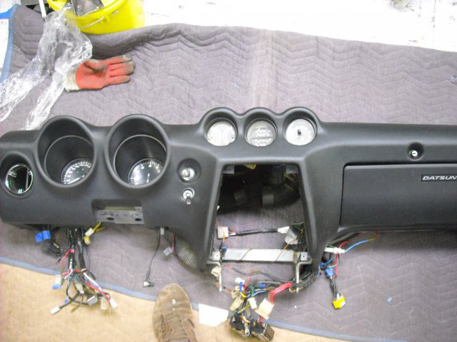

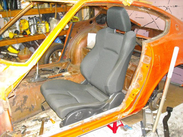

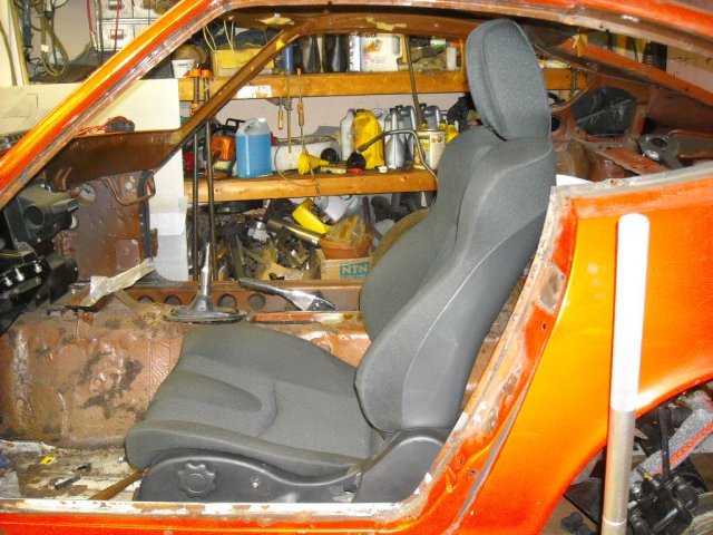

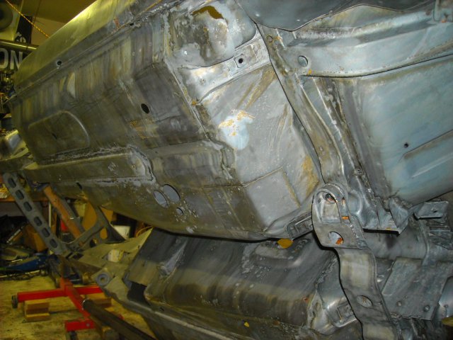

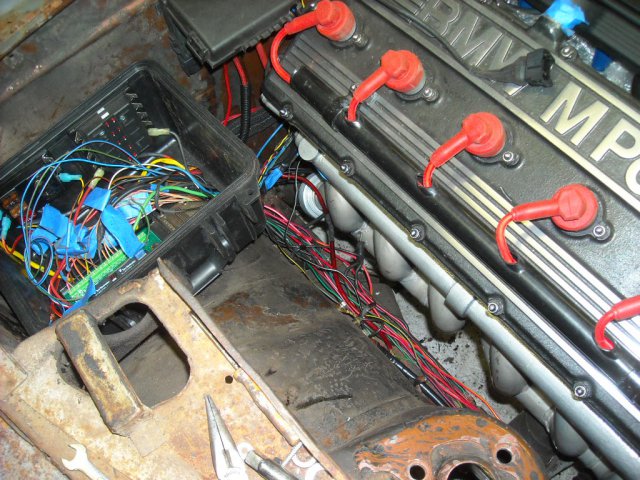

Been busy, have now completed all the work that needed doing before the acid dip, all the patches and bracing have been made, 350Z seats installed,  intergrated the Datsun and bmw wiring harnesses, ran a complete electrical test for all lights and megasquirt system, dash is complete now with the new gauges and wiring, all new brake, clutch and fuel lines have been built and the rotisserie is ready spin.
Just have to lower the car onto the dolly and have it towed to the dippers. I'm hoping they will let me take some pictures of the car being lowered into the boiling acid bath but won't be surprised if there is some bs legal policy preventing it.
Attached File  DSCN0946.JPG   231.4KB   0 downloadsAttached File  DSCN0949.JPG   224.24KB   0 downloadsAttached File  DSCN0971.JPG   217.33KB   0 downloadsAttached File  DSCN0973.JPG   225.91KB   0 downloadsAttached File  DSCN0985.JPG   232.52KB   0 downloads
This is what is left of the two harnesses that didn't make the cut
Attached File  DSCN1009.JPG   223.96KB   0 downloads

Attached File  DSCN1031.JPG   227.31KB   0 downloadsAttached File  DSCN1050.JPG   228.71KB   0 downloadsAttached File  DSCN1052.JPG   233.65KB   0 downloads
Stripped and ready for a well earned bath
Attached File  DSCN1054.JPG   232.93KB   0 downloads

Looking amazing! Are the hood hinges stock and you just added the lift shocks?

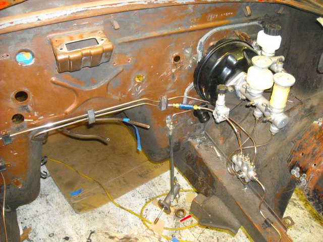

Posted 05 February 2017 - 09:20 AM

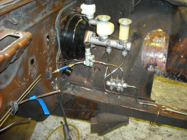

Nice looking brake lines!
Thanks, yes stock hinges

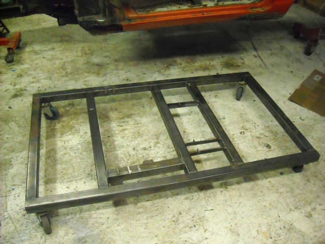

It is this stuff I got from fedhillusa.com, it is called Cunifer brake line from Britain, It is a copper/nickle/steel alloy and is just the best stuff to work with, I didn't even use my tube bender the line is so easy to bend I just used bare hands. It takes nice tight corners and with just a bit of 0000 steel wool it comes up gleaming shiny. They sell it in 25ft rolls which is just enough to do all new brake lines but not the clutch line, I re-used one of the rear stock brake lines that was in good shape so I would have enough to do the clutch line.
This is the engine test stand from last summer with all the uprights cut off, it will now be the car dolly until the drivetrain is back in
Attached File  DSCN1056.JPG   229.66KB   0 downloadsAttached File  DSCN1063.JPG   231.25KB   0 downloads
The acid dippers usually do American classics and Hot Rods so I thought a little inexpensive insurance might help,
Attached File  DSCN1069.JPG   225.45KB   0 downloads

Posted 07 February 2017 - 10:43 PM
I actually have those exact lines, I was just meaning they looks straight and tidy! Good job. It is a great product though ;)

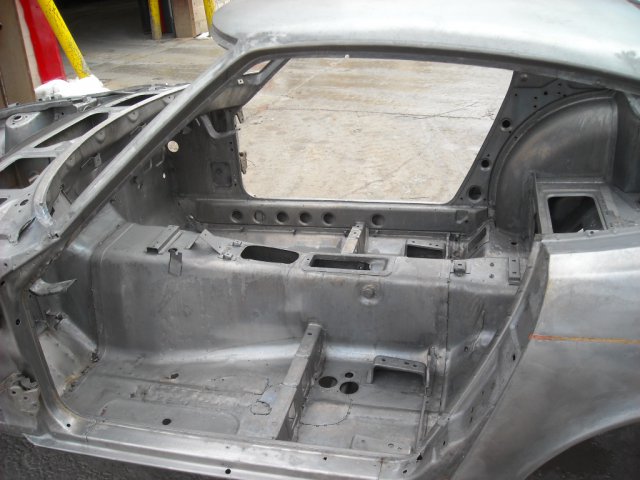

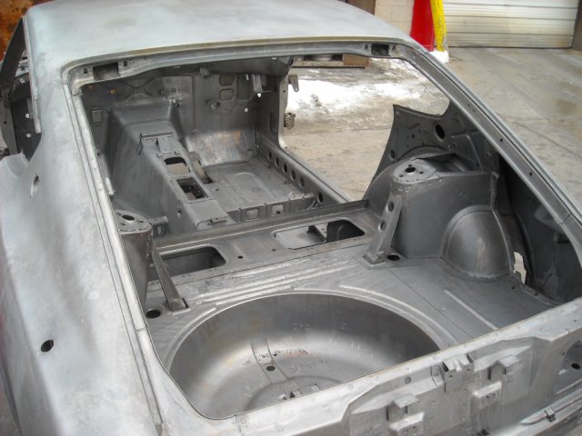

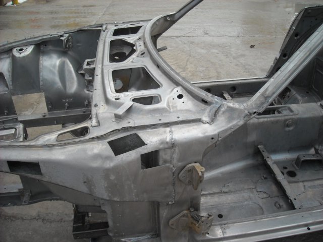

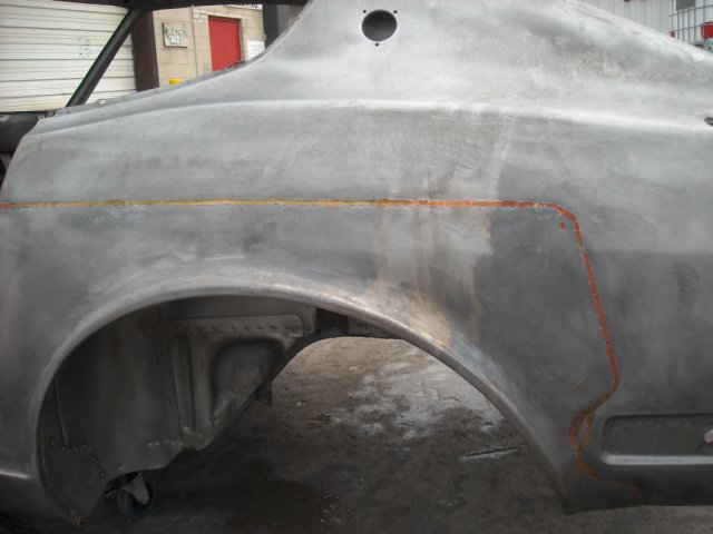

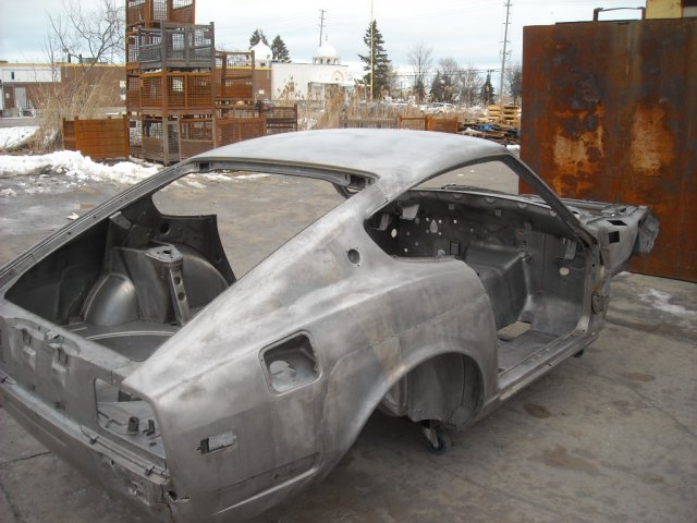

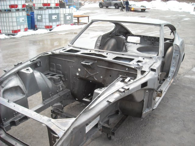

Posted 18 February 2017 - 03:17 AM
Just got the car back from the acid dippers, it's beautiful!
Attached File  DSCN1102.JPG   234.97KB   0 downloadsAttached File  DSCN1103.JPG   229.71KB   0 downloadsAttached File  DSCN1104.JPG   232.74KB   0 downloadsAttached File  DSCN1106.JPG   230.31KB   0 downloadsAttached File  DSCN1108.JPG   229.64KB   0 downloadsAttached File  DSCN1110.JPG   233.9KB   0 downloadsAttached File  DSCN1114.JPG   233.53KB   0 downloadsAttached File  DSCN1186.JPG   234.65KB   0 downloadsAttached File  DSCN1187.JPG   229.99KB   0 downloads

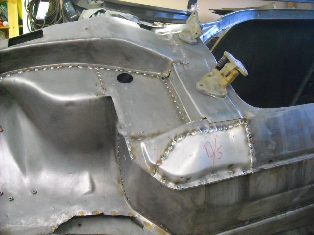

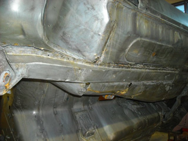

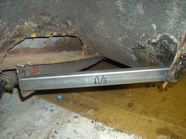

Have started welding in patches, bracing and just started the stitch welding,
Attached File  DSCN1199.JPG   232.46KB   0 downloadsAttached File  DSCN1202.JPG   232.44KB   0 downloadsAttached File  DSCN1203.JPG   227.66KB   0 downloads
This is what I gave them to clean, I'm never going back to sand blasting, the inside of the sub frame is just as clean.
Attached File  DSCN1054.JPG   232.93KB   0 downloadsAttached File  DSCN1053.JPG   233.25KB   0 downloads

Posted 18 February 2017 - 04:04 PM

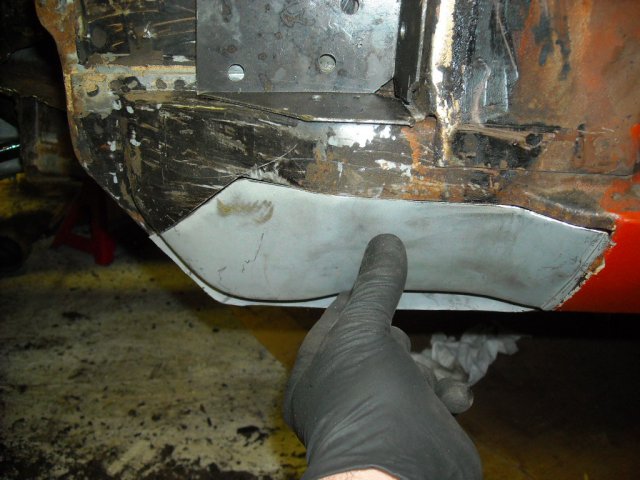

Looks like whoever repaired the rear quarters actually knew what they were doing. I'm genuinely surprised.
Owen | 1976 280Z | 1986 Jetta | 1953 CJ3B
A car is a hole in the air, suspended there by four rubber doughnuts which you can not eat.
Into this hole, you throw money, which you will never see again.
Buy my stuff: CLICK HERE
#60 grannyknot
grannyknot
    Always Here
  • Members
  • PipPipPipPip
  • 239 posts
  • LocationOntario
Posted 19 February 2017 - 03:26 PM
Me too, I imagined there was going to be rivets and wood screws holding it together, I was very pleased.
