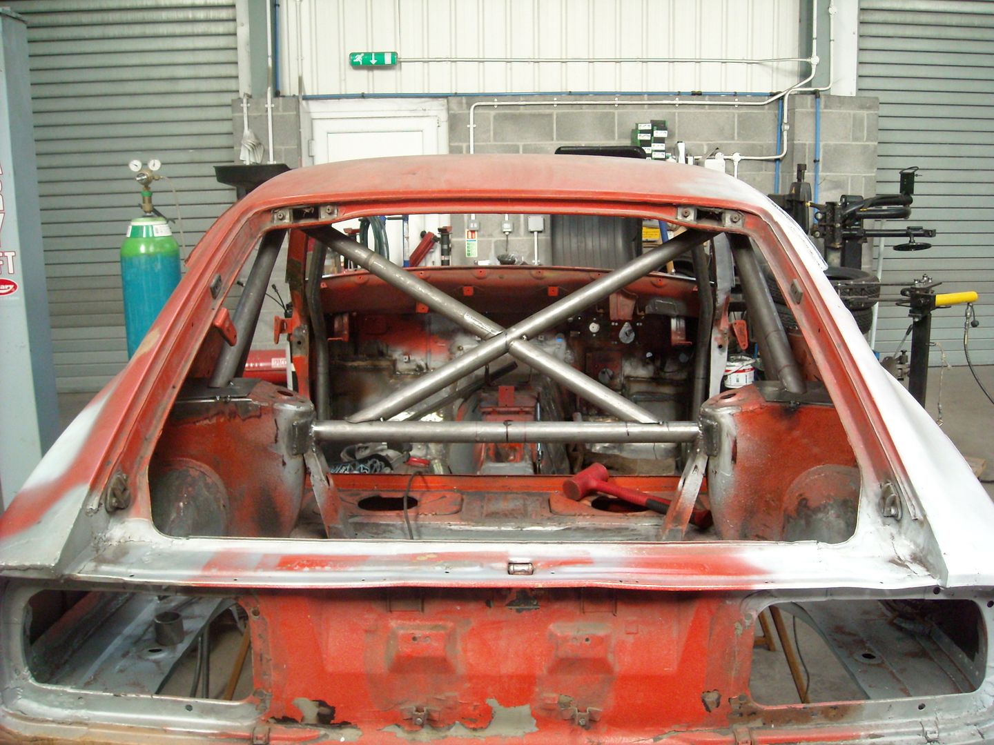

I'm going to be going with a design similar to this.

So is a half cage just the rear? Why not a full cage, weight and cost?

Not cost, but weight and primarily a road and I don't want the hassle of having a cage in the front, plus its not the look I'm going for, trying to keep the style minimal, clean and close to original, a full cage just doesn't fit with the rest of the car.

Bulkhead isn't really strong enough, you need a full to do that effectively, as then you can link the bars from the strut towers up to the rest of the cage.

Lots of years ago 74_5.0L_Z had a drawing in his gallery for the main hoop.  Use it, couldn’t fit better.  Put rear downstays on top of strut towers not on the front vertical surface.  I wouldn’t get fancy with X just simple diagonal in main hoop and as Jon says plus tie into the roof and B pillars.  And weld a bar across between the towers.  If you are tracking you want at least a hoop.  The roof may be relatively stiff but folds easily on impact.  Ask me how I know ....

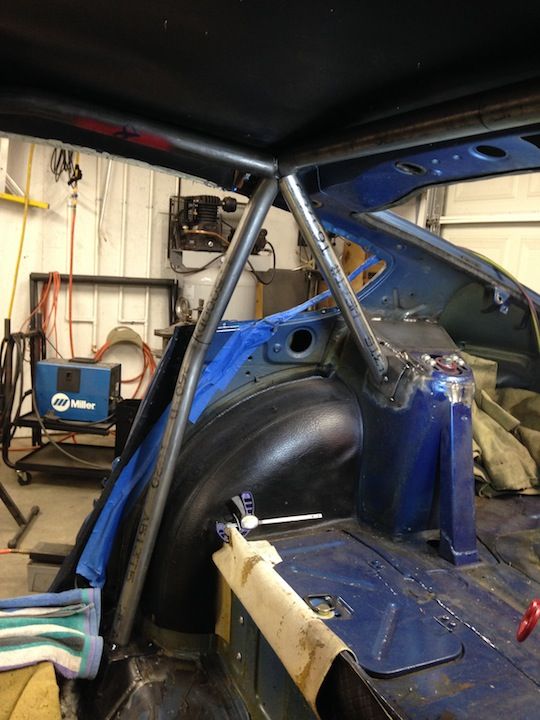

Not sure how much stiffening it is doing unless as Jmortenson says you are welding/gusseting to the car.
From a use standpoint I'd seriously consider the ones that mount on the wheel well for a street Z. Unless you keep it real tight you are going to lose backwards travel in your seats if you push it down towards the floor. I've got about 3 inches or so I can't use because of my little box for the main hoop.
For harness mounting I think the diagonal with the harness bar might be preferable to mounting it at the rear shock tower just from an angle perspective.
With my design that I have in mind I do not believe I will loose any seat travel, at least not any of the adjustment I would need for driving.

The pretty popular harness bar using the safari cage mount points would do the trick pretty well.
Can you post a pic? I was planning on a 4pt roll bar for safety, stiffness, and as a place to mount harnesses, but this is giving me pause.

Hmm I didn't really think of the rear bulkhead area as being a flex point, but I can kind of see that now, the front is really easy to see as a hinge point, I've seen it do its thing with one side rusted out. I've seen some at junkyards folded like a bananna on the side with the battery with how they leave the cars.
The black makes it a bit hard to see, but it is pretty tight to the rear wheel well. The stock seat has a pretty thin frame so it can move back and forwards, but with my recaro knock offs and my sparco R100 the hinge for the seat sits right up against the leg of the roll bar so I can recline it one click even though the seat could probably recline 3 or 4 clicks if the hinge wasn't blocked.
My point about the ones on the rear wheel well was kind of towards that though, I was thinking it won't do much so making sure it doesn't affect seat choice would be preferable. My bar is pretty bad to start with, but now I'm thinking if it can actually be made somewhat useful.
rturbo makes a good point regarding seat belts, the bar definitely covers up the stock mounting point. I've seen brackets that space the seat belt mount back for some cars, alternatively I guess you could weld a mount onto the roll bar? I'm not sure from a safety perspective.
Honestly being a bit on the larger side, being able to buckle in the middle versus down in the corner is not a downfall in my case.

Yeah, I'm looking at your rear bars, it looks like the mount somewhere in the trunk? I'm also looking at where your main hoop mounts. It's hard to see, but it looks like it could go back a little more, is that right? I'm also thinking it could be leaned back a bit. My plan was to put it pretty tight up to the wheel wells, leaving just enough to get the thing welded, and also put vinyl on the wheel wells - maybe an inch or so out. Though, I'd also consider cutting the wheel wells, and running the bar into them. If I do a bar, I'll likely do it to SCCA rules, so I'll have to double check to make sure this is all in line with their rules. My car is going to be primarily a street car, so it's important that the roll bar doesn't get in the way of that.

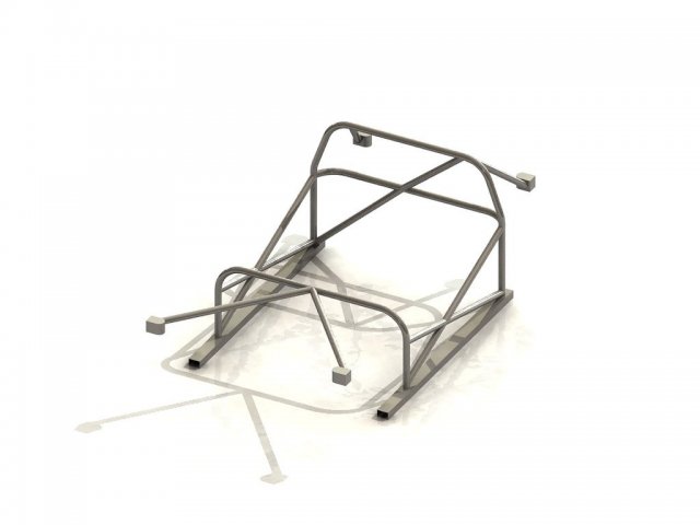

Heres the cage I have in mind (just imagine all the lines are where they should be as I couldn't get it perfect in paint) I plan to have the main hoop uprights part recessed into the well. With this design I reckon I can still run my stock belts. The bars in yellow are optional if they are thought to be needed. I do realise that without a diagonal in the main hoop I am loosing strength but I don't want to sacrifice the room and its not like I am racing in any competitions plus I'm sure even without I'm still going to be much safer than with no cage.

Correct in both cases. But I think the cage above will be solid and still let me run my stock belts. Of course I am not a cage designer so it could be deeply flawed. I guess modern belts mounted to a small floor reel with the upper mount mounted to the cage would work.
Other ideas for fun, tell me what you think.
With no cage what is better, x on its own, bar on its own or both like below or is both not adding much other than weight?

I could be wrong here, but I think the idea is to sort of triangulate from the floor, to the roof, to the rear strut towers.

Yeah, I'm by no means an expert, but I think your thoughts there are about right. Easy for to say since I don't have to pay for the replacement, but I think I'd toss it and get a proper one welded in by a good shop.
