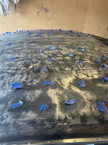

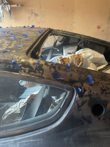

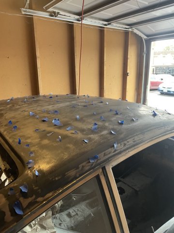

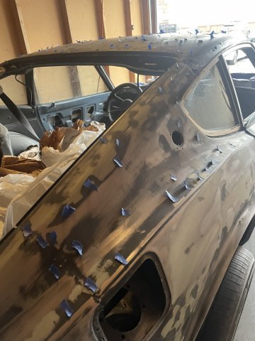

  3. I'm keeping it simple and easy to get done. not going to a mirror finish, just a factory level finish. I build drivers, Sir. I was going to use that dry guide coat until I realized you can't paint over it.....so it is ANOTHER step to get it off then put the mud when you took it off, then smooth it out then another guide coat then block. I just used black primer, mud the deepest bottoms, and use about 4-5 coats of the THICK primer filler made by duplicolor.....specially made for deep scratches. red oxide color. Not advocating any of this it's just experimentation and finding a way that works for me. It will go quick this way. Mud only where needed. when you cover the whole panel, 90% is sanded right off. Using glaze, it sands so easy, I can block it with 220 grit within about a hour and have it ready for filler primer....will it be razor straight? No....but it will look pretty nice.

  8. thanks a lot. I added a bit more hardener and then no problem. I will post pics later, but I put a thin coat of black primer right on the steel and then blocked it this morning. Did the same with the sail panels. It worked great. I then wiped it down with rubbing alcohol and put pieces of blue tape in all the low spots that filler primer won't fill in. I will use glaze with a hardener now. I am well versed with it and it is so easy to work. I just want a decent job, I don't need a show car body. when all is said and done, if the clear doesn't "pop" enough, I will wipe on a coat of glossy Poppy's patina. Poppy's Patina - The Original Patina Clear Coat.

  11. Sorry you had to clean all that gooey mess off. Maybe too cold for the filler to properly cure? Unless you have a heated work space, you might want to wait until the weather warms up a little. Making great progress otherwise! 👍👍
  12. 12-30-2025. The filler i had put on the roof of my 260Z never hardened up.....it just stayed "gooey", so this morning I went to it with a wire wheel attachment in my drill and got it all off. I then went ahead and sprayed some flat black primer on the roof and the sides a bit as well to go ahead and start blocking it out.
