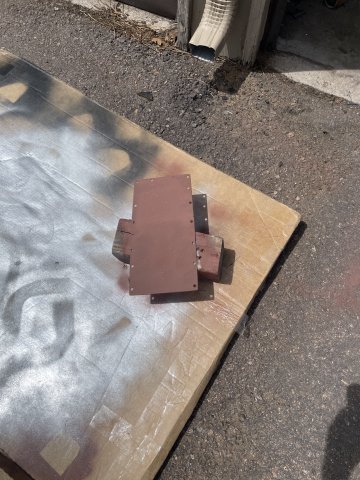

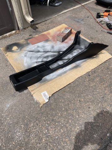

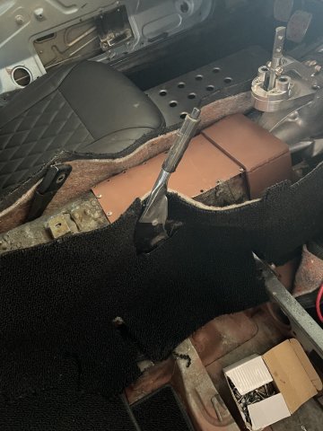

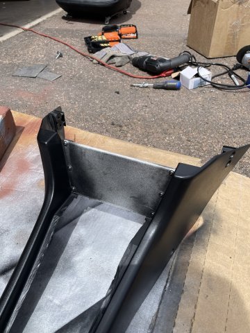

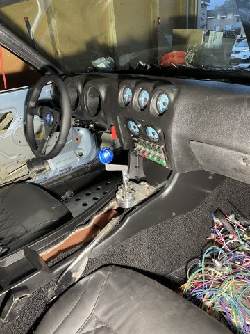

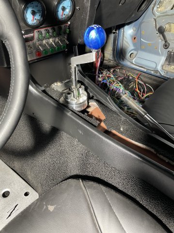

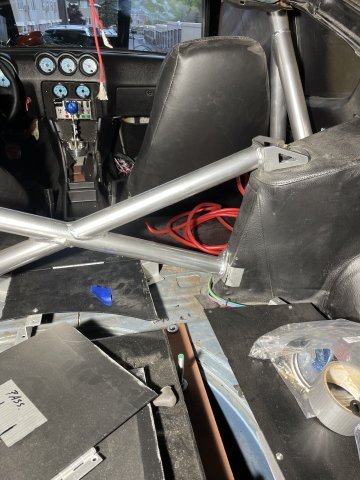

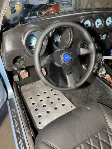

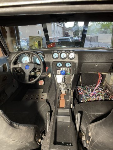

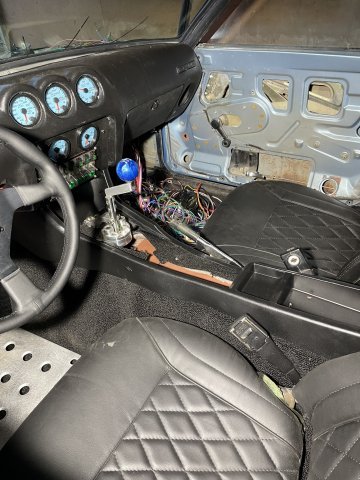

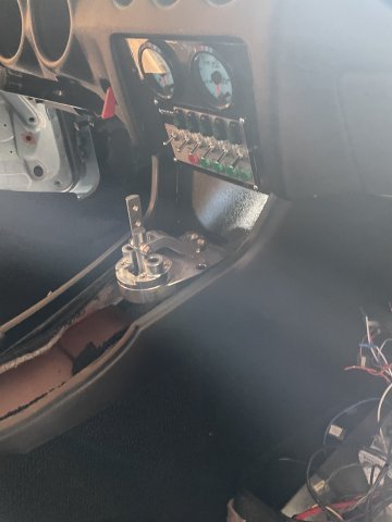

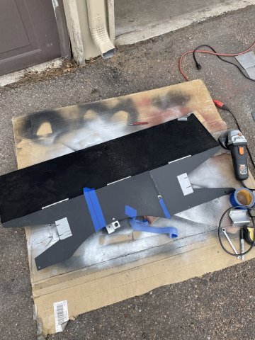

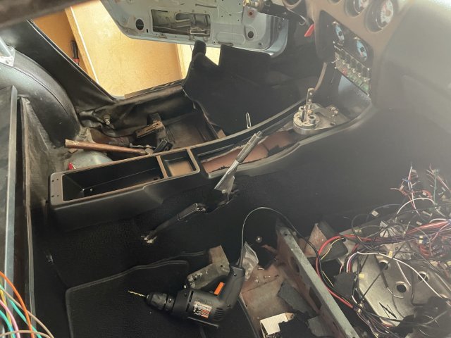

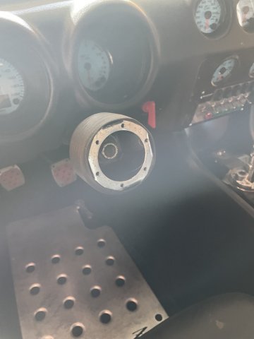

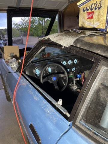

05-03-2026 ATLAS Z UPDATE: I started the day with cutting out of sheet metal a cover to close up the trans tunnel behind the shifter, painting it with rustoleum and installing it with TEK screws. After that I jumped on the center console. I cleaned it up and painted it with SEM Landau Black interior paint and then cut and modified a Skilalrd radio delete plate and drilled holes and mounted it to the console. I painted it in matching glossy black hammertone to match the rest of the dash work in the past and got it on. I then went about screwing with TEK screws and washers some of the carpet down and then screwing the conodal down in the back. I then worked on trimming the carpet kit I got from the company in New Jersey (the name escapes me) . I drilled out and cut the plate for my shifter lever and painted it silver and installed it. It was cool the way I did it, as I was able to hold it where I wanted it to be, mark it then go to work. I then pulled the rear deck panel and marked and cut it for the strut tower brace from Apex International, and also cut the relief section for the wiring to get through. I then cut the section out of the car, and painted it up. I also painted the upholstered areas with the SEM Landau paint, and it came out looking brand new! I ordered the Braille Battery 2105 and battery box kit powder coated black from Skillard and I am awaiting arrival. I will be mounting in behind the passenger seat along with the battery switch later on. I mounted my Momo Steering wheel and that went very easy, I like it. I have a blue horn button and a black one. I decided to try the blue first. I like it as it ties in the blue paint outside and the gauges and the shift knob I got from Speed Dawg Shift Knobs.. I went with the Blue Swirl. I like it. What do you think? Should I use the black horn button? Then I removed the Skillard rear floor, and mounted up the Apex Strut tower bar, and cut the sides of the Skillard floor so that I can cut them to form fit and re-install. I got with Skillard and ordered the extra brackets, and they have always been awesome to deal with. Then the most important part....standing back with a few Coors Banquet beers and taking it all in, and letting my brain brainstorm. Coors Banquet are the very best beers a guy can drink. Things are going pretty well, I think. Cheers!~PICS.

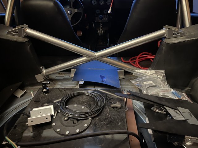

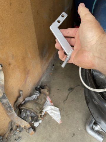

APEX said they would have a set made up by friday but haven't heard from them. Added a photo showing the APEX control arm length issue. Other bushing is lined up and its about 1/2" short. Put the rest of the rear together so i could sit it on the ground with the wheels and tires. T3 r200 short nose kit and rear sway bar. Got my tires in so got them mounted and installed for some motivation. Since I am using 300zx rear drum ebrake. I decided to use a 240sx ebrake handle (since I have this combo in my 240sx). Modified the handle to fit in the stock Z location. Mounted the cable holder thru the floor. Made a couple small brackets to hold the cables in the correct spot. Adjusted and works great. Also added a couple photos of the brake setup. - Last week

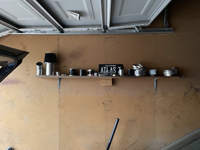

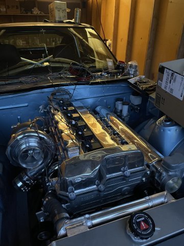

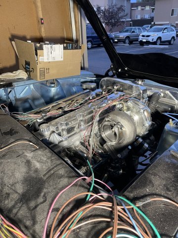

05-01-2026 ATLAS Z UPDATE. Happy May Day! Today I spent some time modifying the intercooler piping to add my new TurboSmart Blow off Valve (BOV). In doing that, I also removed all the piping and added a port on the intake side for a water/methanol jet, and got the intake pipe set up with a 8AN port on the bottom for the PCV setup I am making with twin catch cans, and the 1.5" angled return recirc pipe from the blow off valve I mentioned before. I used a 45 bend and then cut it on an angle and kept adjusting the angle until it was just what I needed. I also got most of my exhaust ready for welding, the bottom portion I am going to do after the top is done.....I need to be able to make the bottom fit just the way I want. All of the intercooler piping will be polished and the entire exhaust will also be polished. 3 inch, mandrel bent stainless with the Evil Energy polished muffler. PICS:
I finally found some hours to start making the wiring not look like a rats nest. Instead of fuses and relays, I am using a small PDM. So that complicated things, I am also using a buss plug for 5v sensors and all ground wires.

04-30-2026 ATLAS Z UPDATE: I changed up my air intake to a 4 inch pipe setup, with 45 degree bends to get around the engine obstructions, and I realized I really needed to add a Blow Off Valve (BOV) for my turbo. I went with the compact Turbosmart unit, which is a 50mm piston with a 1.5" discharge diameter. Today I got the pieces cut, but still need to do some more before taking them for welding and then more than likely go back to getting them polished out. PICS:
