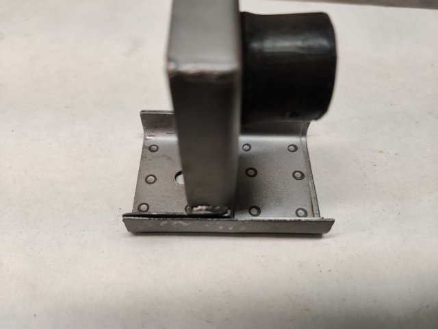

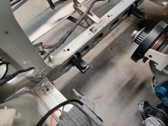

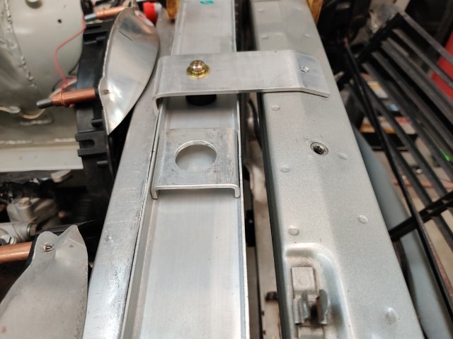

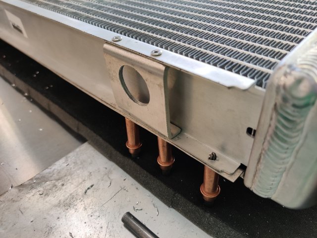

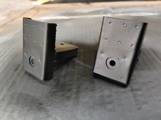

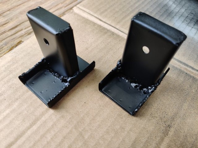

Another weekend of work has gone by, with my efforts spent on mounting the radiator. Time spent thinking of bracket design was more than I would have preferred. However, I did come up with something that will work well. Had I to do it again from scratch, I would use thicker sheet metal. What I have done here instead is fabricate up some brackets using some .032" (.8 mm) sheet. After test fitting them, I found it necessary to double up the part that bolts to the lower box channel of the radiator support. For the lower bolt hole in the bracket, I installed a rivet nut in the frame. For the upper hole (drilled after mounting the brackets using a bolt in the lower hole), I drilled through where the back face of the lower frame is spot welded to the front U section and used 6 mm x 1 mm bolts, washers and nuts. Being two layers thick at that part of the original frame box, it is pretty solid there. The lower brackets will handle the weight of a full radiator as well as g forces from bumps and braking. The rubber cushions support the radiator from the underside. To keep the radiator from shifting forward and back, or left and right, I came up with the idea to attach these brackets with holes that positively locate on the rubber mounts. Even with a lot of care when taking measurements, I ended up with holes needing to be offset toward the front instead of centered. Oh well. With this set of pictures showing the single top mount bracket, you can see a bit better how this design works. The bracket with the hole is 1/8" thick aluminum. That is riveted to the U channel at the top of the radiator. Another bracket which will bolt to the radiator support using an already existing welded in nut (7 mm with 1 mm thread), has a third rubber bumper bolted to it. This bumper positively locates the radiator via the hole in the bracket which is riveted to the radiator. The bumper in this upper bracket sandwiches the radiator (between the two lower bumpers and the upper bumper). I have also made the upper bracket with a rear, downturned flange. I will glue a piece of rubber insulator inside the back lip of this upper bracket. This will prevent the radiator from moving backward, as it might otherwise when the car is at high speed and air is pressing hard against the front of the radiator. I may need to come up with a similar type of flange to add at the bottom of the radiator for the same functionality. My clearances are so tight at between the fans and the front of the engine, that I need to ensure no rearward movement of the radiator can occur.
