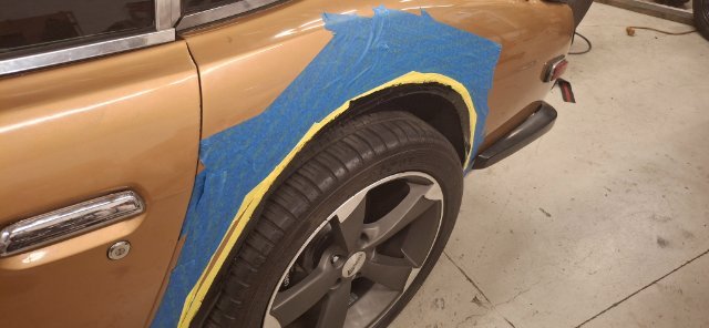

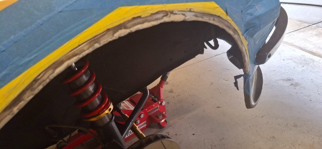

Finally we took some POR15 chassis black and painted the exposed metal. Under the flares it looks almost invisible.
For the front's we bent a length of 3/16 rod and tack welded it in place. This stiffens the fender back to OEM or better. I have seen a cut fender wrinkle before when doing hot laps on a track. Weld and grind smooth.
This is where it gets fun. We cut the rear inner panel slightly longer than the outer panel. This allows the inner fender to be bent and lightly hammered out to match up with the outside panel for welding. Stripped back the paint just far enough were we were certain it would not show around the flare. Then weld um up.

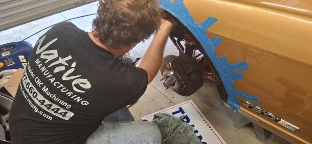

Just went through the process of installing some small carbon fiber ZG's on a 280Z. Goal is squeezing some 18x8 wheels underneath. Probably nothing to learn here, but this is how I do it. First we sized everything up and looked at it. Then looked some more. Then swap them all around and looked more. Then repeat 10 times. Finally we drew a fat line with a Sharpie on tape where the cuts would go.

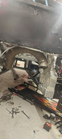

Thanks he's usually around when I'm working on projects but mostly out of frame. Spent a couple weeks recovering from surgury but feeling well enough now to start back in on things. Working through clearancing the rear end for the twin 60mm exhaust tonight I realize I should probably just fully modify everything now versus after the underside gets refinished. I clearanced the t3 r200SN front mount, and while the welds aren't the most aesthetic, I'm fairly impressed as it has full root penetration. Working forward, I had previously clearanced the rear crossmember but I think I want to fully plate it out and weld in some structural reinforcement.

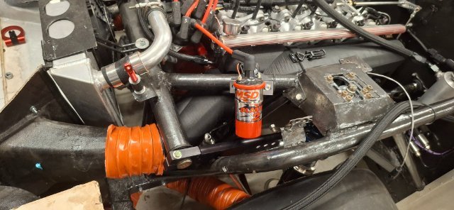

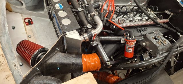

Well while the z was in the back garage I pulled the exhaust off . I had tried something that I won’t do again but I used a square port gasket ( Nissan ) on my mn47 head with my square port header . I was getting some small leaks when I pressurized the exhaust during leak checks . I went back with the gasket to match the head which worked fine before . Also stared at the ITBS for a long time trying to figure out why #3 was sucking more air . As you can see in the pics the linkage was digging into the side of the ITB . Shining a light into the ports before hand did seem to show 3 open a hair more . It was such a small difference I can’t swear I did anything , but I’m betting it’s enough . I ended up just filing the tab on the linkage down . I also figured a way to run my coolant bypass on #6 . I’ll run it under my ITBS on top of the heat shield . Might also try again to run air for a remote IAC . It’s actually getting too busy under the ITBS . Also on the to do list is to find some different cooling fans . I want to run brushless for the versatility and power since I want to install AC . AC is ordered from AC solutions but that’s a month out at least . Cold air box got glued tonight . 75mm Stacks are getting printed out and I’m getting close to finalizing this long project !
