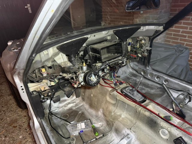

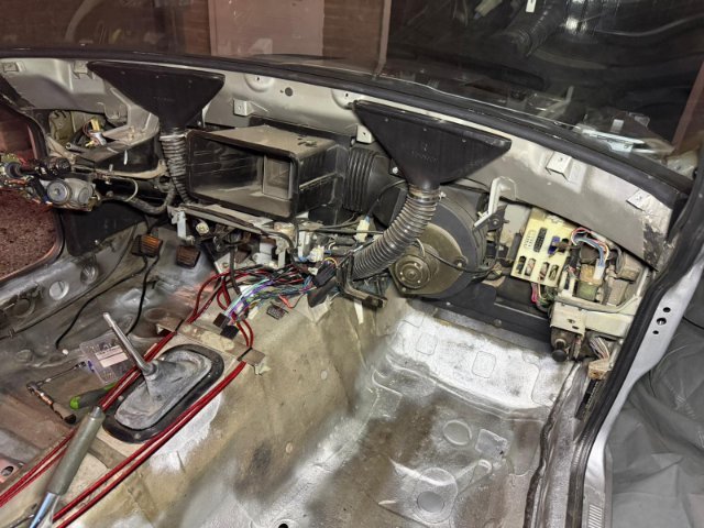

Yesterday after work I decided to just try and remove the dashboard and see what happens. Worst case scenario I have to put the dashboard back in place with a few bolts till she’s back from the body shop. But fortunately I didn’t have to! From what I could understand from the wiring schematics and pictures online the dash shouldn’t have any components or connections preventing the stock EFI from starting and running the engine. The dash just receives signals from the sensors but doesn’t send them. The only wiring connected to the dashboard where three connectors connected to the white panel in the passenger footwell. I disconnected these took out the dashboard and tried to start the engine. She had some trouble as the engine was cold and hasn’t started in a few weeks but after a few seconds she came to live and ran perfectly. - Yesterday

As the title implies I want to find out if a stock 280z with the L28E (fuel injected) can start and run without the dashboard. My 1977 280z will be dropped of at the body shop next week for new Apex Engineered frame rails and front fender braces. The body shop would like to have the car running so it’s easier to move around the shop. In the meantime I would like to restore my dashboard and replaced a few tings like the bulbs and the speedometer. But for that I need to know if I can remove the dashboard and still be able to start the car. Does anybody know if the 280z can be started without a dashboard?
