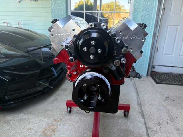

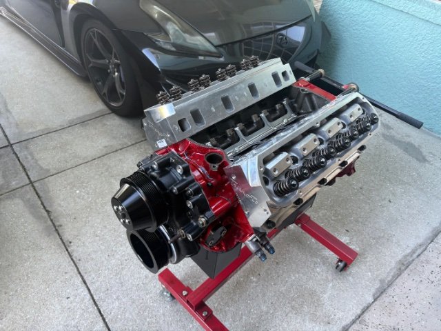

Thanks for the reminder, I had not. That’s a couple things you’ve caught, I really appreciate it as I’m doing a lot of these things for the first time. I owe you a few beers if we ever meet up. Took the lower bolts out one at a time, cleaned and torqued back with plenty of thread sealant. Got the second head on today too. -

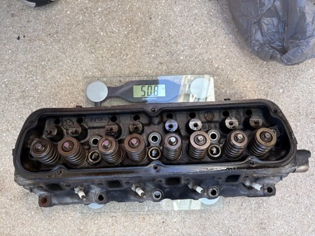

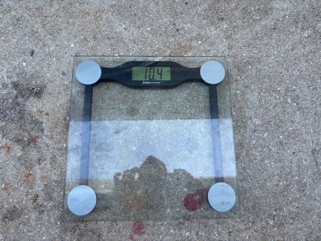

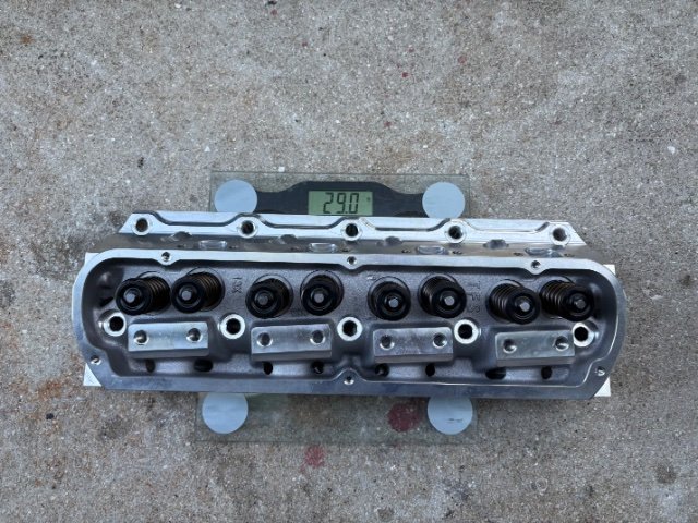

Got around to weighing the door and the heads. Old heads were 50.8lbs new ones are 29lbs. The carbon fiber (shell) is 10.4lbs, looks like big weight savings. - Today

Don't forget to use sealant on the short head bolts / studs. They go into the water jackets of the stock block. -

Trickflows are a great choice. I have a turbo 351 so not a direct comparison but when I switched from GT40s to 11r 190s it made a massive difference. Unrelated to the engine. I weighed my stock 280z door today. Its gutted so I can paint them. so no glass, regulator, handle, lock, hardware, window frame ext. just a empty door shell. 34lbs. -
Axles finally came in. Didn’t have much time this weekend, but cleaned the top of the motor and bolt holes and got one head installed. -
