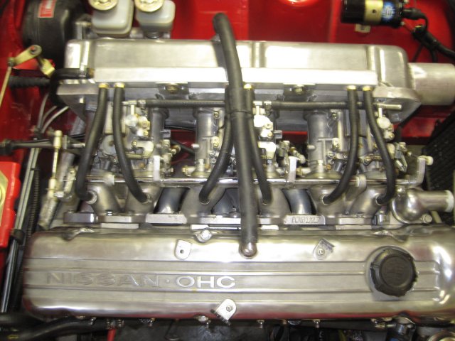

Okay, I'm still having the dead spot. What I have done is: Removed carbs and checked and cleaned accelerator circuit-all carbs are firing a steady pee stream with the slightest of throttle movement.(pumps set on middle hole) Blew air and carb cleaner thru the pilot circuit and I can feel air coming out of all pilot holes-idle and progressive holes. Installed 60's pilot air jets-seemed to best around 2.5 turns to 3 Sprayed carb cleaner around while running-no significant change All O-rings were in good shape between carbs and intake Removed ALL sources of extra vacuum-brake booster and PCV and removed vacuum log-plugged intake Can get a very smooth idle-even down around 800rpm. Engine will rev-up nicely, but still will die doing a very small, steady opening of the throttle. I even threw the 57.5's back in, no real change. I pulled the plugs after all this horsing around and some did show rich. It was kind of odd-1.3.6 were cleaner then the other 3?? My wideband is a bit sketchy right now, I think I need a new sensor. Most of the times I had the best idle it was showing lean. IT was a challenge to get it below 14 and then it seemed to load up trying to get it any richer. By then I had 3 turns out on the pilot. So if I had a vacuum leak somewhere, would I still be able to get such a smooth idle? I have searched at many set-ups and you rarely see over 57.5 on the pilots, so why would mine be the exception. Would bumping up to a 62 make that much of a difference? Tony, recurving the dizzy would be required to get past this point?

You mean the pilot jets? The first post I said 57.5. It might be the case that they are the wrong size, but I need to get other things squared up first. I am going to replace the intake gasket to assure no vacuum leaks. I did take the carbs off today and watched the accelerator pumps in action- and there wasn't any on one port. Another nozzle was spraying weak, so this was obviously effecting transition. My floats were also rich, but not sure if that was hurting me at this point.

I talked to Todd at Wolfcreek. Todd was emphatic about getting the accelerator pumps working properly. He says that due to the age of these carbs and if they have been sitting, it may take some time to get the pumps fully primed. He said to make sure I get a visual confirmation on this. Tony, I had a hard time buying the acclerator pump because I was increasing the throttle so slowly that I thought they wouldn't be a factor-but I guesws I might be wrong. Maybe that's old Holley carb mentality!! Secondly, I might have skimped where I shouldn't and installed the carbs on a used intake gasket. The gasket wasn't very old, but it did have SU's mounted to it earlier. So I could have a vacuum leak that is only showing up slightly above idle, which in turn is leaning my primary too much. I shot propane around the gasket at idle-no changes. The car once warmed up idles great. Thirdly, he didn't approve of my float adjustment method. He told me to hang the float on the seat and measure. The manual also shows measuring the fuel level in the bowl, but Todd said forget that. Todd said once I check all these items, then and only then do I increase jet sizes. From all my searching, the jets in the carbs now should be good enough for my set up. I will also give a SHOUT OUT to Todd for his patience. He comes off gruff-especially if you call him unprepared to answer specific questions, but in the end he was a good guy and realy wanted to help out. I have also ordered from him before and he was fast and accurate with his stuff.
Do your plugs look normal-do they have any color? Does the engine sound flat like it's running out of gas? Adjusted nozzles to hit lean and rich walls???? This sounds beyond a nozzle adjustment. I've got an adjustable sprocket on my L24 and minor degree changes didn't exibit the symptoms you see. I've played with as much as 6-9 degrees and the changes were noticable, but they were small. It almost sounds like your floats are lean. That would make it flat, but it would still rev out-just no power. You could try tweeking them to high side and see what that does. If you were off a tooth on the cam, that would be a different story. Sure you counted the links exact from sprocket to sprocket? You said the cam was installed straight up-did you degree the cam in or just set it on the first hole. My schnedier installed on the first hole showed up retarted on the degree wheel. Variances in the rocker arms will show up on the wheel. And of course-valve adjustment is crucial. Igniton timing looks good for power. Running proper impedence coil for the pertronix? Alternator putting out a strong 14 volts for your ignition?
Leon, I don't think the numbers correspond . Those jets are exactly what Mikuni installed as a bolt on upgrade. Todd at wolfcreek said the numbers are close. The AFRs were 14+ at idle, not sure before it stalls.
L24 -stage 2 cam, headers, electronic ignition. Car ran great before installing Mikuni's Mikuni's look new inside and out-40phh 180 main air 140 main jet 57.5 pilot Not sure on the pump nozzle Float levels checked-seemed low, but after talking to Todd at Wolfcreek I might need to back in and check them Dialed in for best idle is about 2.5 turns out on the pilots Electric pump running 3.5 to 4psi Car idles smoothly and engine will rev up pretty freely. But, when I very slowly increase the throttle off idle, it will increase rpm until about 2000 rpm then die, and I mean die. It seems revving up the engine the accelerator pump will bypass this dead spot, but I would need to rev up the motor constantly. As it is, it is undrivable. Wideband showed around 14afr at idle, but plugs were pretty sooty after an attempted drive-probably because i had to constantly rev it up. Todd asked me to make sure the accelerator pumps were actually working-visually, and as best as I can see and hear, the pumps are working. He felt it could be a transition issue. I thought maybe the primary jets might be small, but honestly I am guessing a bit with these carbs.
