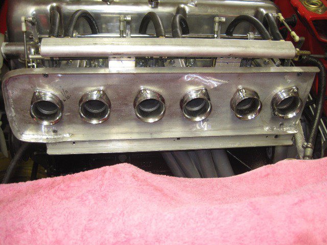

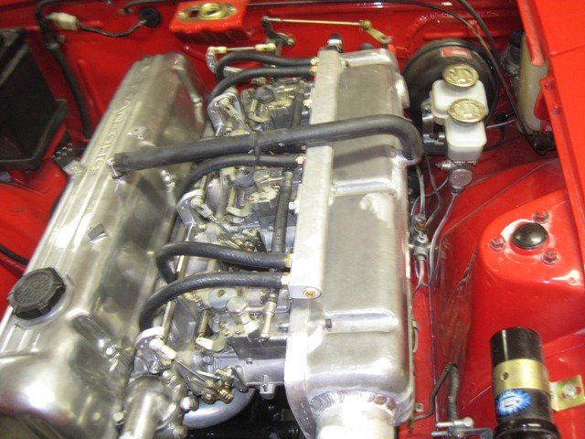

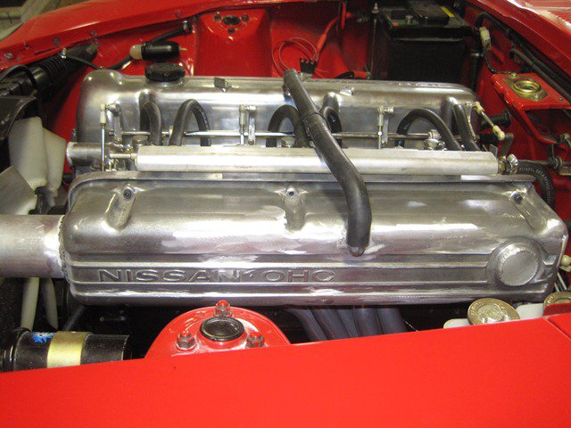

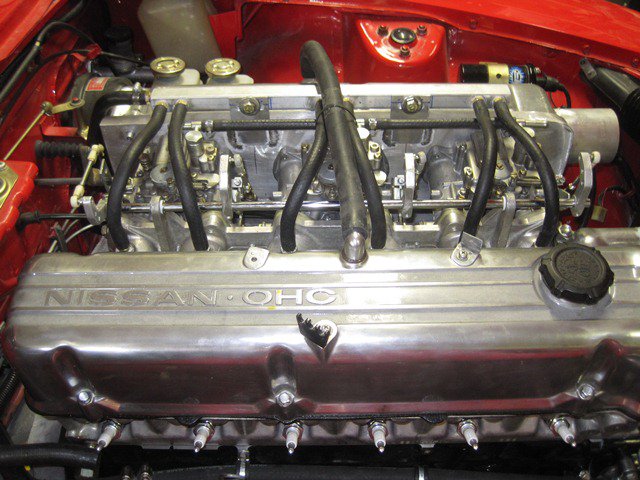

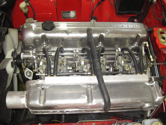

  1. TMW induction-now Borla induction 400$ for the air box Look at the cover closely, you will see that it is altered and notice the the Nissan lettering and their orientation.
  2. Jon, that has crossed my mind. The valve cover does lighten up quite a bit once you gut it completely. I was considering struting from the engine mounts to my backing plate.
  3. Sorry for the big pics, I thought I reduced them enough. Moderators-what is the ideal size pic for these forums?
  4. I really wanted a CAI for my Mikuni's, but the choices are slim or costly. I like improvising and was trying to come up with a CAI that I wouldn't have to fabricate from scratch. Looking at the valve cover I realized that the size was right for an airbox, and as far as cosmetics, I think it fits. Some might think its hokey, but I like it and it should work well enough. I still have a lot of clean up and polishing to do, but it has been one of those enjoyable projects. I just need to get my 3" piping to finish my mock up. I should be able to come off with some 45 elbows to get the pipe out in front of the radiator. The most expensive part of this project was paying a welder. I don't have the means to weld aluminum, or this project would have been next to nothing as far as costs. Between paying the welder and piping I will have 250$+ in this. The TMW box is 400$ plus then you would also be buying your piping.
