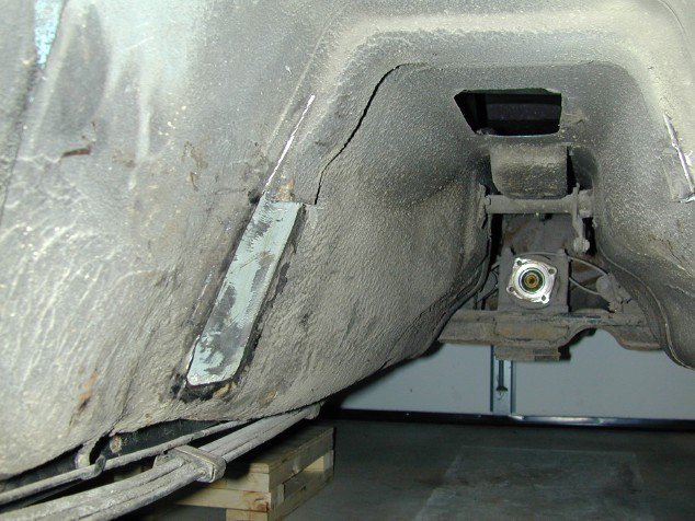

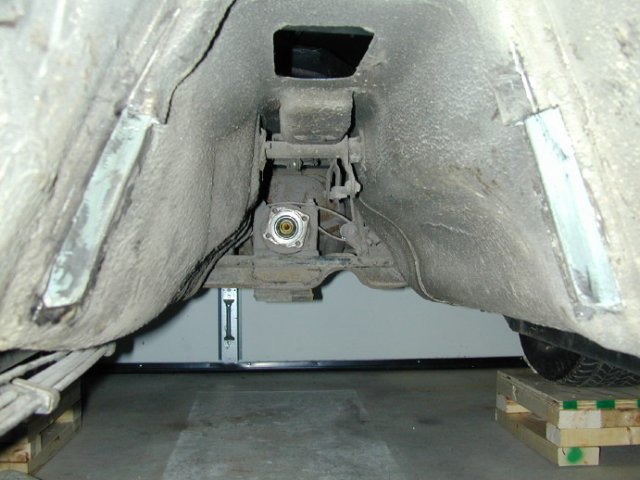

The 280Z is stiffer and heavier that the 240Z , To feel safe and have a piece of mind I went ahead and added the Baddog frame rails and used 1/8th inch plate to tie the frame rails to the front frame and firewall for extra strength, front an rear strut tower braces and a heavy duty transmission mount spanning the frame rails. currently running a mild LT1 but will end up with a stroker LT1 eventually, The car is a lot stiffer than it was originally and I don't baby it when I drive it and haven't experienced the body flex I used to feel. I am thinking of eventually tying in the rear part of the floor frame rails with the rear unibody frame as done by some other members to complete front to rear frame. Just my 2 cents Greg

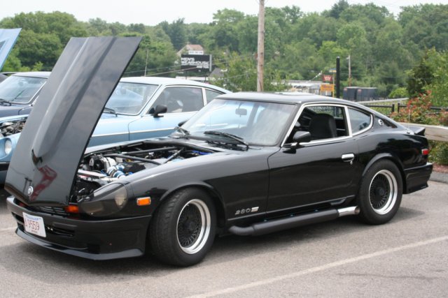

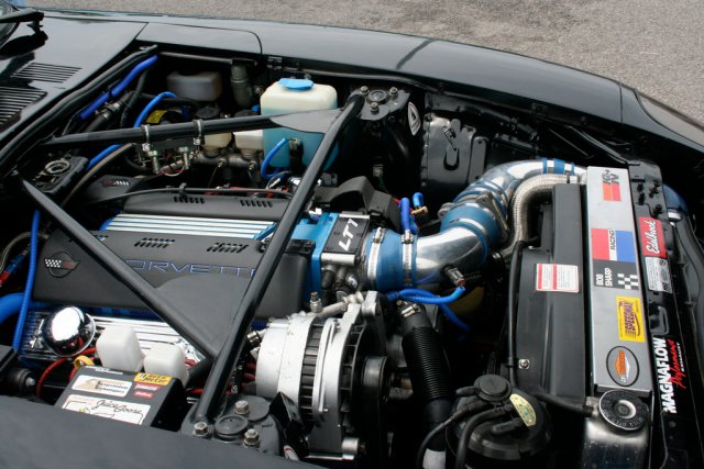

Latest pic of the LT1, re-did the pulleys and used the power steering delete pulley and an AC delete mount with a smaller pulley, uses standard length belt now and no more shredding of belts! YEAH!
On my side pipe install I did not notch the dog legs, Using the Sanderson block huggers I was able to route the exhaust at the high point of the dog leg frame near the Tension rod nuts and washer, I welded a plate to protect the tension rod bushings from the exhaust heat and then cut holes in the fenders at the rocker panel height. My exhaust has no clearance issues as is not the lowest point of my car. For pipes running underneath and exiting just before the rear wheels you will have clearance issues as it will hang below the frame rails. If you run along the floor pan it will still hang lower if you have to cross the frame rails if you run the pipes down the tunnel. I looked into using square/ rectangular tubing but still thought it would hang too low or heat up the floor too much. Greg
If you are making your own sidepipes you can also buy chrome heatshields, I don't need them but they are available on Summit, I remember they were about $80 for 2 3ft shields. I ran 40" 3" glasspaks and I don't touch the pipes getting in or out. I have them real close to the rocker panels and came through the fender to take care of the too low pipe at the frame dogleg.
