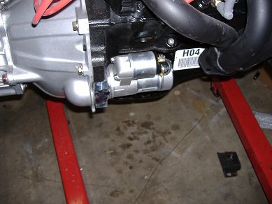

SBC 350 starters tend to get heat soaked and then not work until they cool down. When heat soaked they just click or turn over slowly. So, does your starter work ok when cold and only click when hot? I solved this problem by replacing the stock starter with a gear reduction starter. My SBC engine always starts no matter how hot the engine bay is. Do a search for gear reduction starters such as Hitachi PSL 100 etc.
