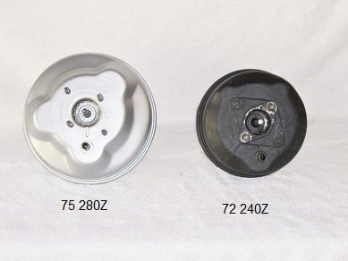

Yes the one inch brake master cylinder will require more force when paired up with the 240Z booster. The pedal will feel stiffer and require more effort to stop as compared to stock brakes. The fix is to go to a larger diameter brake booster such as the 280Z or, if you have space for it, the 280ZX booster. The location of clutch master cylinder limits the room available to mount the 280Z or 280ZX booster on the S30 cars. I just finished installing 1 inch wilwood master cylinder and 280Z booster. Pedal feel/effort is good like you would expect power brakes to be. Car hauls down fast with minimum effort. Do a search as the 1 inch Wilwood master cylinder/booster issue has been covered in the brake section. Several members have posted "how to" threads on upgrading S30 cars with larger boosters. I recall some threads dealing with booster diameter. See pictures of Wilwood master cylinder and 280Z booster install on a 72 240Z.
Great write up. I just finished doing the Wilwood 1 inch brake master cylinder swap as a result of the non-availability of the 70-81 280ZX brake master cylinder. Note: Outlet fittings from a 79 - 81 280ZX master cylinder will also work. Larger Booster: With limited space between the 240Z throttle bracket and my 7/8 Tilton clutch master cylinder I had to use a 75 280Z booster. I had to re-drill the firewall to match the 280Z booster bolt pattern and dimple the booster slightly where it touched the Tilton 7/8 clutch master cylinder. The tight space problem might not be an issue if the stock 240Z clutch master cylinder is still in place. Note: If I had used a Wilwood 7/8 clutch MC instead of the Tilton 7/8 clutch MC there would have been more space to fit the larger 280Z 2+2 10 inch booster. See kj280z post below. The Wilwood MC has a smaller footprint on the firewall. Overall, the Wilwood 1 inch master cylinder and 280Z booster performs much better than 280zx master cylinder/240Z booster combination that I was using with my Modern Motorsports vented front and 240SX rear disk set up. Pedal is firm, but not hard to push using the 280Z booster.

Wilwood p/n: 260 -8794 Available at Summit WIL-260-8794 The 280ZX master cylinder is now extinct. Here is what other HybridZ members have done: I just completed the Wilwood master cylinder and 280Z booster swap. Works well with my Modern Motorsports Toyota vented front and 240SX rear disk brake set up. Much better than my old stock 240Z booster and 280ZX master cylinder. The mounting holes in the Wilwood mounting flange have to be filed to match the slightly wider Datsun bolt pattern. I used a dremmel with a rotary file to open the top and bottom holes. No need to make or buy new brake pipes or adaptor fittings. The Wilwood master cylinder outlet ports are 3/8 - 24. To mate the Datsun 10mm x 1.0 brake fittings to the Wilwood MC all you have to do is swap out the outlet fittings on the Wilwood MC with outlet fittings from your Z master cylinder. The fittings are the outlet ports that thread into the MC body. The Wilwood and Z outlet fittings are identical except that one is 3/8 - 24 and the other is 10mm x 1.0. The Wilwood rear outlet port marked R has a residual pressure valve intended for rear drum brakes. If you have rear disk brakes you don't want that residual valve (looks like a rubber plug with a spring under it). Just lift the cone shaped part out of the rear oulet and remove the rubber plug and spring and replace the cone shaped part. Then screw in the fitting from your Z. The front outlet does not have the residual valve. I confirmed removal of the residual valve with a Wilwood engineer. I used a 75 280Z booster because I knew that the clevis pin matched the 72 240Z clevis pin. So no mods there. The bolt patterns are different so you need to make a templet of the 280Z bolt pattern and drill new holes in the fire wall. The booster was a tight fit btween the throttle bracket and the 7/8 Tilton clutch MC I am using. I had to dimple the outer edge of the booster about a 1/4 inch where it touches theTilton 7/8 clutch MC. The booster would fit easily if a stock 240Z clutch MC were in place. BTW the first Wilwood MC I bought leaked internally. It happens. -
Turned out that the 280ZX MC that I had rebuilt at Cardone was still leaking. So I installed a Wilwood one inch MC and it too would not hold pressure. I couldn't return the Wilwood because I had to modify the mounting holes in the flange to fit the Datsun bolt pattern on the booster. I bought another Wilwood one inch MC and installed it. I now have a high firm pedal. In addition to the Wilwood MC, I installed a 75 280Z booster which works well with the Wilwood MC and Modern Motorsports (MM) Toyota vented front and 240SX rear disk kits I have had on my car for two years. The combination of the one inch Wilwood MC and the 280Z booster much improves the MM brake kits performance. Pads are Porterfield R4S. The Wilwood one inch MC is a good replacement for the now extinct 280ZX MC. I plan on posting details on the Wilwood MC and 280Z booster install.
