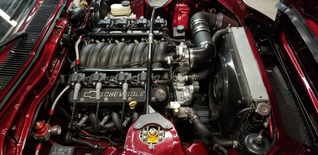

my opinion is going to say no. LS6 intakes are the best way to go. $100 more but you might save that money down the road by having less hassle. here is the pic of mine, i dont see having room for the trailblazer one but thats with my setup.
